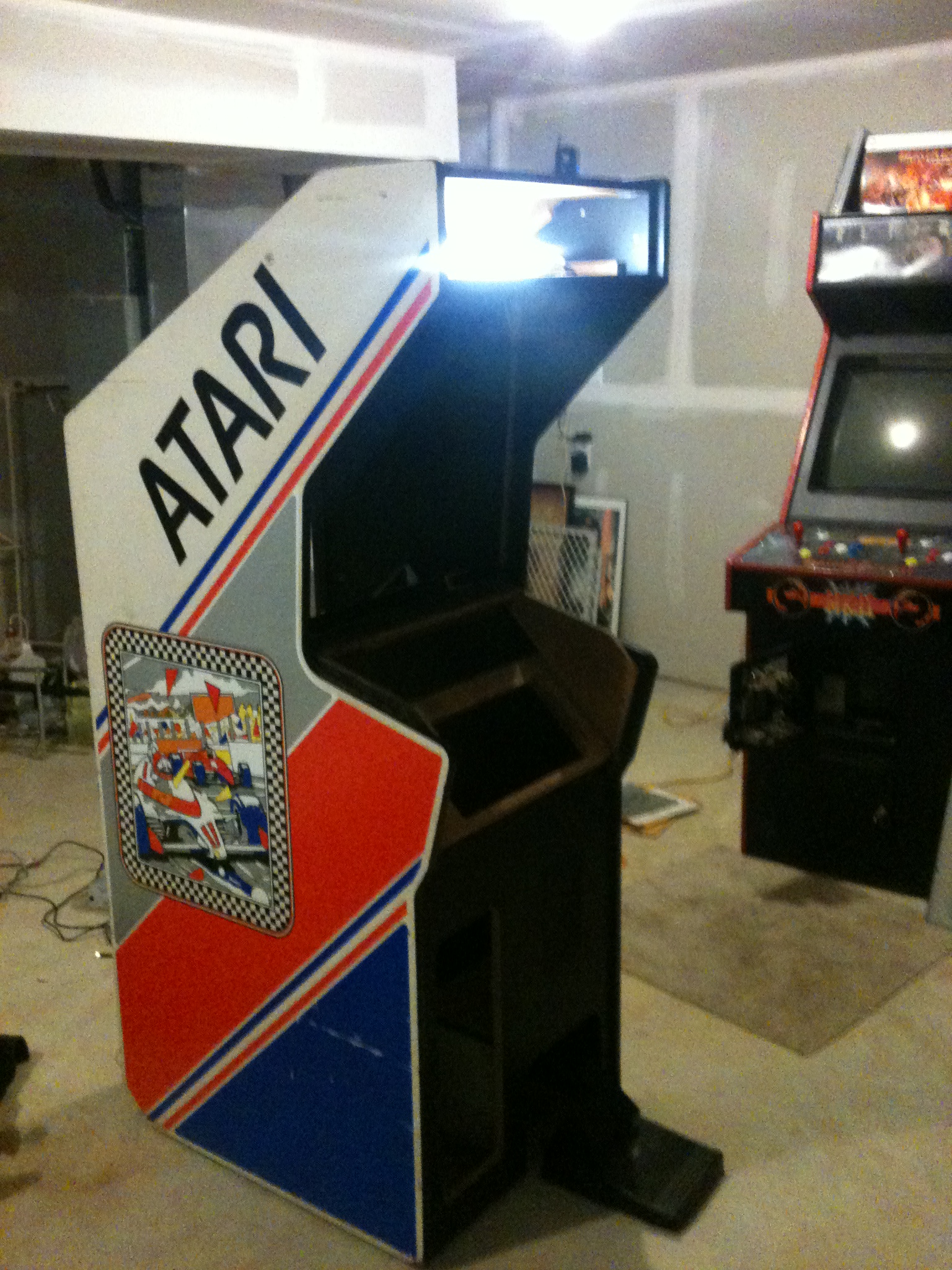

Ok, so I started off with 3 Pole Position cabs, 1 fell off the truck, down to 2.
The cab in the best shape got scrubbed down and cleaned out, cleaned up all the wiring and dirt; its waiting for Haruman to figure out if the PP2 board is any good and how to run power without the ---smurfy--- AR2. On to the last PP cab. It had NO wiring in it, no pedals, a monitor with a busted neck board, cracked yoke, busted chassis, No speakers, basically the wood and a broken monitor. I mean even the wheel lacked the encoder board.
Here are the AFTER shots. The before shots are in the "restorations" section under "pole position triplets"

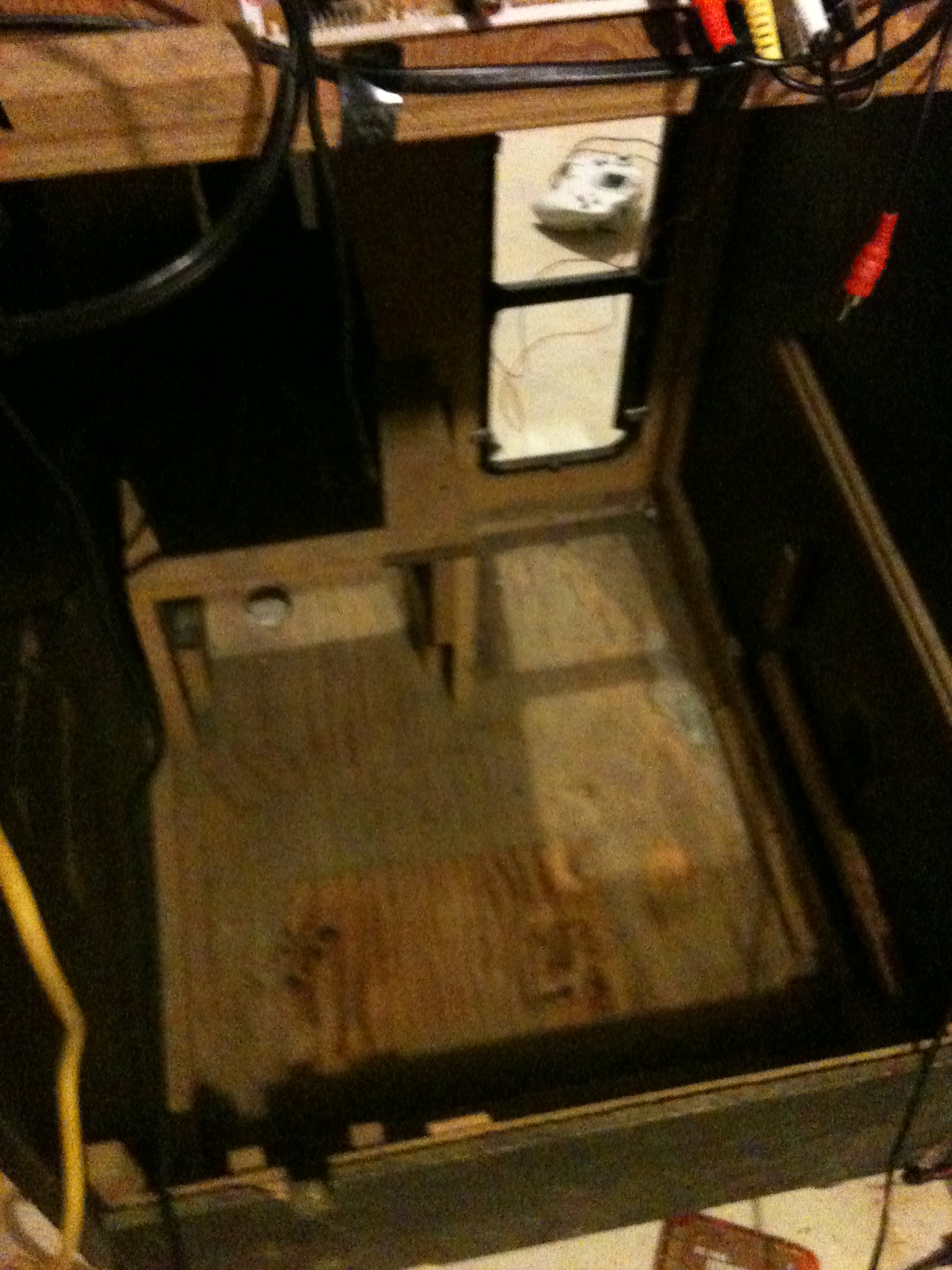

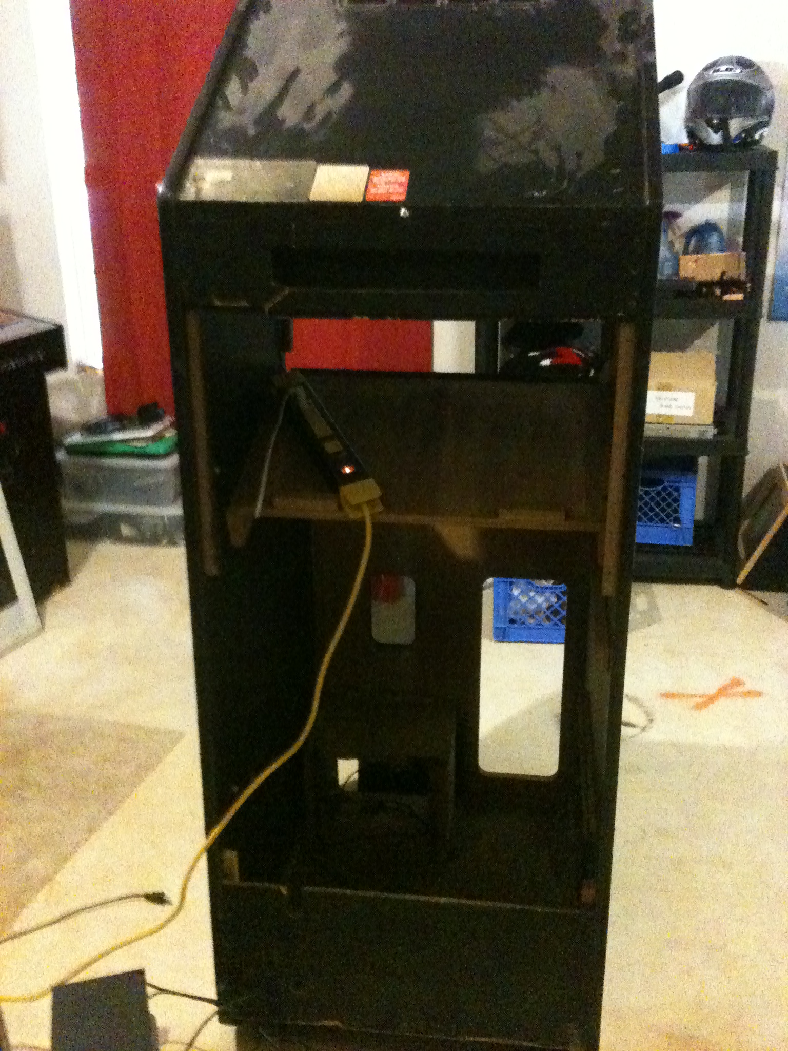

I started by removing the old monitor, and cleaning everything. This is probably the worst smelling cabinet Ive even owned. I wiped out the bottom with bleach water, and ended up slopping primer all over the inside to cover the smell. You cant really see it, but when I post up pix, I know someone is gonna ask "why is it white in the bottom?"
I also removed the stuff from the marquee area and put a regular florescent fixture up there.
above: the bottom before I painted it. It smells like Xouchie punched it 3 weeks ago.

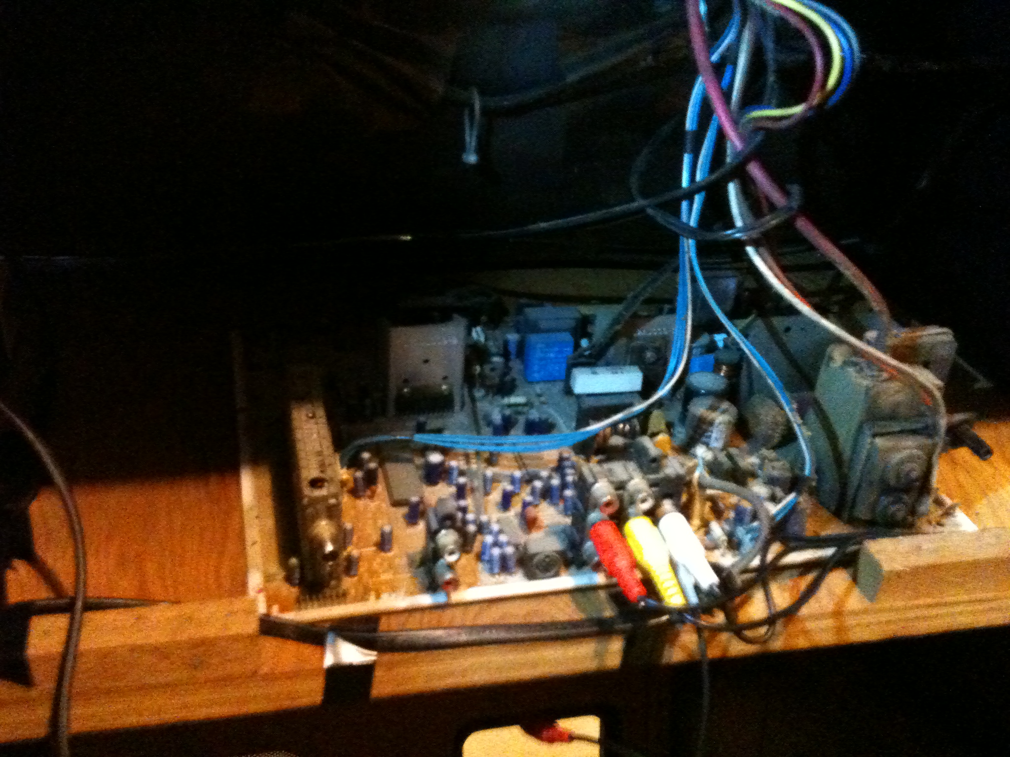

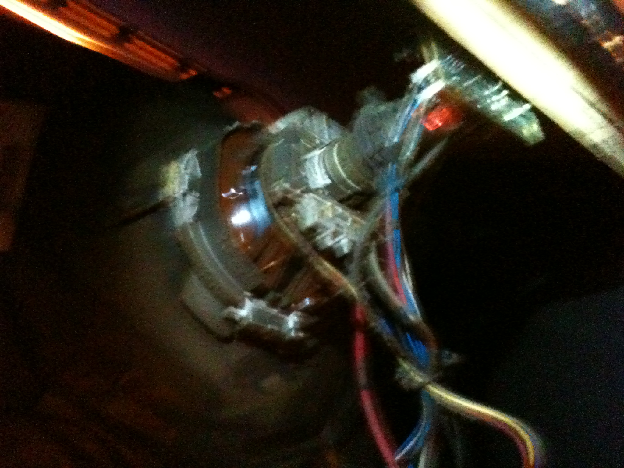

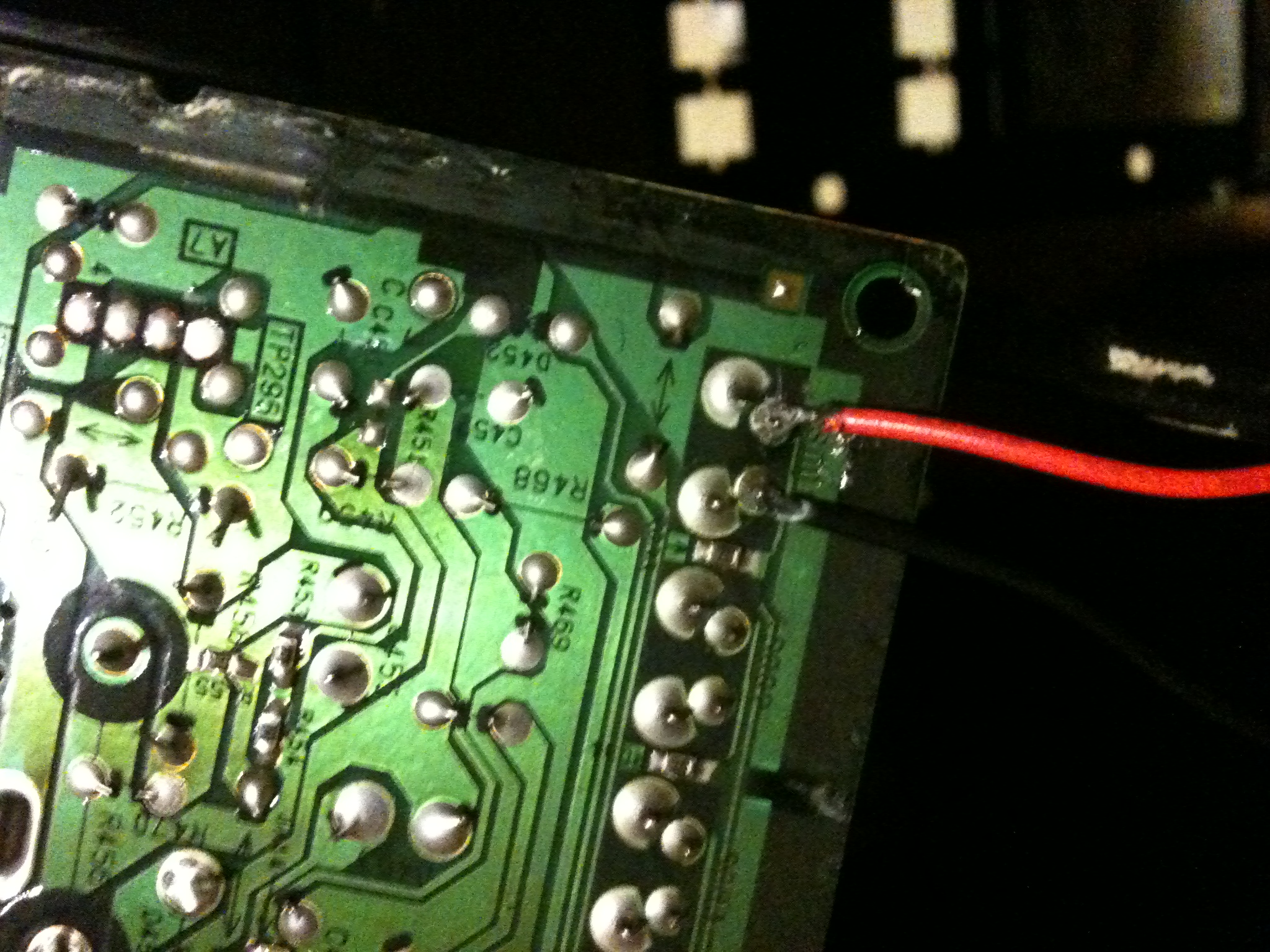

The Monitor is a de-cased 27" TV. Yeah, I squeezed a 27" monitor into a pole position! I rank this up there with a 32" monitor in a KI2 cab ;) To make it fit I had to pull the 2 little strips of wood off of the front of the monitor area, and use a hacksaw to cut the metal tabs off of the corners. Not all the tab just half of it, so I had something to brace to the insides of the cab. The TV has component input as well, and I plan to use it if not it also has S-video. I soldered to wires from the chassis to arcade push buttons. 1 for power, 1 for input; just in case I put a dreamcast in there or something.
above: the inputs. I used a regular composite (V/L/R) wire for the component connection, I'll eventually buy the right wire....maybe.
above: there isnt much clearance for the neck tube for a 27" CRT inside a Pole Position
above: the power/input soldering

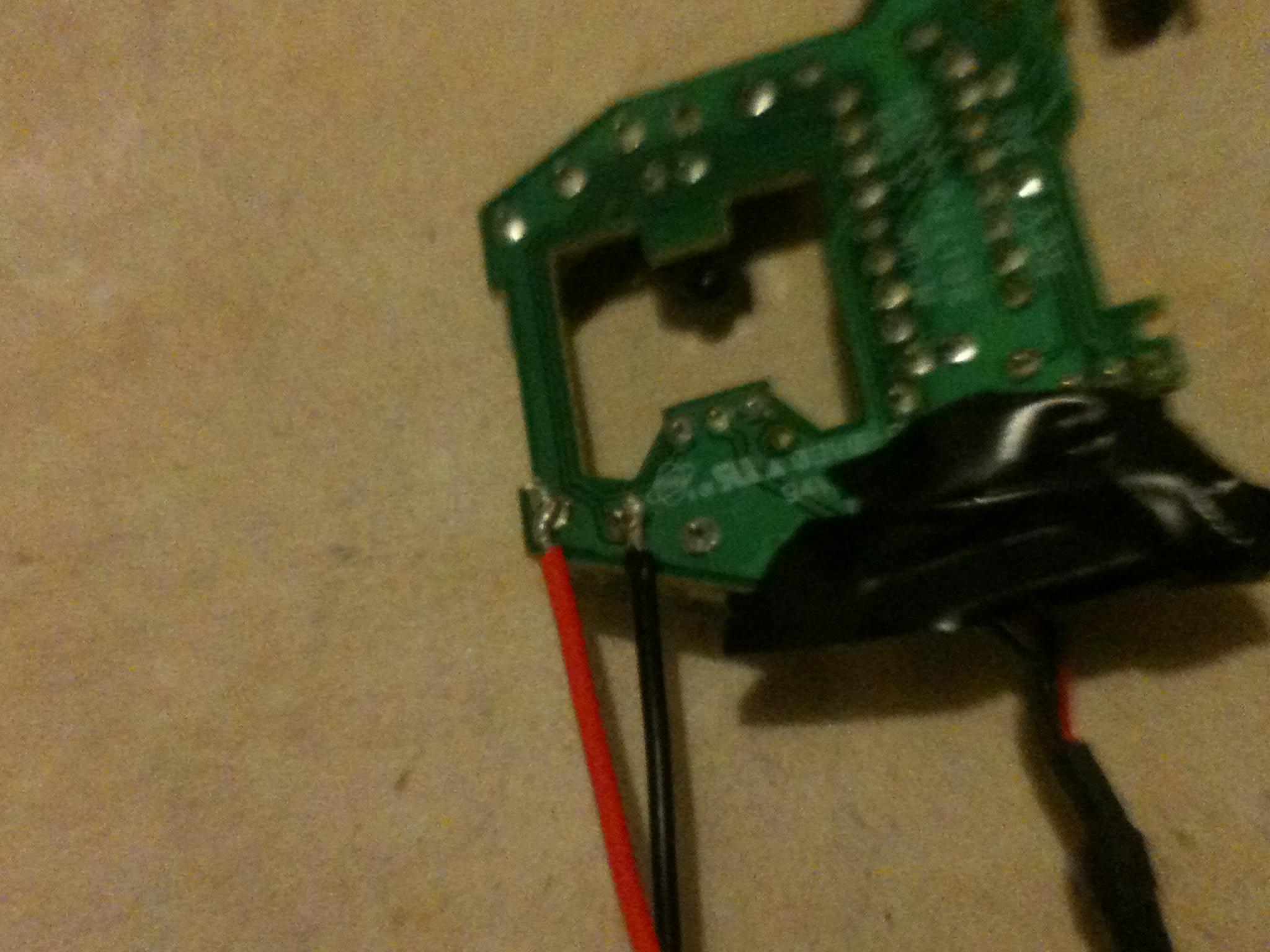

For the wheel, I tried to strip out a USB ball mouse first but it just wasn't moving consistently, or very well at all. I actually got a laser mouse hacked to bits this morning (pictures pending) and it work MUCH better. The only down side being that the wheel  uses the up/down instead of the left/right because I couldnt get the board to sit in the opening the other way. The mouse hack might be temporary if I end up getting a PC wheel. I mean I really want the PP cab to play pole position, but I'd rather player the model 2/model 3 etc ---steaming pile of meadow muffin--- more. I'm still not 100% sure what to do about the pedals. I mean I can put switches down there, but then the gas is either all on or all off. Im leaning towards a  PC wheel because of that. I also have a Dreamcast Steering wheel, I may use that with a USB adapter.
above: the USB ball mouse hack, mouse button hacked to shifter, same as new hack, I just dont have any pix
The shifter is soldered into the left mouse button. I actually have a 4 button mouse in there, so I may solder into the other inputs or use the $15 encoder from Vigo in this. The pedals really have me wondering... maybe an A-pac, I really don't know. I'll be drilling holes into the shroud for the camera buttons, now before you throw a hissy fit remember 2 things, the shroud is pretty rough to begin with, and Haruman said it was ok. I may use the buttons I got from Nephasth that are clear and wire colored LEDs into them. I think it'll look neat.

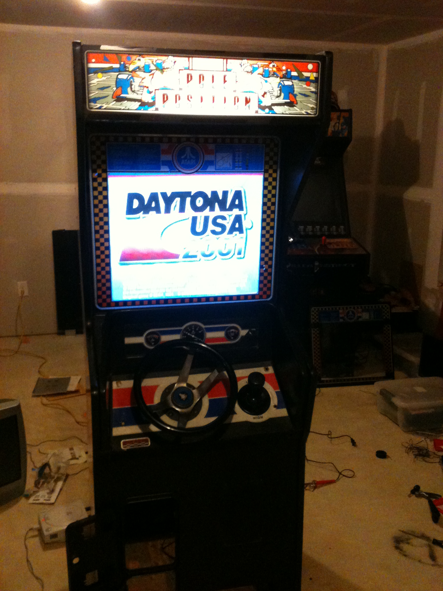

I'll post more when more work is done, I'm still in the middle of getting the PC (AMD dual core 2.3)  together and seeing if I need to buy a video card for it for model 3 stuffs. I cant wait to figure out how to get Cruisn USA, Pole Position, SCUD Racer, etc all running without wanting to punch a baby.
proof of concept, a sega dreamcast via composite input

some progress now. Nephasth came through BIG TIME with the prewired LEDs.
I took a button, that I ironically bought from Nephasth, and have the cut a channel where the hole was drilled for an LED
ooohhh look at the pretty UMK3 screen burn on my MKII
inserted and waiting to be plugged in
everything wired up, including Vigo's encoder. I cant say much about the encoder, its just for coin up, start, and camera views. I might run a wire down near the coin door to act as a service mode button
Lights on, lit up:
Lights OFF , lit up:
2 distance shots. me likey.

Re: Not Yet Named Pole Position conversion (new pix 12/12/11 of LED goodness!)
« Reply #30 on: December 12, 2011, 05:58:34 pm »
Wow! Those turned out great! They look much better actually installed in the buttons. :applaud:
« Reply #31 on: December 13, 2011, 02:41:09 pm »
For the tinted plexi, I'm sure you've already checked them out, but I'll be going with TAP Plastics' Solar Grey for the Two-Headed Beast. Two sheets cut to size for me would run around $30 I believe.
Nep, you raise the bar for me when it comes to wiring! I like what you did there.
Did you not use resistors on those LEDs?
« Reply #32 on: December 13, 2011, 02:50:47 pm »
Yea, the resistors are soldered into the harness next to the large connector. Got some heat shrink tubing over them. They're 460 ohm resistors, all LEDs are wired in parallel.
