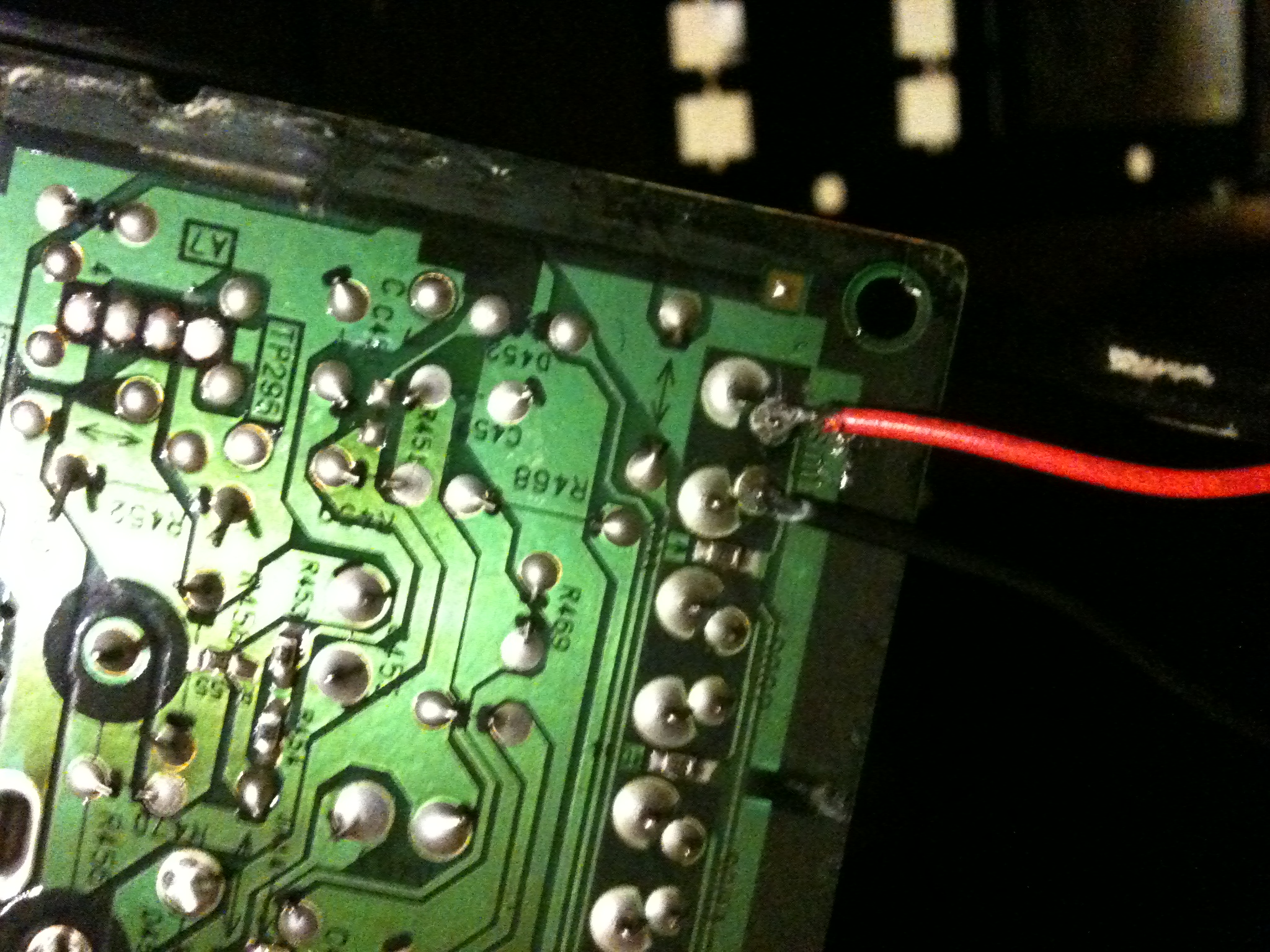

The Monitor is a de-cased 27" TV. Yeah, I squeezed a 27" monitor into a pole position! I rank this up there with a 32" monitor in a KI2 cab ;) To make it fit I had to pull the 2 little strips of wood off of the front of the monitor area, and use a hacksaw to cut the metal tabs off of the corners. Not all the tab just half of it, so I had something to brace to the insides of the cab. The TV has component input as well, and I plan to use it if not it also has S-video. I soldered to wires from the chassis to arcade push buttons. 1 for power, 1 for input; just in case I put a dreamcast in there or something.
above: the inputs. I used a regular composite (V/L/R) wire for the component connection, I'll eventually buy the right wire....maybe.

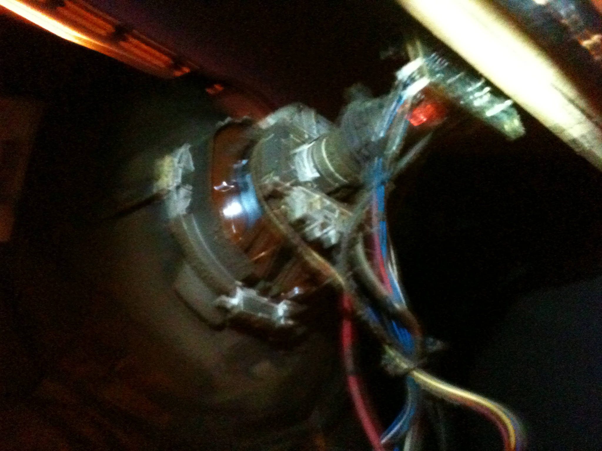

above: there isnt much clearance for the neck tube for a 27" CRT inside a Pole Position
above: the power/input soldering

For the wheel, I tried to strip out a USB ball mouse first but it just wasn't moving consistently, or very well at all. I actually got a laser mouse hacked to bits this morning (pictures pending) and it work MUCH better. The only down side being that the wheel  uses the up/down instead of the left/right because I couldnt get the board to sit in the opening the other way. The mouse hack might be temporary if I end up getting a PC wheel. I mean I really want the PP cab to play pole position, but I'd rather player the model 2/model 3 etc ---steaming pile of meadow muffin--- more. I'm still not 100% sure what to do about the pedals. I mean I can put switches down there, but then the gas is either all on or all off. Im leaning towards a  PC wheel because of that. I also have a Dreamcast Steering wheel, I may use that with a USB adapter.
above: the USB ball mouse hack, mouse button hacked to shifter, same as new hack, I just dont have any pix
The shifter is soldered into the left mouse button. I actually have a 4 button mouse in there, so I may solder into the other inputs or use the $15 encoder from Vigo in this. The pedals really have me wondering... maybe an A-pac, I really don't know. I'll be drilling holes into the shroud for the camera buttons, now before you throw a hissy fit remember 2 things, the shroud is pretty rough to begin with, and Haruman said it was ok. I may use the buttons I got from Nephasth that are clear and wire colored LEDs into them. I think it'll look neat.
