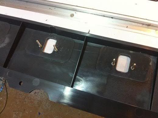

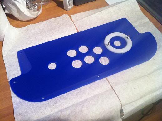

I often use acrylic with counterbored holes to make mounts:
