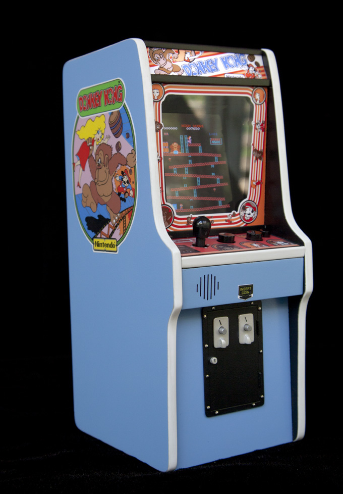

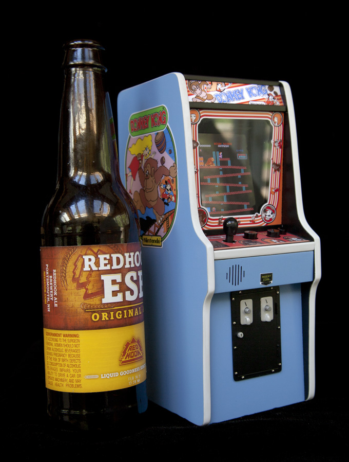

Well I've been working on this for a while. I wanted to make a tiny tiny working DK cab that was very playable, battery powered, had real controls, and ran vertical MAME games
I've seen one smaller MAME cab built out of a Ipod nano but the nano was sticking out of the side and the controls on the Nano.. Well... Suck, so I'm not counting that ;D
I was really inspired by patrickl's Pocket Galaga(approx 11" tall)
But couldn't see building one for only one game, plus I wanted to make it even smaller, 1/8 scale to be exact(approx 8.25" tall) and even though that doesn't sound that small it is as that is a linear scale, and by volume it is 512 times smaller than an actual DK Cab
So on to the good stuff I've been doing research on the many handheld Systems out there now that do a decent job running MAME, and the two I settled on that had the right screen size(exactly 1/8 scale to a 19" arcade monitor) were the Dingoo A320 and The GP2X Wiz, so I picked up one of each and The Wiz ended up being a far better machine, OLED Screen and faster processor, so I decided to use that for the guts, the other issue was finding a small enough joystick that worked well, and I had a couple of options there and found one that worked Quite well, but more on that in the build details, to come
I took a bunch of Progress Pics and I'll post them here later, just wanted to get some Pics up cause I was so exited to see it all finished up
Oh yeah, it has a lit marquee and tinted glass, too!

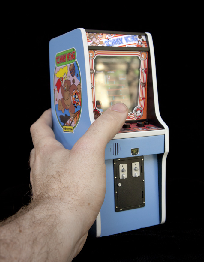

so here you can really see the scale up against a full sized DK

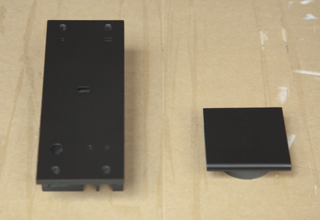

Here are the promised progress pics!

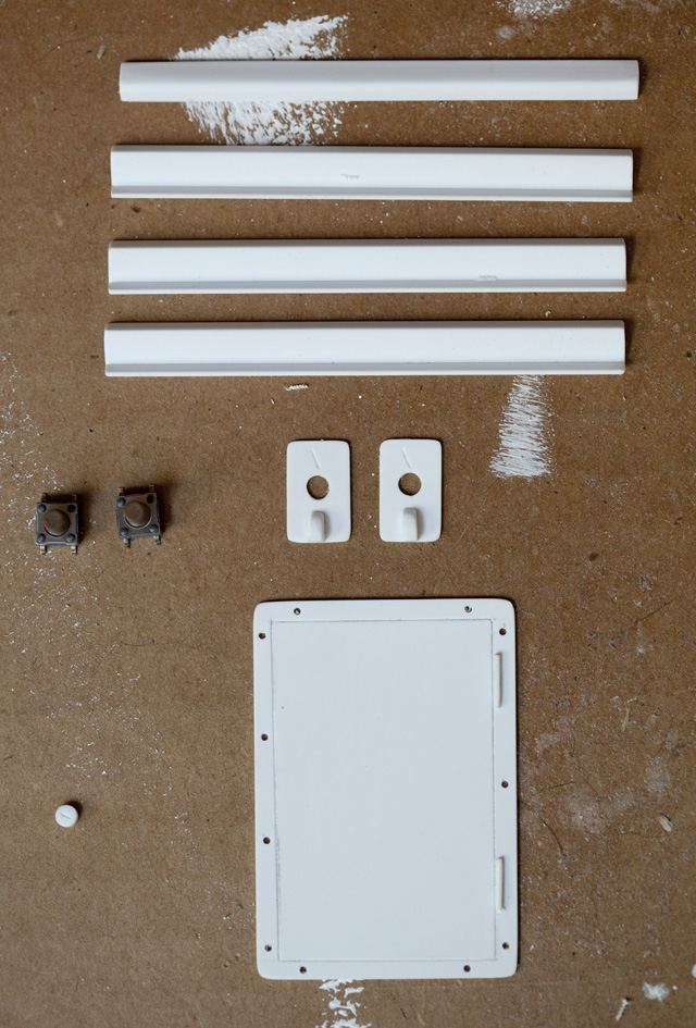

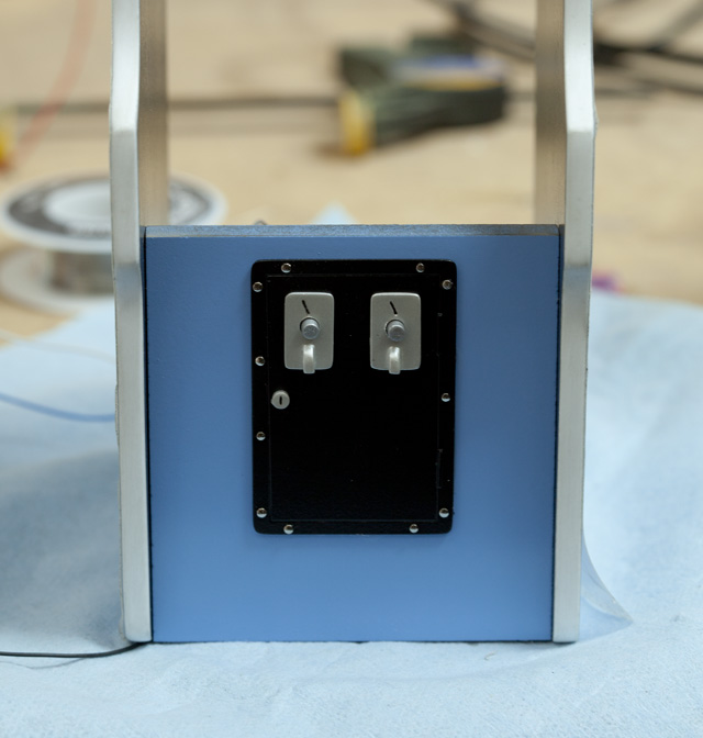

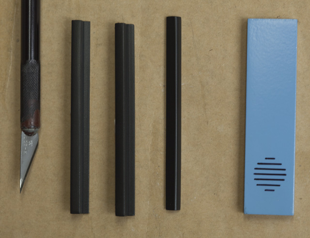

These are the coin door parts and marquee/bezel retainers before painting, all made from model maker's styrene sheet and profiles
I als used styrene strips with the edges rounded(by carefully sanding) to simulate the T-molding
Here is the coin door painted and the pinheads I cut and glued in to use as rivits
I did some test paint on scrap to practice how to get the textured look to the paint, basically I used a can of semi-flat spray paint and would, do pretty heavy coats to get a subtle orange peel effect that looks a lot like real coin door

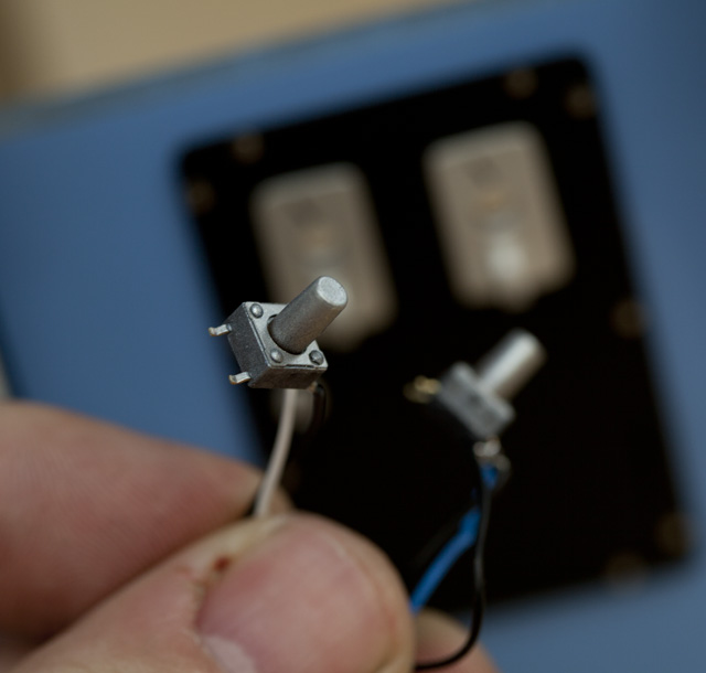

These are the coin buttons used painted with same silver paint I used on the coin mechs
9.5mm tack switch from radio shack here
I als used these for the volume and Pause buttons on the back
The finished coin door installed

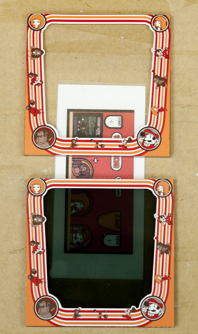

Marquee/Bezel retainers painted and coated with a satin clear coat, and the bottom of the CP panel with faux speaker grill, I made indentations then filled the indents with black paint to get the lines

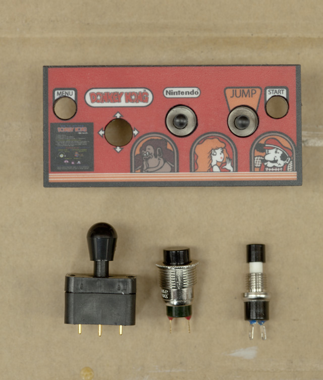

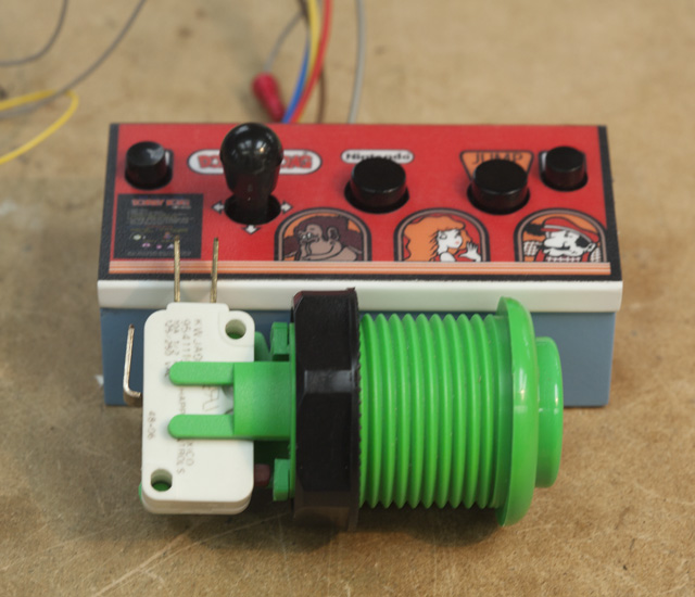

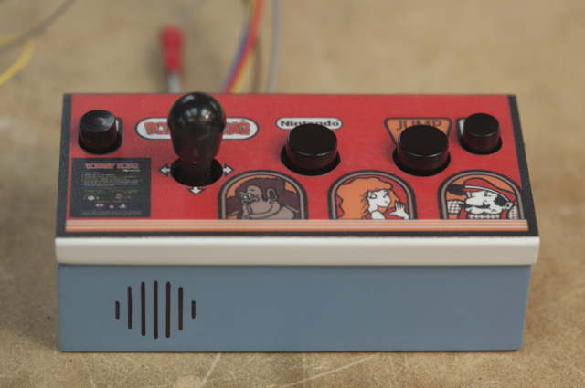

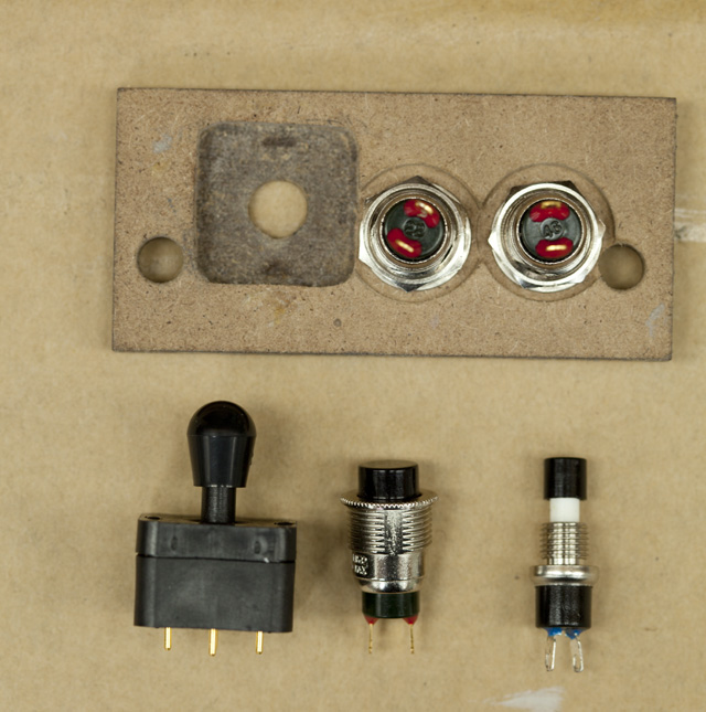

these are all CP controls from the front and the back and with a regular button for scale
I installed the larger buttons below the artwork so the silver rim wouldn't be seen, I found it a little distracting
Joystick from Digi-Key Here
Larger buttons Here well turns out these buttons are too stiff, I'll post an update when we find the right ones
UPDATE The ones I used are hereC&K 8532
Smaller buttons from radio shack here although I got mine at a physical store and they had a different top that I like better
I also used this used this button from radio shack for the power button on the back, I also recessed it so it would be hard to hit accidentally

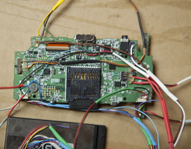

Back hacked up wiring on the Wiz

here are my two first plexi bezels, the clear was too light and the smoked was too dark so I ended up putting the lightest car window tinting stuff on the back side of the clear one and it was perfect, unfortunately I didn't take any pics of that

super nice job Bender.
i built a fullsize replica about 8 years ago, but i love this one, would fit nice on my desk at work.
you gonna share the plans with us?
please :)

yeah, she's sitting right here on my desk next to me now
I used 3/16 (5mm) MDF for most of the construction, as for plans I took the jackobud DK plans and scaled them down to 1/8 scale which is 12.5% of the original, I printed them out (nice thing about this project everything easily fits on a standard sheet of paper) lightly spray-mounted it to 1/2 MDF and cut out the template for the side panels
I do remember making all the inside widths 3" so everything that fit between the 2 large side panels were exactly the same
I did make some minor adjustments as I went, but basically I laid everything down right on the printouts to size them up
Foam-board is usually 3/16th s also so I made a full mock up of that first, in a couple hours with just an x-acto and hot glue (actually stuck the un-hacked wiz right in there to see what the screen would look like)
I also used a bit of modle-makers' styrene for various parts like the t-molding, marquee retainers, coin door, etc., and it was all put together with CA glue for the construction and hot glue for the electronic bits (so I could get them apart)
I did make a special back section to house the Wiz board/screen that is screwed in so it's removable, look for that in the videos soon
