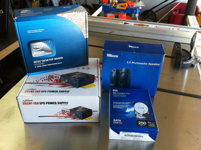

Okay, I've finally got sawdust on the shop floor, so I might as well add my own project announcement for the mini vertical MAME cabinet I'm building for my son's 5th birthday.
The Games: I've about decided to play vertical games only on this game.  Also, I'm not planning to load every game in existence.  Right now, I have a list of about 70 vertical games... mostly from the 80's and early 90's.
Front End: MALA :) I really like it.
Cabinet Size: My wife did not like the idea of me building a refrigerator sized toy for the house.  I showed her a mini MAME cabinet and she thought it was really nice.  So, the design is going to be a 3/4 scale cabinet (about 50 inches tall).
Cabinet Style: I originally was going to just scale down a Galaga cabinet.  However, I didn't like the idea of using something so recognizable, and then not having it be a faithful reproduction.  So, I looked around at other cabinets.  I really wanted this thing to look like the cabinets I played on in the 80's.  I liked certain things about different cabs.  My favorite was the Galaga/Ms. Pacman cabs and the Taito cabs.  I decided to see what I could put together from the two styles.  Finally, I ended up introducing Rastan to Ms. Pacman, played a little soft 80's music and let nature take it's course.
Their resulting love child was a 3/4 scale cab that had the features I liked best from the two.
Cabinet Theme: The name of the arcade is "American Ace".  My son likes airplanes and shoot'em ups, so I'm going to theme the cabinet after WWII American fighters.
The Brains:  I bought an Intel Atom motherboard, memory, power supply and hard drive.  I didn't feel like messing with older hardware.  In retrospect, I wish I had just bought an old PC off Craigslist (it would have been cheaper.... and couldn't have been any more frustrating. :))

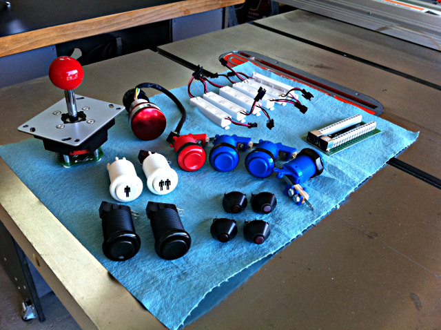

Controls:  I picked up a U360 with an octagonal restrictor, some leaf switch GGG buttons, couple of standard micro switch buttons, four volcano buttons (for admin), a spinner from Ultimarc, and an IPac.
Montior: I’ve got a 17” CRT Pc monitor I’m going to mount vertically.  This is going to be a tight squeeze.  I’ll give more details as things get implemented.

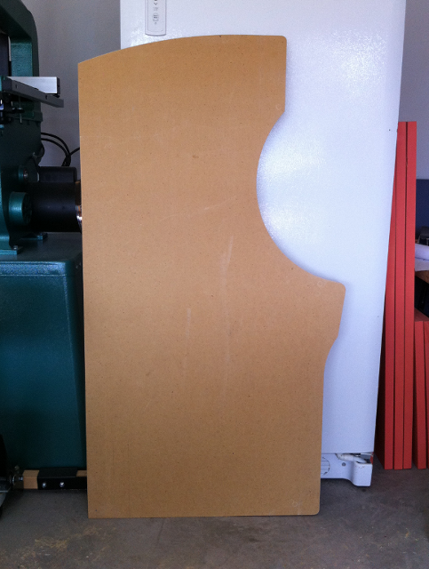

I made a template out of 1/2 inch MDF.  I'll use this to route both side panels.  I made the template deeper than it will end up (I'll likely take an inch or two off the back.  I made it oversized so that I would be able to fit my monitor.  Once the monitor is in, I'll trim whatever I can off the back.

I quite like the profile of this cabinet. Good to see you are keeping the CP quite simple. Just a stick, spinner and four buttons. Many people try to cram in as much stuff as possible on their first build (I was guilty of this myself).
Not sure I like the way the monitor is laid so far back. I would personally have it more at 45 degrees. But I realise that the original Ms.Pac cabinets had their monitors like that. In actual use you will be using a stool I imagine. Will the angle of view be comfortable? You don't want to find yourself straining to get a more central view if that's how you prefer to play. (I don't mean "viewing angle" as per tft screens... you are using a crt so that's a non-issue. I purely mean for comfort)

That spinner, is it mounted in a 30 mm hole like a button? If that's the case I would get a button plug as well, so you can just pull it out and plug the hole when you're not in a spinner-game mood. I really like the profile too.  :applaud:
I actually was concerned when I started my design.  Theres a pizza place by my work that has a Ms Pacman machine.  I went there to check out the cabinet (even though their pizza is not that great).  Sure enough, the screen and CP were on the same plane; around 15 degrees I think.  Given that adults will be sitting down to play, the player's view of the monitor in relatively the same as a full size.  Also, my design has the monitor between 22.5 and 30 degrees.  I won't know for certain until the thing is finished, but I have considered that if viewing is uncomfortable, I could raise the angle and swap out an LCD (don't want to do that :))

Got some goodies from Groovy Game Gear in the mail.  I ordered a new black anodized spinner top to replace the red one I got from Ultimarc.  I liked the red one, but it seems just a hair too large for my control panel, and the anodized red didn't work for me.  I really do like this new spinner top.  It has a nice satin finish, and the smaller size seems better suited to my control panel.  Also, I think it is going to look nice with my volocano buttons.
I also got a new Hand-Candy joystick ball top.  I didn't mind the seam or the dimple on top of my old ball top, but I added this to my order to better justify the shipping (I know there's no logic in that :)).  Anyhow, I really like it now that I have it. http://groovygamegear.com/webstore/index.php?main_page=product_info&products_id=368
