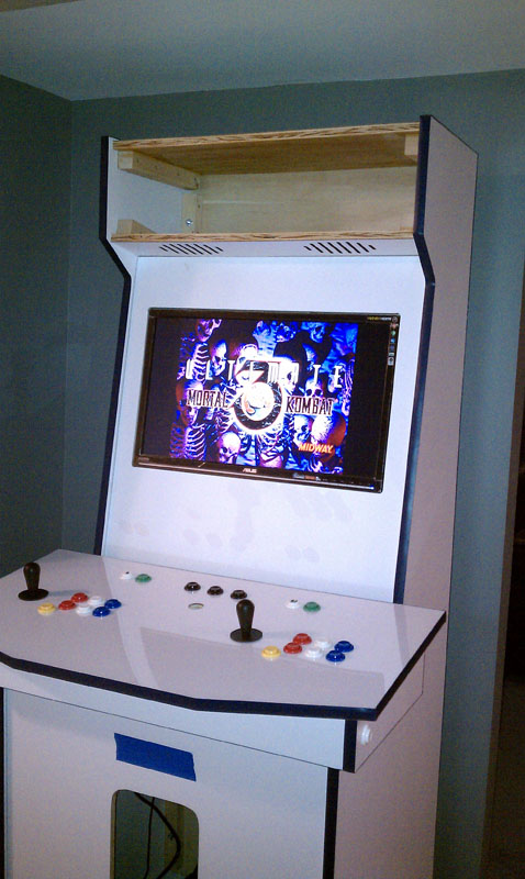

Got the wood batons glued/screwed and the blue tmolding installed. I did a test with wood glue and it would not adhere well to the laminate(ideally you would want to screw from the plywood into the baton, but i did it backwards) so i used epoxy and screws.
Getting there.. I used epoxy and screws to attach the batons to the sides and just used wood glue to attach the top, speaker shelf, base, coin door.

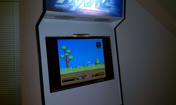

Here i got the screen and coin door pieces cut out and laminated. I have the screen piece attached with this velcro i found at radio shack, its very strong but can be removed if needed.
I was going to use 5% tint on my plexi and cut out the area for the screen. I did a test using a piece of 5% covering the screen and I liked the way it looked, so i covered the whole plexi with it and it came out great. It hides everything perfect and my 24" lcd at its default brightness looks great.
My control panel wiring, the wires going into the ipac are a little messy and i probably could have spent a little longer cleaning them up, but whatever. Being as i used each pair of wires per button as oppsed to wiring the grounds in series.. i used terminal blocks so all the ground wires could connect to it.
I installed 2 fans on the back of the cab to help keep everything cool. The back has 3 sections and I installed T-nuts into the wood batons behind it so I can easily remove a section if needed.

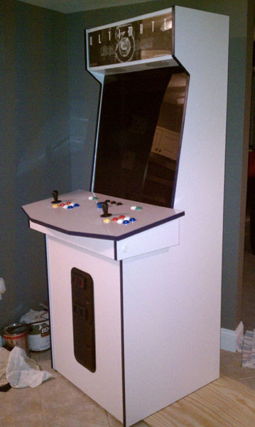

And here is the completed unit. Well almost completed... i dont think it will ever be done. Im using one of my old dell computers right now. Its not powerful enough for hyperspin at the highest  setting so i plan on upgrading it soon. It does play all my roms just fine though.

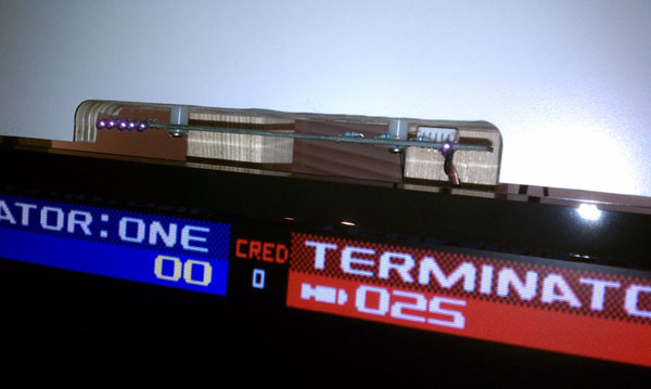

In the last couple of weeks i had a MAME marquee printed. I had been using a umk3 marquee that i printed on my laserjet just to have something there. I also added 2 aimtrack guns. I used 2 yobo guncon2 guns that i gutted and installed the aimtrack modules into. I also added the led bar behind the tint above the monitor. I was worried that the tint would affect the performance but it works great without any changes from the default settings.

@Erik - It just wasnt as nice as birch plywood. I needed 5/8 and thats all I could find so i used it. I had to pull off the top 10 sheets on the pallet to try and get the straightest pieces and they were still a little warped. Luckily i was able to straighten everything out when I put it together. Next time i would go to a lumber yard and order 5/8 birch plywood if i had to. Or maybe even try mdf.
@eds1275 - thanks, i thought the white definitely had a clean look to it, plus it matches my game room. I do a have bit of empty space below my screen but the whole screen area is covered in 5% tinted plexiglass so everything is black. That last picture i added was just to show where i mounted my aimtrack led bar and i didnt have the plexi on. I kinda like the minimal look so ill probably just leave it as is unless i can come up with something clever that has a clean look to it.
