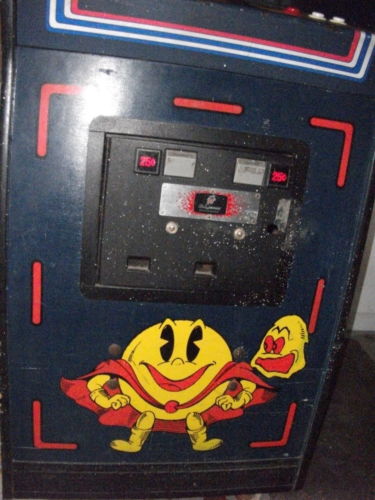

1)  The cab has what looks to be white paint splatters all over it.  I think someone painted a room and didn't cover it.  By the look of the splatters, I think they painted the ceiling.  Anyway, how do I get those off without taking off the original paint.
I'm not sure if there's an easy way for this. You might be okay to use some paint-thinner mixed with water to lightly brush off the white splatters. I use eco-friendly turpentine (found at any art store), it's non-toxic and can be diluted with water. Start off with a thin mixture, get a small paint brush and apply it to the splatters, let it sit for a few minutes, then wipe it away with a damp rag. If the mixture doesn't work well, decrease the amount of water that you diluted it with then repeat the process.
It might take off the paint underneath it, in which case you might want to touch it up with the original colour. But hopefully if the mixture is thin enough that it'll only take the splatters.

Tried a paint remover that was recommended by a friend.  It didn't take off the white paint splotches.  I might try my hand at using a razor very carefully.  It will take literally forever, but it might be worth it.
I'm also having trouble figuring out a way to get a piece of this to Home Depot to get the blue paint matched.

If it's latex paint, which it probably is, there's a good product called Lift off
http://www.amazon.com/Motsenbockers-413-01-Latex-Based-Remover/dp/B000LNVODI
I have used it successfully to get latex paint off of oil paint, kitchen cabinets, and the like without damaging the finish.  Test in an inconspicuous place, YMMV, etc. etc.

A friend gave me that and it didn't work.
good indication that it's not latex paint then.  gonna be tough to get off without damaging what's below.  Looks like its worst on the coin door and t/mold, easy to repaint and replace, respectively.  Good luck.

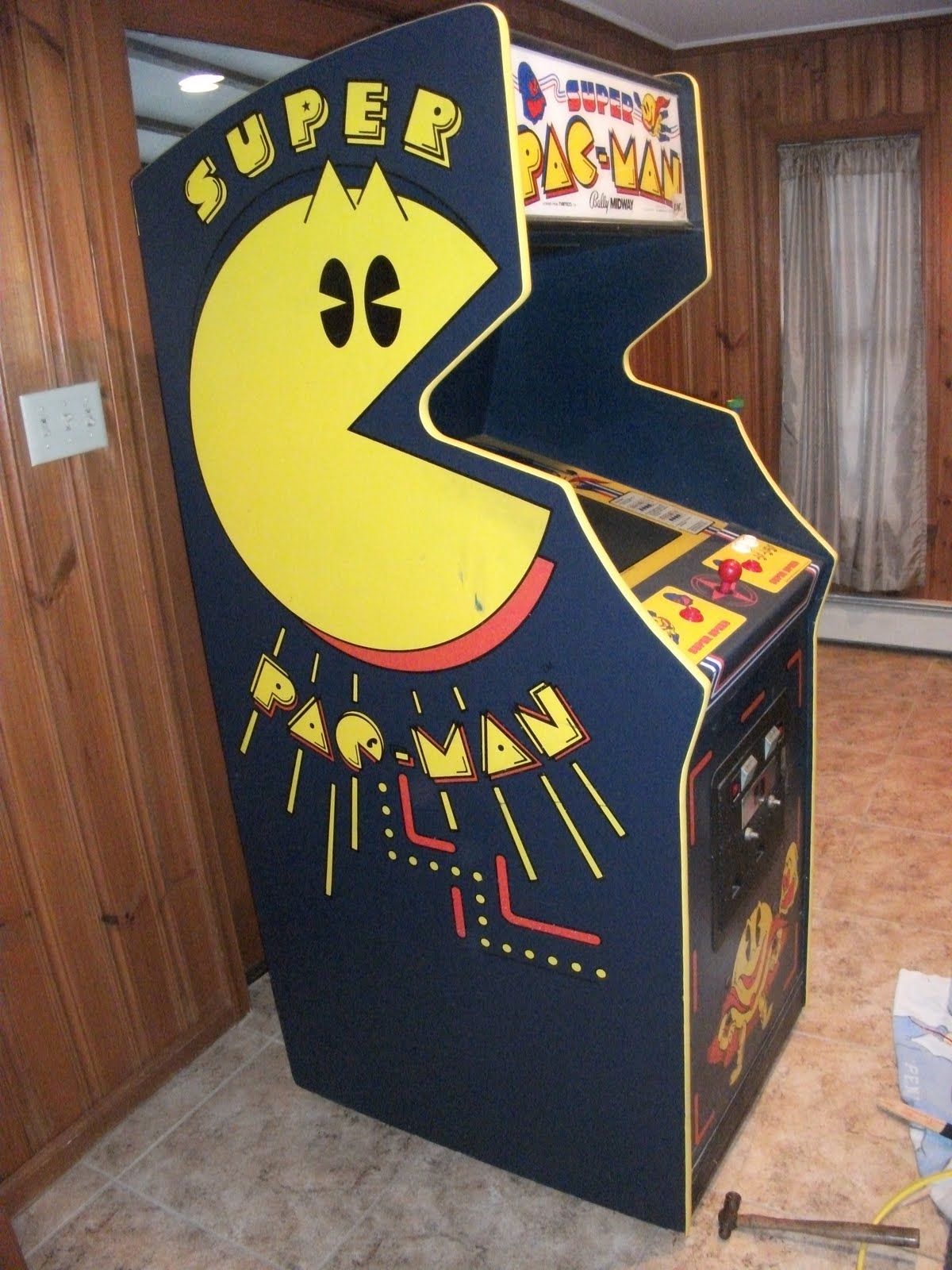

It's slow going as I don't have a ton of free time, but I'm almost done painting the blue on both sides.  Yay!

The new T-Molding is on and I managed to get most of the white paint splatters off the coin door.  I need to do a few touch ups on the paint apps and then it goes back to the owner after a year of me working on this piecemeal.  I'm both sad and happy to be done with it.

Dunno, but I think that the paint splatters are normal in Pac Man cabs... take a look at Spyridon's resto here http://forum.arcadecontrols.com/index.php?topic=87614.msg1006918#msg1006918

« Reply #22 on: January 08, 2012, 09:25:04 pm »
The long anticipated picture update.  Ok so I doubt anyone was really waiting with baited breath for this, but I figure for anyone who was wondering, I'm almost finished.  Only have to replace the plug and do some final touch ups on the blue and yellow before giving this thing back in way better shape than I got it.
