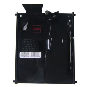

As far as coin mech go here in the US. the coin mech is the part inside behind the coin chute.
that part gets changed out for different currency such as if a machine takes quarters or for whatever size tokens it may take.
Vending machines have setups to take multiple different coins and I've worked on redemption games with coin mechs that use a reference coin in a slot, so that sets what coin it is to take.
Heres a link to a place that has some multi-coin mechs, I'm not sure if they help
http://www.weavefuture.com/

stick a credit board on-something like a klingon
what coin mech are you using?
also there are coin mechs with built in credit boards such as a cashflow c340
