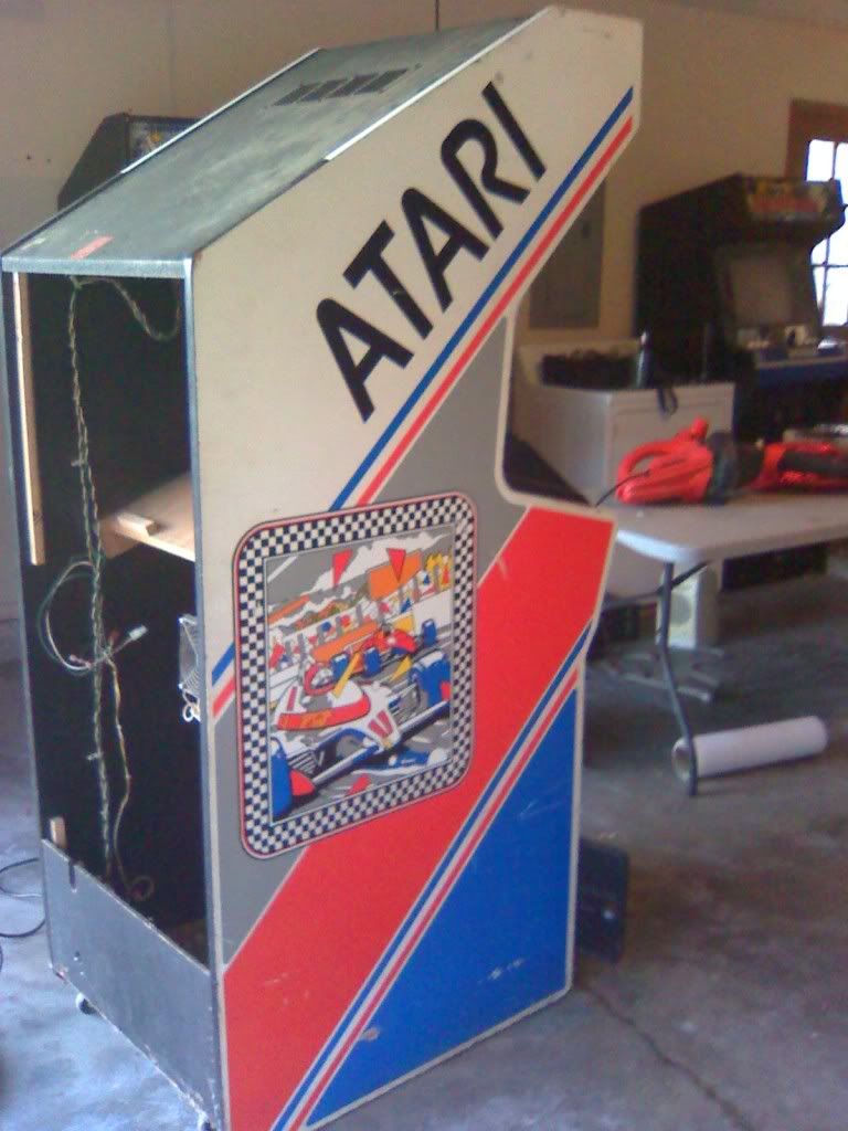

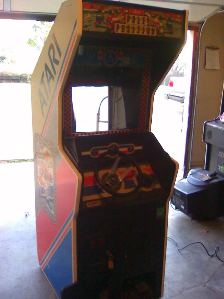

Hey everyone, I have something I have been meaning to do for a while now.
I have a very clean Pole Position cabinet, 3 sets of boards, and all of them are corroded and beyond repair.
Anyone knowing anything about Pole Position will quickly tell you that keeping these machines running correctly is a major hassle.  In fact, 1 out of every 10 times I turn it on it doesn't work anymore.   :banghead:
So, hell with the original boards.  I'm yanking them out and attempting to run the game via MAME.  Sort of like this bloke did here.
So I sorta understand what he has done here, but I really need a few suggestions from some of you as to how to go about getting this project going.
I have removed all of the original arcade components and harness from the machine.  In fact, anyone helping out who would like to have any of these parts I will send them to you for free if your suggestions are helpful.  (except the board, for legality reasons)
Here is what I have to use:
Pole Position cabinet with wheel, shifter and pedal
Pentium 3 PC w/ 40 GB HD
19'' LCD monitor
PS-2 mouse
PS-2 Keyboard
PC speaker system
Windows XP installation disc
I know how to use MAME (for the most part) though I am not fluent, and may need a bit of help.
I assume I will install XP, install MAME and acquire the Pole Position rom, and set the machine up to boot directly to Pole Position upon entering windows (unless someone has a better idea)
Apart from that, I just don't really understand how I will be able to get all the controls (wheel, pedal, shifter) interfaced.
In David's video, he describes the mouse as being the entire input device for every single item.  Left click was shift, right click was accel, etc.
I just don't get how he did it.  Hopefully some of you can help?
If there is any interest we'll do a step-by-step here, include some how-to pics, and maybe also help some other PP & PPII owners out there dust off one of their old favorites!
Any help would be truly appreciated!   :cheers: :cheers:

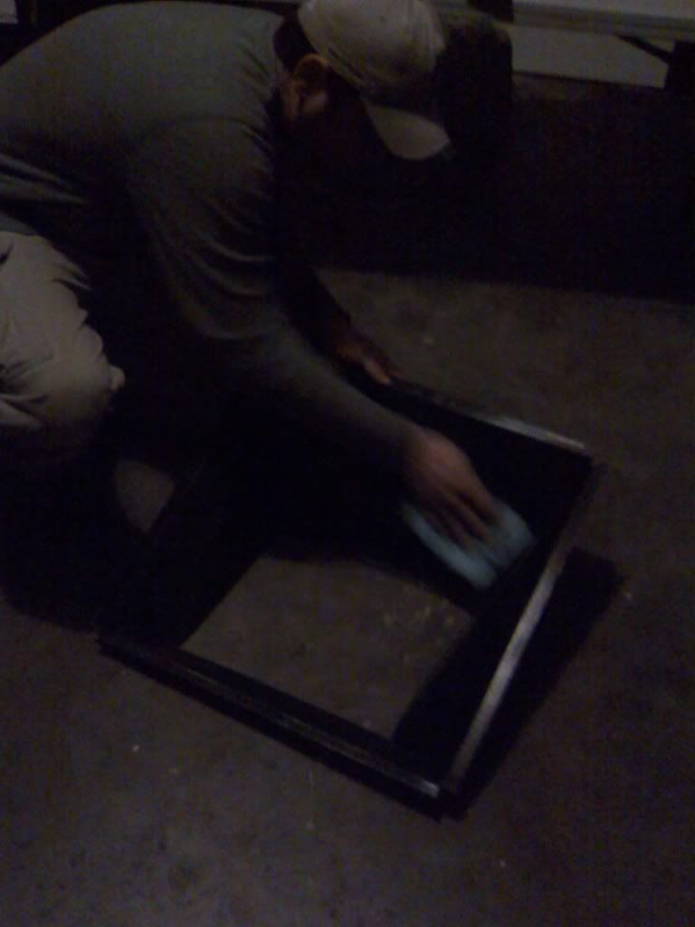

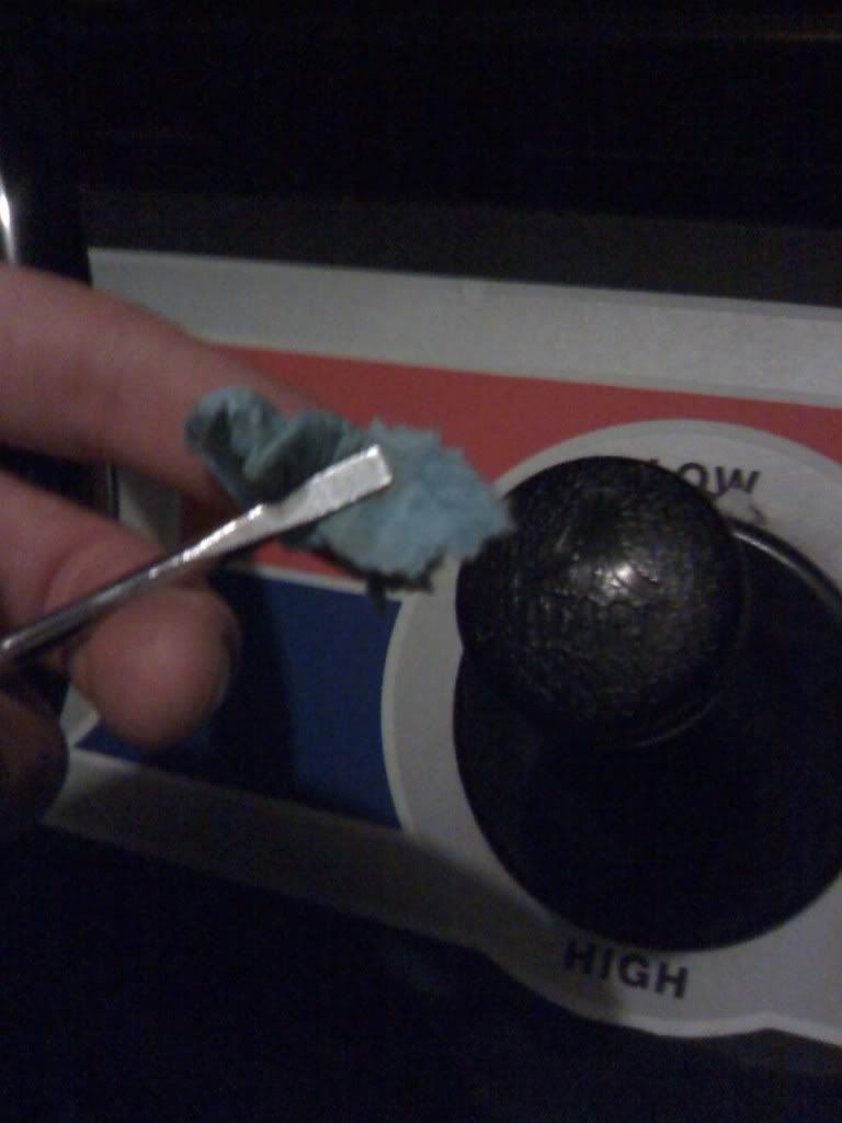

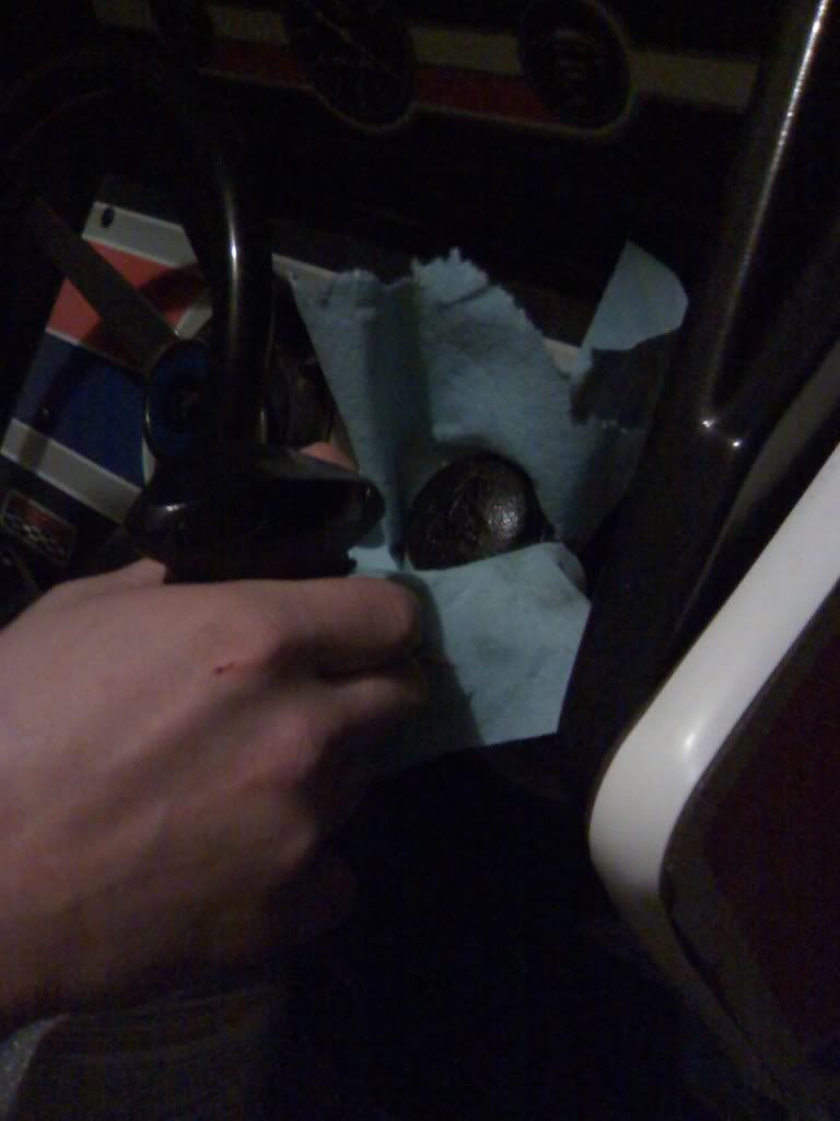

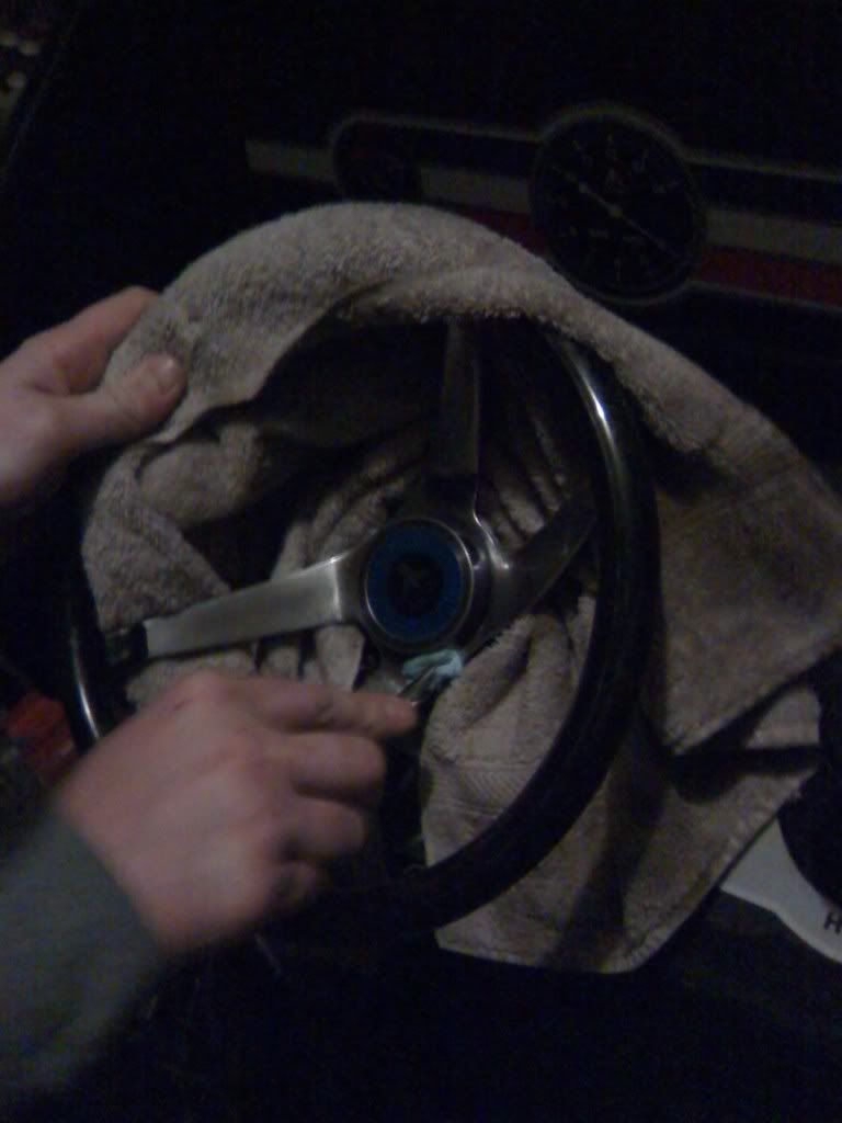

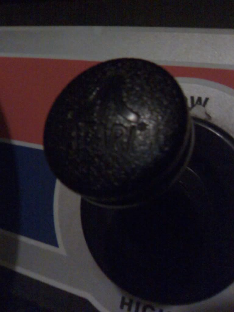

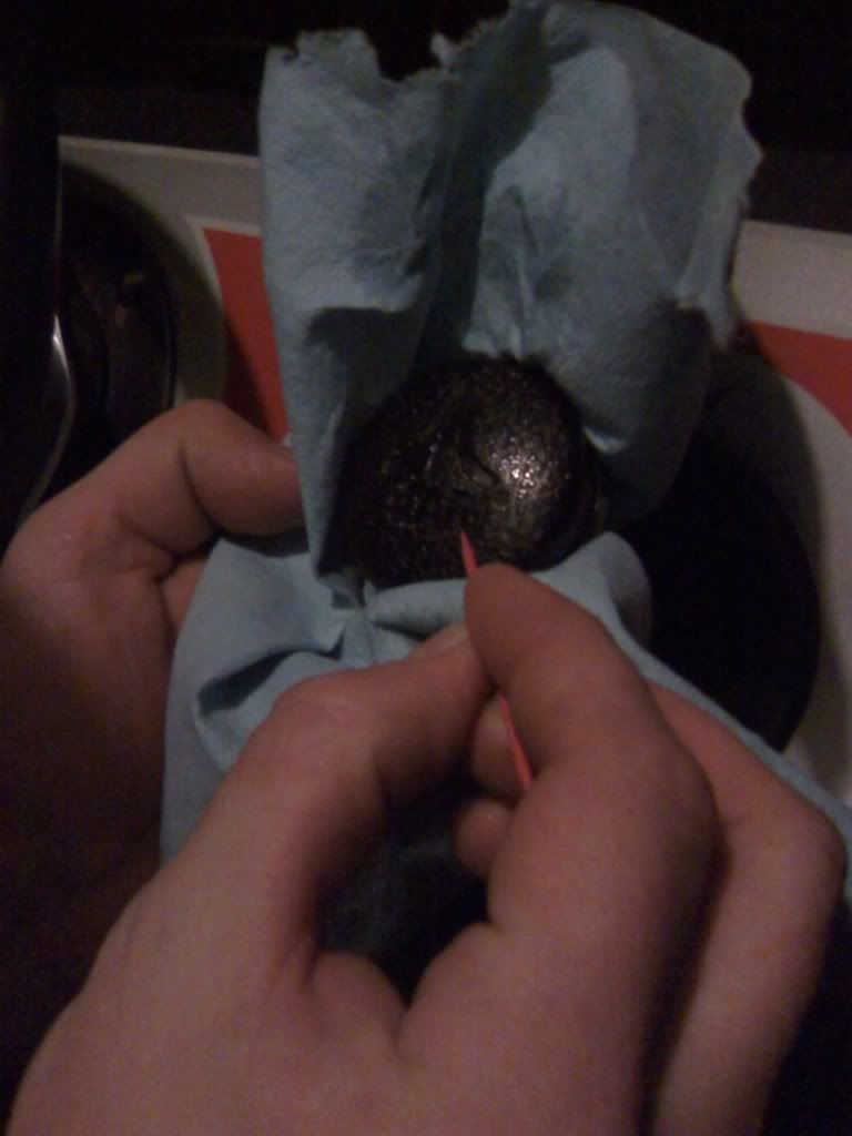

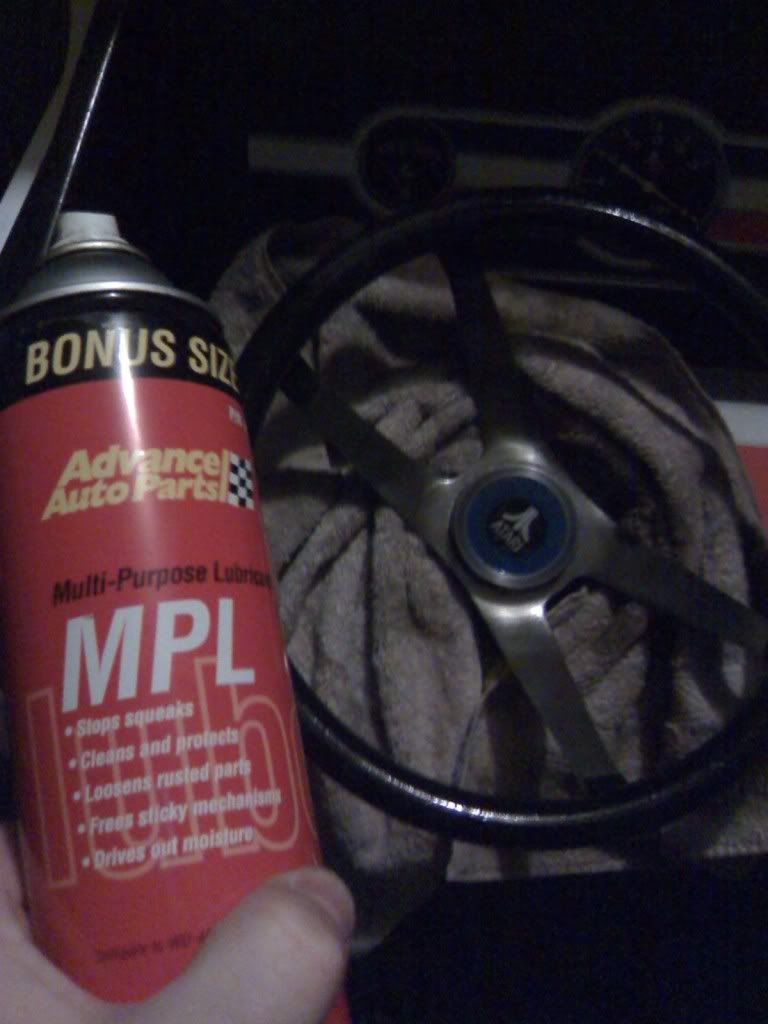

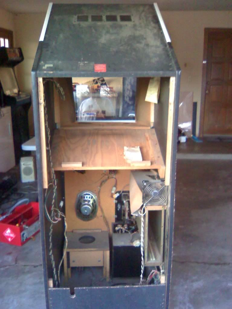

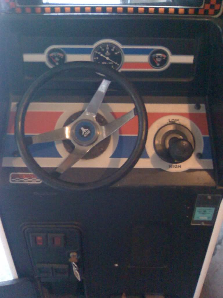

So, pulled her out of purgatory last night, and actually ended up working on a good base cleaning for around 4 hours or so.
Scotch-brite, MPL, Windex, Fantastik, toothpicks, screwdrivers etc all came out of the woodwork- just to clean.
I went ahead and pulled the entire harness and the 'big blues'.  Those have actually been replaced recently and may be of use to someone!
Also removed the cage and fans.  That cage is a monster, and I am happy to donate it if anyone wants, but I'm gonna have to insist you pay the shipping on that one.   :lol
So, after 4 hours or so of cleaning, she looks suitable enough to begin a build.  Here are some progress pics.
Pulled the cabinet into the garage.  Nothing to be ashamed of, but boy does it need some cleaning.
Started by removing the entire harness, fans, cage and caps.  Left the control pots for volume and test mode mounted in case I decide to use them somehow in the future.
After that, got down to some nitty gritty cleaning.
Jeez, never noticed how awful the lighting is in these photos!  I gotta do something about that!
Scrubbed down the CPO with some Fantastik.  If you've never used that, I highly recommend it.  Available almost anywhere too.
Wiped down the old bezel using a blue shop towel and a small amount of warm water.  It was SUPER filthy.
The shifter was just gross.  Years of sweaty dead skin cells and grossness was stuck in the grooves of the Atari logo.  Joe grabbed a small flathead and a toothpick with some WD-40 and got it looking like new.
Now it could pass for factory new!
So far so good.  We also removed the CP to lubricate the parts in the shifter and at the main gear on the steering wheel, (making sure not to get any fluids near the original optics, in case the end up being used!)
More to come, she still needs a little damp wiping out on the inside, after it was completely vacuumed it still left a little residue behind.
Also going to retrofit the monitor this Friday and decide on which CPU to install, and order some plastic PCB feet.  Control panel is looking next to new now though.
Sorry for the low- lit images, I'll grab the better camera next time around.
Cheers all!
