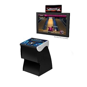

i've spent alot of time looking through the control panel thread for inspiration for my new 4 player panel, and i see alot of you have a nice curved front edge on your panels.  how are you creating these?  my current 2 player panel is just a rectangle, and i cant help but think the new one would look better with a curved front.  something like these...
i plan on just having a rectangular box under it, but i love the look of those curves,i'm just not sure how to draw it out and make it perfect and even like that.  i'm assuming you cut it out with a jigsaw and then sand it smooth.
how is this done?
