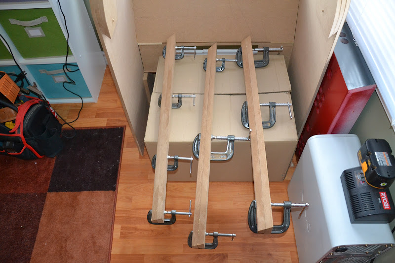

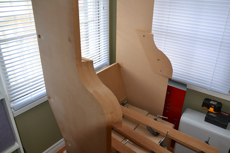

I did a couple hours of work yesterday, before the rain, and today, as I wanted to focus on getting the front angles extended...  These pieces were the most irritating, as I neglected to 'reverse' the right side, when I went to route it down.  Therefore, I had to do the right side twice.  They also don't fit up perfectly, as I used the same template as the outside edges, and the curved edge 'grew' across the 3/4" width.  I could have cut a new template for each of the three pieces, using the 'new' edge as a new template, but I figured it would be just as easy to sand it smooth, since I do need to Bondo the whole edge anyway.
Here's my youngest giving me a hand, clamping up the various extension pieces.
Three edge extensions, all clamped up and drying...
And, what the edge *should* look like, once they're dried, cut and assembled.
So, that's where we're at today.  I want to get some of the 'incidentals' out of the way, and that will include the front sides (three stacked 3/4" pieces on each side), the front panel with the coin door, and the base panel - which I have already carved out, ported for a subwoofer.
