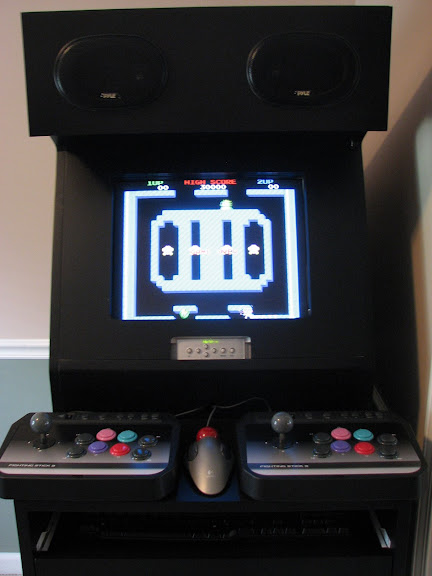

While we're discussing PC trackballs, in my last 'scavenge parts from wherever' cab, I ended up with this:
The ball is reasonably large and worked quite well for almost all games that I played with it.
It is far from small however.
For scale:
edit: And for comparison, the prior trackball:
