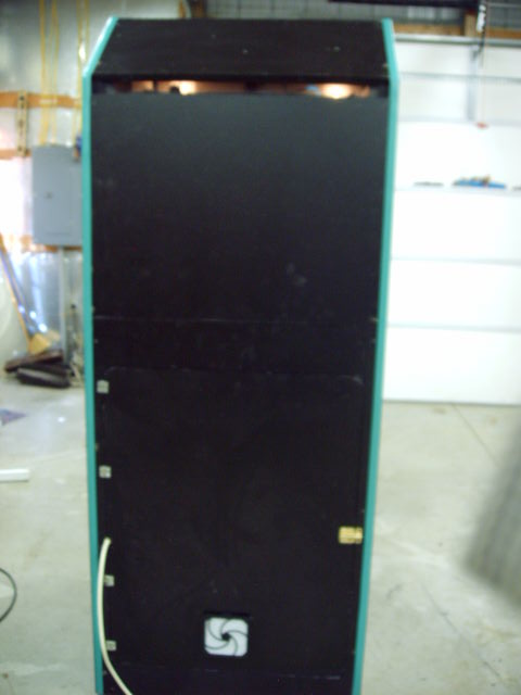

I just ordered one of these 250MM Fans from Xoxide over the week-end...shipping is going to take almost 2 weeks from FedEx!
I was hoping to complete the entire back over the three day week-end  :-[
I will add a toggle switch to turn it on and off so I can control the fan operation for the bottom flow, and use passive venting at the top. Come to think of it I do have some old 120MMs laying around that I can put at the top for extra whooshness  ;D
As far as power goes I also have this PCI Power Bracket on order.
Hope it helps!

PC fans typically run off 12V or 5V.   They are very easy to control with inexpensive fan controllers.   Do not use a mains powered equipment fan.  They are usually very high volume and make alot of noise.  They are also not as easy to control as PC fans.  There has be alot of work done to make PC fans quieter so buy one that gives you good noise specs (low) and the bigger the better.   Bigger PC fans push more air at lower speeds and are made to be quiet.
My preferred arrangement is vents at the bottom or wherever the equipment is mounted and the fan exhausting out the top back.

thats how i installed a 92 mm fan in my recent project . i m using standard fan grills , they 100 % fit on fans and speakers. for bartops or cocktails 80 and 92 mm is more than enough . i took a 76 or 80 mm holesaw for the exhaust opening . a temp controlled fan connected to ur pc mainboard will do fine. it runs slow and silent .  i decided to go with a 220 v one , coz the cab will house a sega saturn . make sure u dont buy the cheapest fan stuff available ,a few more bucks for some quality will keep the noise down and wont strain ur nerves . i sometimes buy sunon 4 euro low budget ones , but allways regret it afterwards.

I used a 120 VAC fan mounted at the bottom, blowing in. I have to agree with BobA, it is kinda loud.
This fan has a removable/washable filter on it, helps to catch dust that may otherwise get sucked in by the fan.

For my MAME cabinet, I simply got 4 12 volt pc fans and added 2 to the bottom to pull air in and 2 at the top to exhaust the air. I connected them to the pc power supply and it works like a charm. It stays a nice 26 degrees C in there constantly.

I have a Antec 250mm fan on the bottom of my cabinet and its super quiet. I bought it from Amazon its around $20. I'm no expert on Mame arcade cabinets, but I think most people put the fans on the bottom since the pc is usually located on the bottom.
