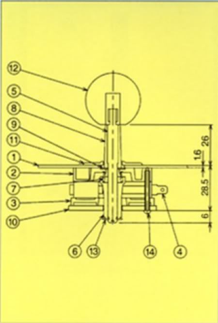

I have a Sanwa ball top joystick, which I need to mount in a shallow space (within a drawer, so the overall height is the issue). I'm thinking I could just cut the shaft a bit to reduce the height, but how far do you think I could go without affecting gameplay? I think I can get a smaller ball top for it, but again - does it affect the experience much?
I'm mounting in wood so I need to consider how much of the shaft will actually be exposed (this is just getting more and more dodgey  :laugh2: )
I realise this is a personal preference, and I'm not really worried about how 'authentic' it needs to feel, but I'd be interested in your opinions and any issues you might know of that I need to consider...
So - how long is your shaft?

You could put some spacers between the bottom of the cp and the top of the joystick so you could try it out for yourself.  The throw would be shortened by cutting the shaft down but you could do this just to get a general feel of how short you want to go.
_|_  cp
o|o spacer
[=]   joystick base

lA JLF is 32.5mm from the plate to the bottom off the ball. IIRC the correct mounting height is to have the mounting plate 4-6mm below the top of the CP so you are looking at a exposed shaft length of 26.5 - 28.5mm.
Standard ball size is 35mm so you are looking at a total height of around 62.5mm.
I think the important question here is how much space have you got in your drawer?

i ve  undermounted  a sanwa anda china longshaft stick into a wooden table with 18 mm panel . no problem at all with the gameplay and the appereance .  my ok baby sticks are very short , 2o mm panel to ball distance , but feel nice . astro has 25 mm around . naomi around 30 mm . if u get used to short stickssomeday u will hate the gaming feeling on cabs like sega naomi  .
why not use seimitsu ls 33 instead of the sanwa ?

I have a JLF Bottom-mounted (without the metal plate) under a 19mm CP on a mini cab I'm building and the shaft length is 16mm above the CP I also used a 30mm balltop instead of a standard 35mm one so the total hight above the CP is 44.5mm
(the balltop has a flat-spot on the bottom where it's treaded so it is only actually 28.5mm tall)

_|_  cp
o|o spacer
[=]   joystick base
Adding spacers wont work for me though, as I want to reduce the overall height of the entire joystick.
e.g. I need to reduce the total of A + B
That looks perfect! Wish I had asked here before shelling out on the Sanwa. Would anyone be kind enough to post the "A&B" measurements of a Seimitsu ls 33 for me? I've looked around and can only find mounting plate measurements. (for sale - 2 Sanwa joysticks - never used  :P )
There is no drawer at the moment - I'll be making it to fit whatever joystick I end up with / modify. So this is the key dimension for my project really.

I was suggesting the spacers so that you could get a feel (on a test panel or something) of just  how short you could cut the shafts down, not as a final solution.
http://www.akihabarashop.jp/catalogs/Seimitsu2007.pdf

Ahhh, I see. Then I could see if the height saved would make for a playable setup before I buy. Thanks for the link too. You know, I saw that pic when trying to figure out the height, but didnt look past the part numbers!  :banghead:
Wow - that IS a small joystick, it must be les than 1/2 the height of mine

I've redone my sums, and I think I was getting a bit excited. The difference is only 8.5mm between them.
Handle to platePlate To Base
Sanwa JLF32.036.0
Seimitsu LS 3325.535.0
Another option would be to have the joystick horizontal,
e.g. from this:
 O
XXX
to this:
X
X--O
X
Which would make the height 65mm, including the handle. I've seen some cocktail cabs like this, but are they comfy? I'm only supporting classic games, and dont anticipate gaming marathons on it...
