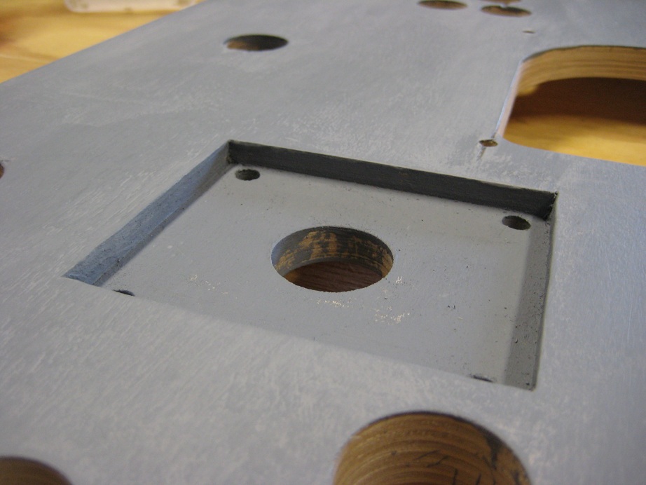

Then I redid the CP top control mounting holes and mortises - this time everything mounts from underneath.  Now I can stick down a CPO from mamemarquees.com and still be able to remove everything for maintenance if needed.  I picked up some supplies from the local paint store and started priming.

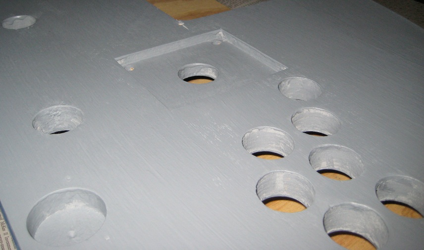

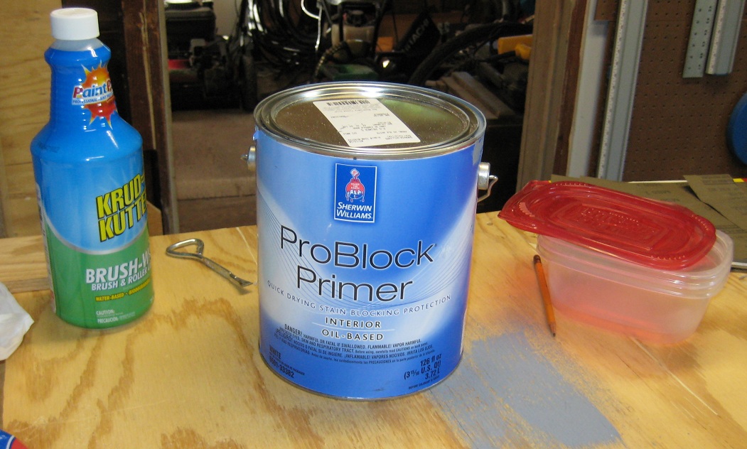

I am no expert painter, so I was expecting this to be a bit of a learning curve.  But it was even trickier than I thought it would be.  The garage is so hot that the paint was drying faster then I could get it on.  I also over worked the paint, I've learned since to not keep brushing over an area once I have the paint down.  It turned out pretty sloppy, but I was able to sand it down to decently smooth after it dried with some 220 grit wet/dry.
After some research, I went back to the paint store and picked up some Penetrol.  http://www.flood.com/paint-additive-solutions/products/view-product.jsp?productId=11  It's supposed to make oil-based paints smooth out better and I think it worked pretty well.  I also learned how to improve my technique a little bit.  The second coat turned out better - it's drying right now and I think it will sand out nice tomorrow.  But I've decided it's not all my fault for sucking as a painter - there's only so much you can do when the garage is over 100 degrees   ::)   I might have to do the top coats inside to get the results I'd like to see...
Then I cut a piece for the front, laminated it and started in with the kerf cuts.  I'm just doing this with a circular saw and a straight edge clamp.  And that's where I got hot and decided it was time for a break  ;D

So I learned some things this weekend...
One of the most important lessons I learned was that painting is the very last step!  I got ahead of myself and thought I'd get it painted up and then finish the laminate and some other minor details.  I'm sure someone with more skill and experience might have pulled it off, but for me applying the laminate first would have made a lot more sense, since the laminate is much more durable.
Since I am about to re-embark on an adventure of weeks of priming, painting and wet sanding, I thought I'd mock up the work I have so far.  Something to keep me motivated to the finished product.    :cry:   The top looks all scuffed up, but that is really just primer is showing through where I sanded everything back down smooth.  I love the GGG coin buttons and the Galaxian green t-molding is sweet.
Kidding aside, I'm actually really happy with this so far.  Sure, it's slow going but I've never really done anything like this - the list of "this is my first time trying to do _____" is pretty much the list of every step of work done so far.  My design is coming to life and I'm digging it!   ;D
PS the other thing I learned is that lacquer thinner is really nice to have if you want to get rid of excess contact cement on your laminate!

Two coats of primer on, and dried for 3 days.  I'll sand it down this weekend and put on 3 coats of black.  Painting is so slow!!!   :hissy:

The paint job is progressing.  It's funny, I just had no idea how slow it is to attempt a decent paint job.  The primer is all on, cured out and (mostly) sanded down.  I have to sand the underside of the CP lid.
The top of the CP lid is finsihed.  I'll leave it with just sanded primer until I get the "Totally Amazing Custom Opt2Not Control Panel Overlay Design" (tm) printed and stick it on top.   ;D
So I'm ready to paint the underside of the CP lid and the inside of the CP box.  I'm hoping the new high density foam mini roller and my slightly improved painting skills (don't overwork the paint!!!) will make for better results this time.
