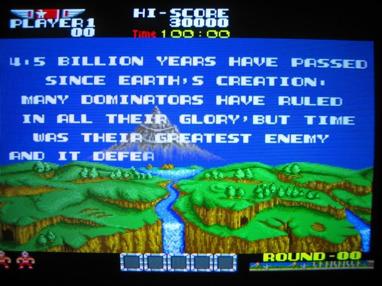

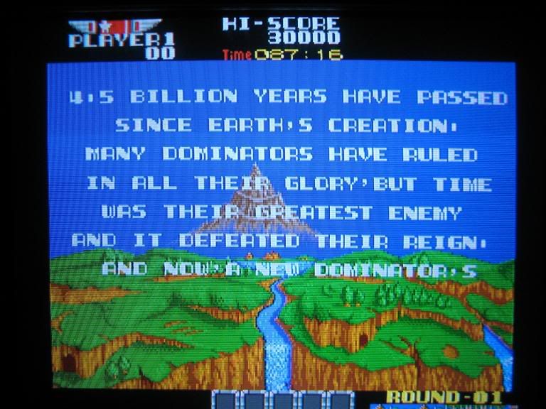

Agreed.  Also agree with other posts - it will also depend on the TV & the vid card.  I've been running my cab thru s-vid since day one.  No complaints & I also think it presents a pretty authentic classic arcade experience.
The bottom of my cab page (link in my profile) has several screen shots of my cab using s-vid for a reference if you wanna take a look.
My main point was in comparison to Component. On its own without component to compare against, S-video can look *ok*...have you compared the two yourself? Just curious.
Don't forget that there are also vast differences in the TV-out circuitry quality in video cards.  I've seen horrible looking S-Video from one card and pretty damn good from another.  It's been a while, but I had better luck with ATI/Radeon cards.
As for Ati/Nvidia...I compared both on my Sony TV and the S-Video quality wasn't much different to the eye...but the component on both of the same cards was much better than either S-Video signal.  The main difference was colour separation. The colour separation most approximated the RGB from the arcade.
I still have all the hardware from my original configuration: The Sony TV, The video cards, break out cables etc. I should do an updated comparison with my HDTV camcorder to highlight the differences. I could show them from Composite through S-Video, Component and finally Arcade. I know there are static pictures but maybe the footage will highlight what differences I see visually.

Here is one last comparison. I found a component picture (one I took on my first cab after I had switched from S-Video to Component) and took the same shot of the same game (Rygar) on my Arcade monitor in native RGB.
First of all the component picture is noticeably better than the S-Video one (ill try to get one up on a separate thread). Notice the differences though even between Component and RGB when people say component is as good as it gets in North America when you don't have RGB you realize just how drastic the differences are:
- Much better colour saturation
- Image isn't compressed (TV out image is compressed horizontally)
- Colours are much sharper and more vibrant (yellows and reds in particular)
- Text is crisper
- Sky actually looks like a blue sky
- Cliff shading isn't washed out and the mountain in RGB looks much better
- Look at the range of green in the RGB from the left grass/trees to the right now look at the component
Again this is component compared to RGB not S-Video...with S-Video there is even more contrast.  This is the only reason I brought up my initial reply, not to be an arse but to question the people who make statements like "S-Video is almost as good as RGB"...sure just like horseshoes and hand grenades are both items you can throw.  :o Ok...THAT was an arse statment ;)
Component Rygar
Native RGB Rygar
« Last Edit: April 18, 2010, 11:35:27 pm by Epyx »
