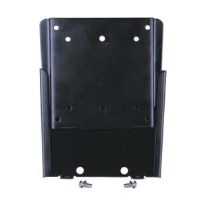

I ordered my LCD wall mount from dealextreme.com for like $9usd shipped.
I moved the mount lower by 1cm since I took these pictures but works quite well.
