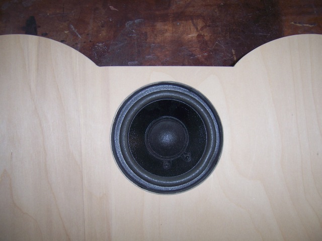

Small amount of progress lately.  I've been working on the bondo and sanding...slow progress, and I can't seem to get much time to work on it.  Lets start off with a couple tools of the trade I've been using-
If you notice on the right hand side of the picture, I have a homemade bondo spreader.  It's just a scrap piece of laminate that I've semi-rounded the edge over on and it works surprisingly well for spreading bondo.  Good news is that if it gets too messy or breaks, you can easily make another!
I started with a pretty thick coat of bondo all around the speaker area.  After a quick sand over, I then began to skim the entire area around the cab with a second coat.
After quite a bit of sanding, including electric random orbital, and hand sanding, this is what it looks like.
I think that last pic might have been after 3 coats, can't remember, it all kind of blurs together  :dizzy:
I guess this weekend will involve buying some glazing putty and filling all the small imperfections including air pocket holes, cracks, etc.  To make sure I know where all these spots are at, I made some pencil marks around the bartop.

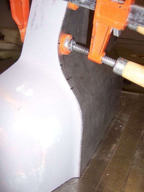

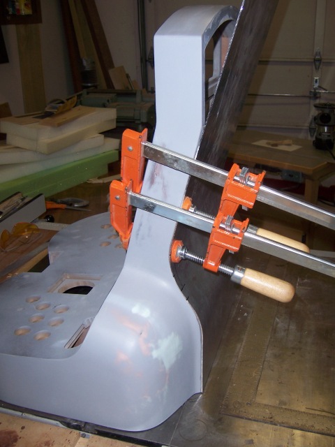

Next challenge was to begin the bending and forming of the aluminum back for the bartop.  It's a little over 1/16" thick so it doesn't like to cooperate when trying to bend, but I was able to use a 3.5" pvc pipe, a 2x4, a workbench, and some clamps to get the job done.  It's taken over an hour to get to this point, but it's getting there, the hardest part is keeping the bends parallel with each other and the bends smooth.
Here is a close up, the clamp is lightly holding the aluminum against the cab side-
I'm hoping that when I get to the curved top of the cab, my router bit won't have trouble cutting through the aluminum.

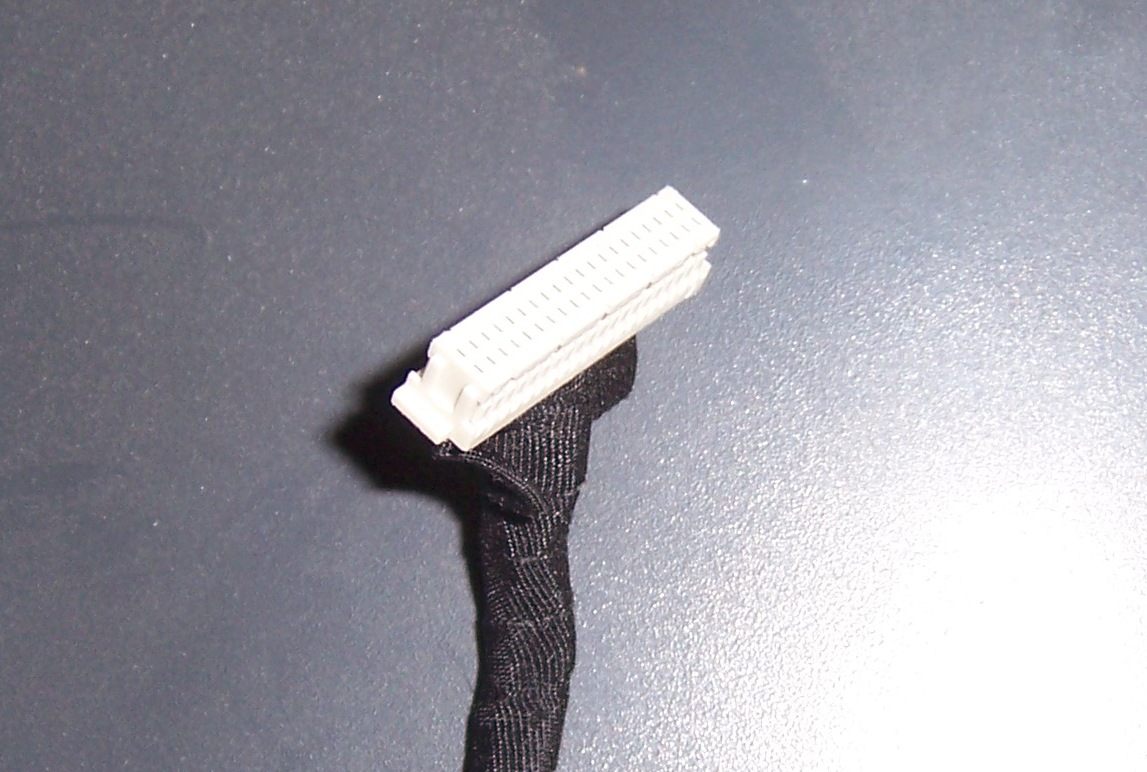

On another note I'm struggling to decide if I should update my pc specs before I go any further.  The dilemma right away is the monitor connection though.  The original connection seems to be labeled as LVDS and it looks like this-

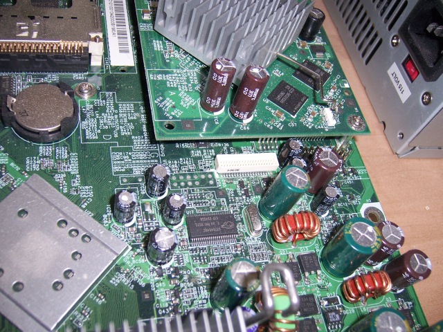

It connects to the motherboard close to the video card shown here in the pic-
After doing a little research, I think that there is a LVDS to DVI converter but I'm lost in all of this so I could use some input from you guys.  Is it worth it to go this route?
Also, I've been out of the loop when it comes to pc parts and combos...can anyone suggest a reliable build that would include a micro atx motherboard, low profile video card, micro power supply and RAM etc. Main thing is for the parts to be small enough to fit into the cab with it's limited space and to keep the price down (hopefully under $300), the video card and processor don't have to be top notch, just enough to future proof. (core 2 duo or equivalent) I get lost when I go to Newegg to look around so anything you can suggest will be helpful.  Something low wattage to keep heat down also would be nice...use your best discretion  ;)

Not a big update but I worked on the bottom a little this afternoon.  I ordered some perforated aluminum (about 1/16" thick 5/32" holes) and will use it for the speaker grills and pc fan covers.
Then I used my router to make 2 holes near the speaker sub cutout to allow 2 air inlet fans to circulate fresh air.
The reason I rabbeted out around the bottom of the holes was to allow the screen to set flush with the bottom.  I am going to laminate the bottom instead of just painting it to give it more strength and better wear resistance.
Here is a quick view from the bottom.
