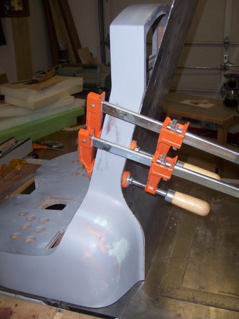

Small amount of progress lately.  I've been working on the bondo and sanding...slow progress, and I can't seem to get much time to work on it.  Lets start off with a couple tools of the trade I've been using-
If you notice on the right hand side of the picture, I have a homemade bondo spreader.  It's just a scrap piece of laminate that I've semi-rounded the edge over on and it works surprisingly well for spreading bondo.  Good news is that if it gets too messy or breaks, you can easily make another!
I started with a pretty thick coat of bondo all around the speaker area.  After a quick sand over, I then began to skim the entire area around the cab with a second coat.
After quite a bit of sanding, including electric random orbital, and hand sanding, this is what it looks like.
I think that last pic might have been after 3 coats, can't remember, it all kind of blurs together  :dizzy:
I guess this weekend will involve buying some glazing putty and filling all the small imperfections including air pocket holes, cracks, etc.  To make sure I know where all these spots are at, I made some pencil marks around the bartop.

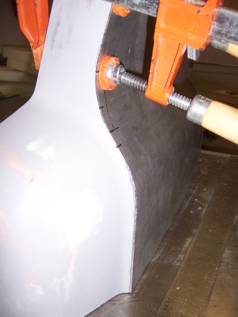

After taking a break from the graphic area of the cab (it's giving me a headache!!), I started work back on the finishing of the bartop.

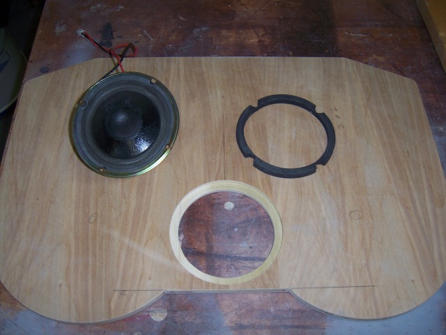

Small problem when I went out into the garage tonight. We've had alot of rain lately and after forgetting that my garage door leaks a little in the corner, and leaving my mdf bottom of the cab on the ground...well you know what happened-
The edge swelled and I had to recut the piece. I was out of mdf and so opted for 1/2" ply which works better in the long run for attaching everything to it-
After that small mishap, I was able to focus on the priming. After 2 coats of primer I was left with-
After those two coats were applied, there were still many pin holes from air bubbles in the bondo, so I sanded it back down in those places.  I won't spray it again until most of the internals are worked out, just in case I scratch or nick it in the process of fitting things in it-

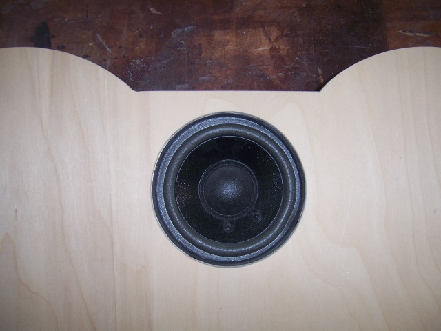

Not much progress for quite awhile now because of life and new job transitions, but tonight I was able to tinker a little.  I went ahead and routed out a circle in the bottom ply piece for the computer sub.  The entire cab will be on rubber feet so I'm hoping it will sound decent pointed down close to the front.  The pic shows the hole from the inside of the cab.  It has a small rabbet in it to accept the rubber gasket around the sub.
And here it is from outside the cab looking at it-
I'm still deciding on what type of speaker grill to use to cover this sub and the smaller ones in the curved area, maybe the perforated metal many have suggested in the past...I just need to look around the hardware store to see what I can find.
Next challenge was to begin the bending and forming of the aluminum back for the bartop.  It's a little over 1/16" thick so it doesn't like to cooperate when trying to bend, but I was able to use a 3.5" pvc pipe, a 2x4, a workbench, and some clamps to get the job done.  It's taken over an hour to get to this point, but it's getting there, the hardest part is keeping the bends parallel with each other and the bends smooth.
Here is a close up, the clamp is lightly holding the aluminum against the cab side-
I'm hoping that when I get to the curved top of the cab, my router bit won't have trouble cutting through the aluminum.

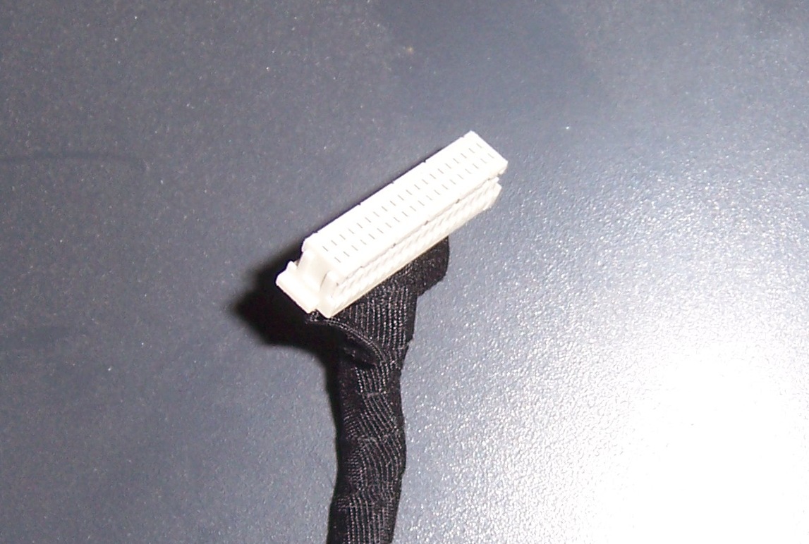

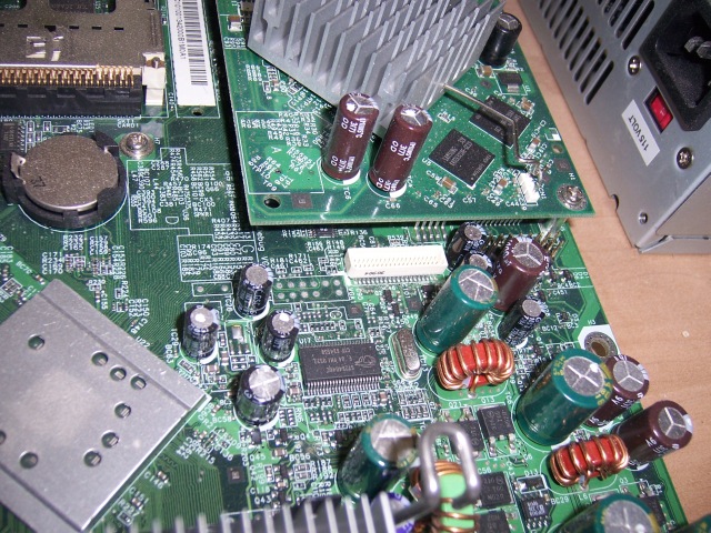

On another note I'm struggling to decide if I should update my pc specs before I go any further.  The dilemma right away is the monitor connection though.  The original connection seems to be labeled as LVDS and it looks like this-
It connects to the motherboard close to the video card shown here in the pic-
After doing a little research, I think that there is a LVDS to DVI converter but I'm lost in all of this so I could use some input from you guys.  Is it worth it to go this route?
Also, I've been out of the loop when it comes to pc parts and combos...can anyone suggest a reliable build that would include a micro atx motherboard, low profile video card, micro power supply and RAM etc. Main thing is for the parts to be small enough to fit into the cab with it's limited space and to keep the price down (hopefully under $300), the video card and processor don't have to be top notch, just enough to future proof. (core 2 duo or equivalent) I get lost when I go to Newegg to look around so anything you can suggest will be helpful.  Something low wattage to keep heat down also would be nice...use your best discretion  ;)

Not a big update but I worked on the bottom a little this afternoon.  I ordered some perforated aluminum (about 1/16" thick 5/32" holes) and will use it for the speaker grills and pc fan covers.
Then I used my router to make 2 holes near the speaker sub cutout to allow 2 air inlet fans to circulate fresh air.
The reason I rabbeted out around the bottom of the holes was to allow the screen to set flush with the bottom.  I am going to laminate the bottom instead of just painting it to give it more strength and better wear resistance.
Here is a quick view from the bottom.
