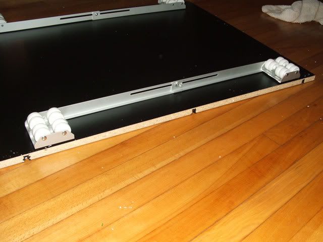

amadama
  • Posts: 201
  • Last login:September 29, 2019, 04:44:52 pm
Re: What size casters does everyone prefer?
« Reply #25 on: May 07, 2008, 01:20:35 pm »
This is how I put mine in (recessed):
Swivel on in front. Fixed ones in back.

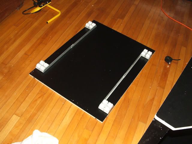

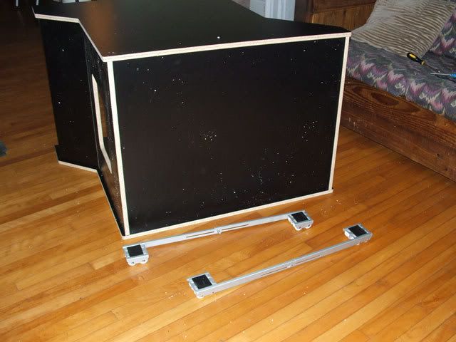

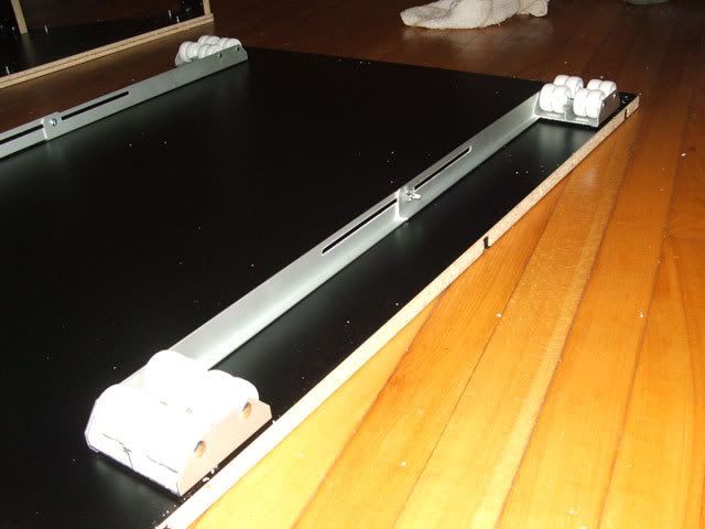

I wanted to add a very simple 'duh' discovery I had with my casters causing rocking under certain circumstances as mentioned by GinsuVictim above.  I tried pointing the two front wheels outward (they were pointing toward the front/back from all the moving of the cabinet).  I couldn't believe what an improvement that gave in the overall stability of the cabinet.
