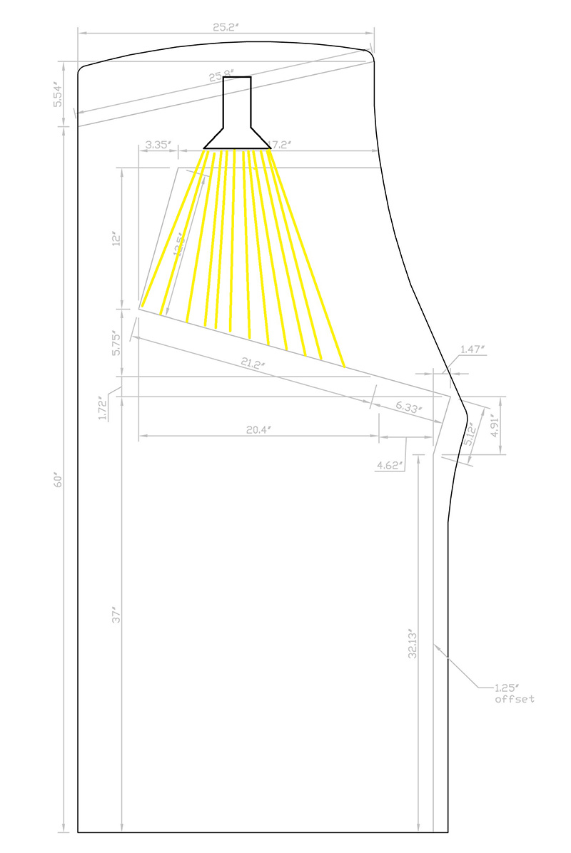

« on: September 30, 2015, 06:00:52 am »
So would this work with a short throw or ultra short throw projector?  :dunno

« Reply #7 on: September 30, 2015, 10:04:28 am »
The other issue you'll have to contend with is light spilling over onto your projection surface, dulling and dimming the image.
If you really wanted to do it, rear-projection would probably be better.

« Reply #9 on: September 30, 2015, 11:39:28 am »
It could be done, but the big concern I'd have would be ambient light.  Projectors need dark environments otherwise the image will be very washed out and difficult to view.  If you have an arcade in a bright room, particularly with natural light, then the projector wouldn't likely work.
OTOH, in a basement or dark rec room environment, it could work.

not as much heat.
But it would have to be rear projection in a sealed cabinet with the inside painted black & you'd need a large front surface mirror (you can make one from a regular mirror) or keep the projector dead on because you don't want to have to use the keystone settings as that lowers the resolution.
