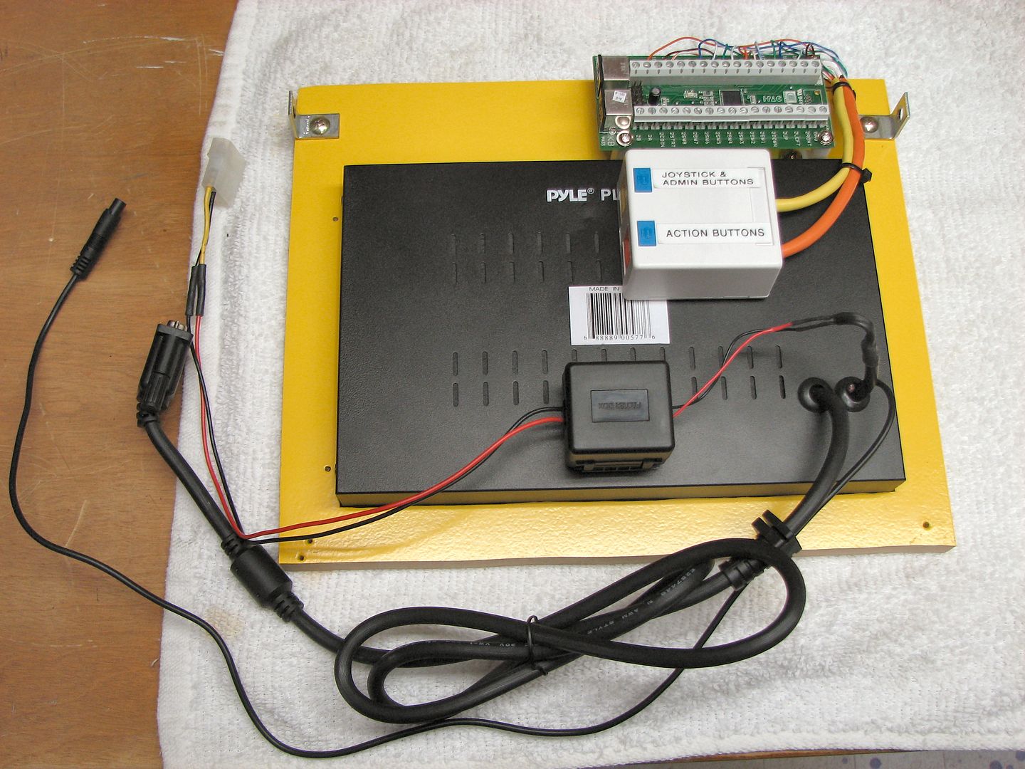

Okay folks. Time for another progress report. First off I have made a few modifications to the artwork. I removed the lines from the bezel art because they don't look right with the lines on the control panel.
I've received my LCD from Amazon and connected a Molex connector to supply the 12v from the PC's power supply.
I've de-cased the USB speakers I'm using and started preparing them for my cabinet making everything somewhat modular in case I need to take the thing apart:
I got the speaker holes drilled and routered out a smaller inner section where I will have these speaker grills I've cut from a couple small sheets I picked up on eBay:
I've mounted the control panel using screw inserts and some black hex head screws which look pretty nice:
I ordered these awesome little buttons from arcadeshop.de that I'm using for my Start and Pause buttons. Red button in the frame for size comparison...
I printed a player 1 character on clear laser labels and attached him to the white button. Then I used a clear spray paint to hopefully seal the printed little guy to the button:
Here's a shot with a full sized Player 1 button for comparison:
I couldn't help but try to see what the little buttons will look like with the control panel art. I have a printout of my artwork to use to help me visualize things. I'm liking it so far...

Well, I'm still making progress. Here's some more pics...
I got the edge on the control panel routered:
Also, I've been thinking about mounting the marquee. I found this edging stuff at Home Depot that should hold the marquee pretty good. Just need to paint it black.
I've got this little single socket travel surge protector that I've bastardized to connect to the power socket so I can connect one standard power cord to power the whole cabinet:
Also, I've been thinking about how I want to wire up the control panel. I found this surface mount box I had lying around and figured I could use CAT5 cable for my CP wiring. This way I can easily disconnect the control panel for removal if necessary:

I wanted to post some more pics showing the most recent progress.
The back of the bezel and monitor:
The underside of the CP:
The back door:
These really show what a tight fit it's gonna be inside. I still need to clean up the wiring obviously:
A nice shot of the control panel:
She's starting to look like my artistic rendition: :)
