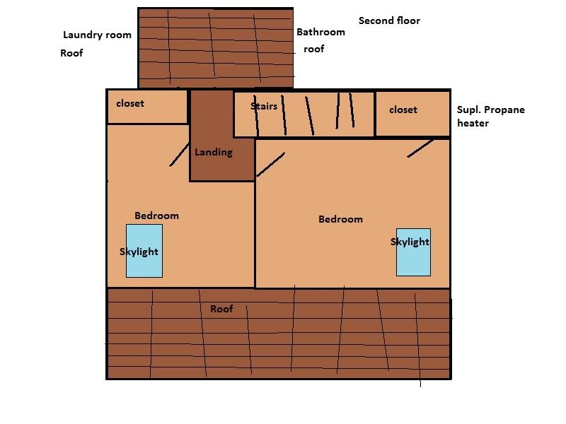

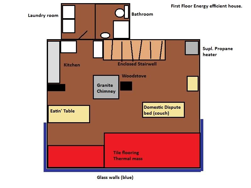

I am from Maine, and as a teen I lived in a solar house. it wasn't an A-frame tho. It had a cool design though...
Hello from Maine :) I see you escaped, I am still stuck here. I'd love to see pics of the passive solar home you grew up in.
...the whole south of the first floor and half of each west/east side were glass (with sliding glass doors as the main entrance). That section of the house had earthen tile floors (to trap sunheat)...
I think they call that "thermal mass"
...Before sunset the glass walls would be covered in very heavy curtains. The primary winter heat for the place was a central wood stove with the chimney encased in a massive rough granite chimney (so that the rocks would get heated and keep the place warm after everyone went to bed)...
That's very interesting! A wood stove with thermal mass :)
...The bedrooms were upstairs with only a small grate in each room to let the heat from the 1st floor up. Basically it had three rooms (2 bedrooms upstairs, and one big room that was "divided" by the granite chimney heatsink) and a small bathroom.
Each bedroom had large skylights that could be opened in the summer for cooling.
Nicest and most "spacious" place I have ever lived in. So there are more options than A-frames.
That's very interesting. I'd like to know all about that place and see the drawings for it :)

Well you asked for some drawings so here they are, in their crap-tastic MSpaint form!
One extra thing to note that isnt in the drawings is that the house was on the side of a hill with the south side facing the bottom, also there was a huge porch out front (south) to reflect light back at the house.

« Reply #23 on: January 24, 2010, 07:01:33 pm »
Bravo!
MS paint drawings have such character :)
And it's very informative :)
