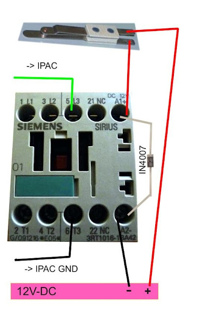

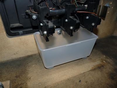

fine adjusted my 2 tilt-bobs, works very well now. check out the smooth nudging... you can nudge left and right separately.
here is a youtube-vid for you:
regards

so the bottom line is that the nanotech plunger/motion sensor sucks?
how sad.  i was so excited about using them too :(.
have u tried contacting them to see what they have to say about the problems?
also, these might be of interest:
http://www.toradex.com/En/Products/Oak_USB_Sensors
USB HID input sensors ... they have one for motion (bump) and one for distance (plunger).
sounds like u have your own replacement solutions in place now , though.

as I said, if there were a better software/firmware, it would be perfect (e.g. adjustable deadzones, manual calibration with fix values, the possibility to switch off motion seperatly and so on)... but try yourself to contact nanotech, in my case there was no attempt made to provide help   :banghead:  ;D
thanks for the interesting usb-sensors-link.

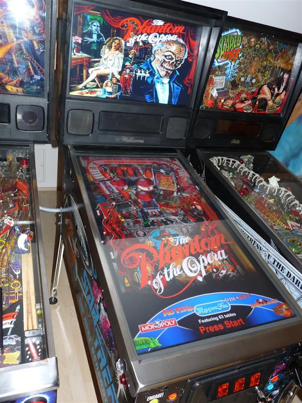

Installed Lord Hiruys "Phantom of the Opera" Table and made a custom mediapack... This table is awesome!
Tables are getting better and better  :)

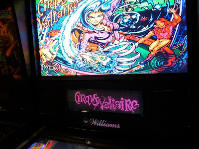

« Reply #92 on: January 22, 2010, 02:47:52 pm »
played around with the dmd-colors  ...  what do you think?
playing simpsons in "yellow" is simply awesome :D
regards
chris

Would you have any details on the tilt mechanism you used? I noticed you mentioned tilt bobs. Did you just use a normal bob and wire it for contact?
Or use one of the accelerometers that are now available?

Tilt bobs: they "only" detect whether or not the cab is being tilted/nudge right? not the magnitude of tilt/nudge.
How do you detect the tilt/nudge direction? Have you masked off different parts of the outer rings on the two tilt bobs?
Thanks in advance
Razzer
chris77
  • Posts: 184
  • Instant C
    • visual pinball
Re: 46" / 30" / 19" widebody fullscreen visual pinball project
« Reply #109 on: March 15, 2010, 05:09:38 am »
hey razzer!
yes, the tilt-bobs detect wheter or not, like pressing a microswitch. but the harder you nudge the cabinet, the more detections you will receive. so you have a tilt magnitude / sensivity.
the unwanted areas of the outer ring are simply masked with tape. works great!
cheers
chris

I think I'll go with tilt bobs (Considered using the U-HID G from Ultimarc).
Would you mind listing the make and model of the solenoid you used for flipper feedback?. That would give me an idea of which specs to look for.
I assume a simple solenoid is cheaper than buying an full flipper assembly (32,5$) like the one shown below.
Once again thanks in advance.
Razzer

the industry relay is cheaper than a full flipper assembly... and its easier and safer (12vdc) to install than a pinball solenoid.
--------snip---------
here is an "easy schematic ;) " to install the industry relay:
its better to use an extern 12V-DC poweradapter (I use an old solid 10amps 12V-DC poweradapter)  instead the pc-powersupply. its just safer.
there is electricity. do it only if you know what you do. I will take no responsibility for this.
here is a direct link to the relay
http://www.eibmarkt.com/cgi-bin/eibmarkt.storefront/EN/Product/NS0775599?PID=EN_NS0775599
some pics inside the cabinet...
cheers

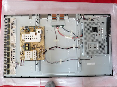

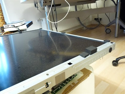

Could you please post the width of the decased 46" TV you used. Thanks.
chris77
  • Posts: 184
  • Instant C
    • visual pinball
« Reply #114 on: March 15, 2010, 11:46:25 am »
Chris,
Reko, I think it was 107.5 x 62.5cm decased,
cheers
Chris
