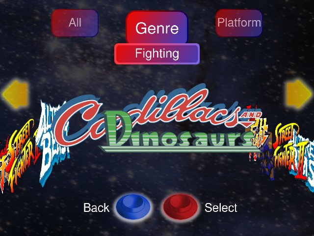

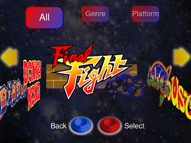

While thinking about my soon-to-be-built arcade cabinet, I started looking at front ends. As I couldn't find one that fitted my needs, I figured I'd roll my own. I wanted it to be completely graphical and have a simple interface that was easy to use with a joystick. Here's what it looks like just now (click for bigger images):
The top part is a simple menu from which you can select all games or filter based on genre or platform. More filters are easily added in code although I hope to make this configurable soon. After you've chosen a filter, the main part of the screen is used to display logos (or marquees, or other images, if you like) of the games which you can "flip" through in a groovy, animated kind of way, a bit like flipping through songs on an iPod. You can also specify a background image (e.g. a screen shot) for each game.
Just now it runs on Linux, as that's what I'll be running my cabinet on. It's written in straight C using OpenGL and SDL, so it shouldn't be hard to get it working on other *NIX systems or even Windows with a little work. If you want to try it out, the sources are here but be warned: it's still a bit rough around the edges! Feel free to ask any questions if you have trouble setting it up.
Cabrio FE - a free open source front end for arcade cabinets.

Re: Cabrio: New front end for cabinets
« Reply #1 on: October 20, 2009, 11:23:36 am »
Hello,
Please don't use fork() to launch your emulators. Use some kind of cross-platform thread library, such as Posix Threads.
http://en.wikipedia.org/wiki/POSIX_Threads
Also, what version of SDL are you using?

« Reply #5 on: October 20, 2009, 04:17:11 pm »
I got it partially working on Windows.
There's a segfault that needs fixing:
Code: [Select]
       if( emulator!=NULL ) {
int i;
struct config_param *prev_param = NULL;
const int num_params = 4;
const char *params[] = { "-nowindow", "-skip_gameinfo", "-switchres", "-joystick" };
            struct config_param *param;
emulator->id = 0;
strncpy( emulator->name, "mame", CONFIG_NAME_LENGTH );
strncpy( emulator->display_name, "MAME", CONFIG_NAME_LENGTH );
strncpy( emulator->executable, "mame", CONFIG_FILE_NAME_LENGTH );
            emulator->params=NULL;
            emulator->next=NULL; // <------- Add this
for( i = num_params-1 ; i >= 0 ; i-- )
                param = malloc( sizeof(struct config_emulator) );
                if( param!=NULL ) {
strncpy( param->name, params[i], CONFIG_PARAM_LENGTH );
Therer are a couple of other segfaults that happen when the game list is empty.
I'm not sure how to generate game lists.
« Last Edit: October 20, 2009, 04:28:49 pm by Cakemeister »

« Reply #9 on: October 21, 2009, 09:34:02 am »
Okay, I wrote a list generator. The FE works pretty well. The scrolling is smooth and framerates are good. You can use marquee images or else get the wheel images from Hyperspin and use those.
Your code is very clean and easy to read.  It was very easy to port to Windows. :burgerking:
A couple of suggestions:
1) Move the game list out of the main configuration file. If you want a single game list, add a "<gamelist>gamelist.txt</gamelist>" entry after the emulators, or maybe have a per-emulator game list tag within the emulator tag.
2) Don't have an application header file have the same name as a library header file. (SDL.h) Yes, the compiler should resolve it correctly, but some compilers don't.
3) I had some problems with the empty config file generation, and with the data directory. If you want to make the application more portable, you might look at those.
4) SDL is quirky when it comes to the main() function. To get it to run on Windows, I changed your main() to main_app(). Then I added a separate main() function in a different source file that does not include <SDL.h>, that calls the main_app().

« Reply #20 on: October 26, 2009, 03:43:31 pm »
Looks pretty nifty. That background reminds me of The Jetsons from the 60s. Not against it, though I would probly change it. I don't know as I'd keep the 'function' sounds, either, but I think they're about the most 'innocuous' of all I've heard on FEs.

« Reply #21 on: October 26, 2009, 05:53:50 pm »
Yeah, that will all be configurable eventually. Right now, everything is loaded from regular files (PNG, JPG, WAV) which are easily replaced until I get the options added to the config file.
I've put together a simple web site at http://www.cabrio-fe.org/ with downloads, screenshots and some basic documentation.
