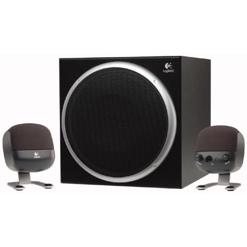

« Reply #12 on: October 02, 2009, 07:50:26 am »
I'm using the Logitech S220 2.1 only $24.99 on Amazon.com. The sound quality is great, I love them.
http://www.amazon.com/Logitech-S220-Speaker-System-Black/dp/B000RQSGYO/ref=sr_1_1?ie=UTF8&s=electronics&qid=1254495648&sr=8-1

Logitech Z 2300

I notice that a lot of people are recommending the Logitech z-2300 and I was wondering... does any one know how to extend the controller for these?  I would like to buy them but it looks like I would be stuck at 6' and I am trying to build a showcase cabinet so it really wouldn't work... any help would be appreciated...
It should be a breeze to extend the remote cable.  All you would need is some telephone wire and some solder/heatshrink or butt connectors.  Cut the whole cable, strip the wires, and patch everything back together with the desired length of telephone wire.
Come to think of it, you might be able to use a male-to-female VGA extension cable as I think it's the same 15 pin connector for the remote.  I'll try it out later and see if that's an option.
I wouldn't recommend that approach, as the remote attenuates the volume itself and has the switched headphone jack output - so the stereo pair will be going down the remote cable and back up again.  :o
If you just used telephone cable (CAT3 or even up to network CAT6), the stereo pairs would be unshielded and you'd have all sorts of nasty interference coming out of your speakers.
