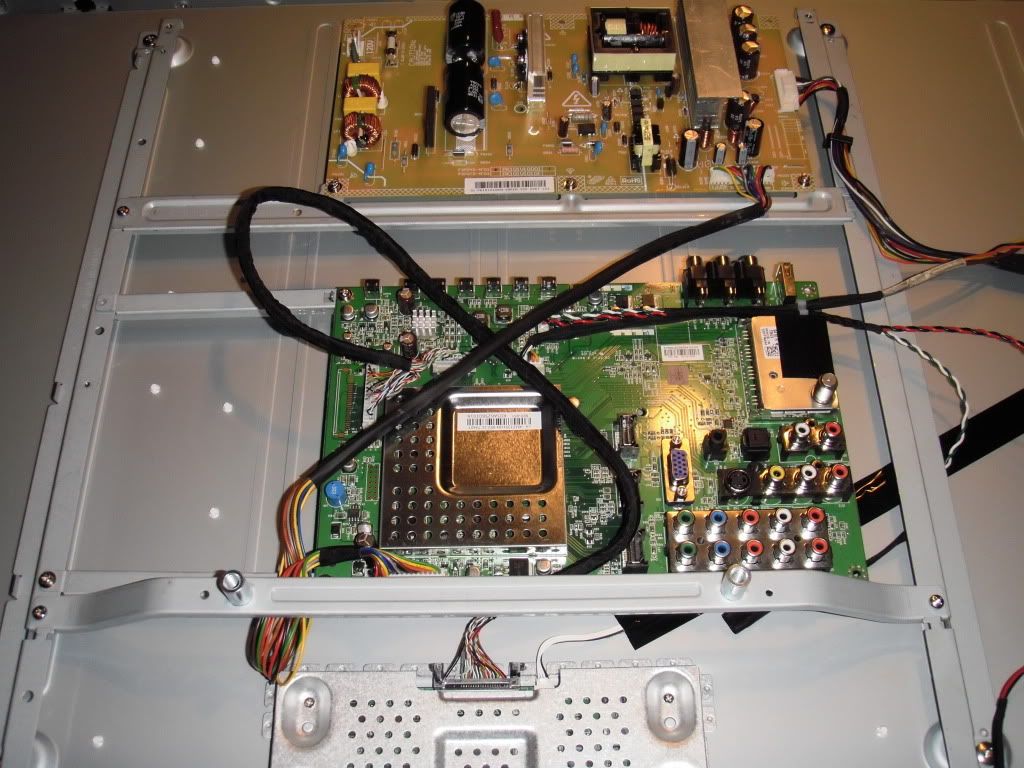

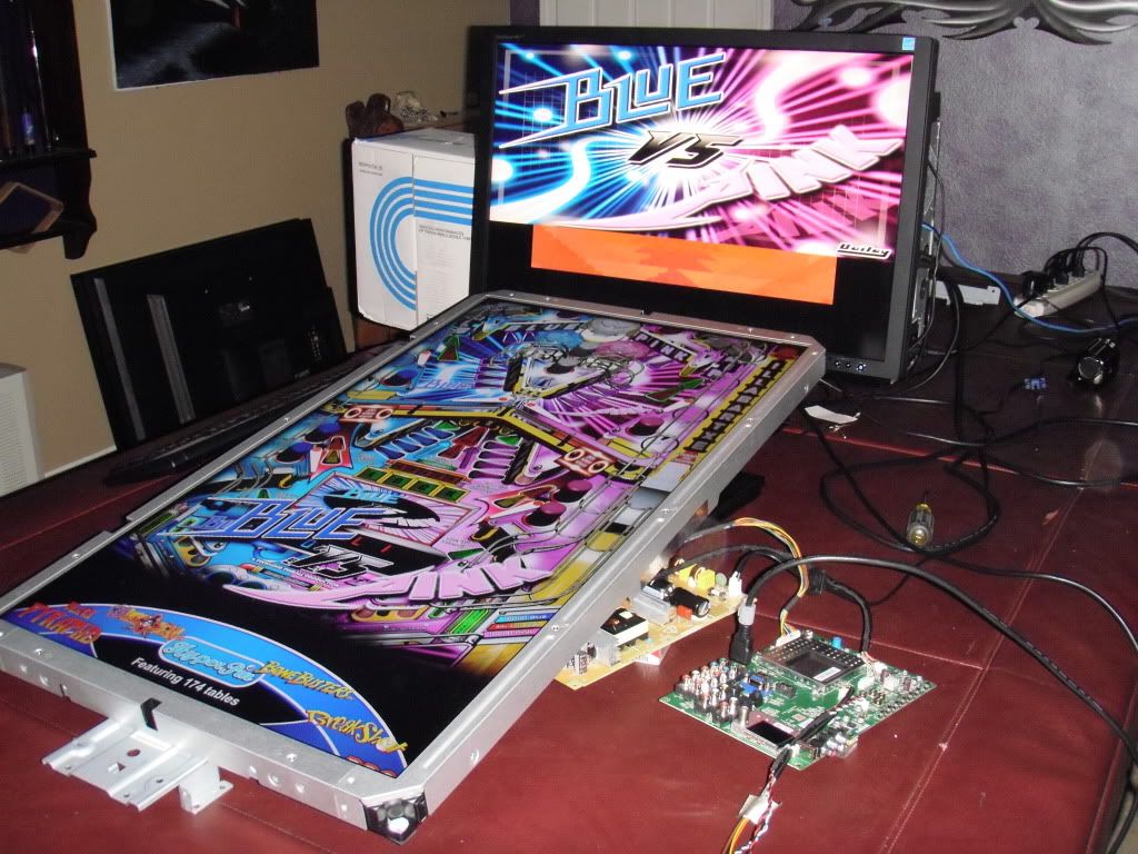

Started this projected about a month ago, and didn't know the first thing about VP or FP.  Just saw Badboybills, and had to create one for myself to finish off the game room!!
Started off with Taking apart a perfectly good ( and new, wife was pissed ) 42 inch LCD TV.
Then getting everything set up on the pool table with a 30 inch samsung monitor.
The next step was getting the box for my pintable laid out and started to take shape.
Then came the graphics, and putting everything together, The plunger, buttons, ect ect
Still have the DMD board to finish up, and the backglass.  Heres a little video featuring Dreampin in action =)

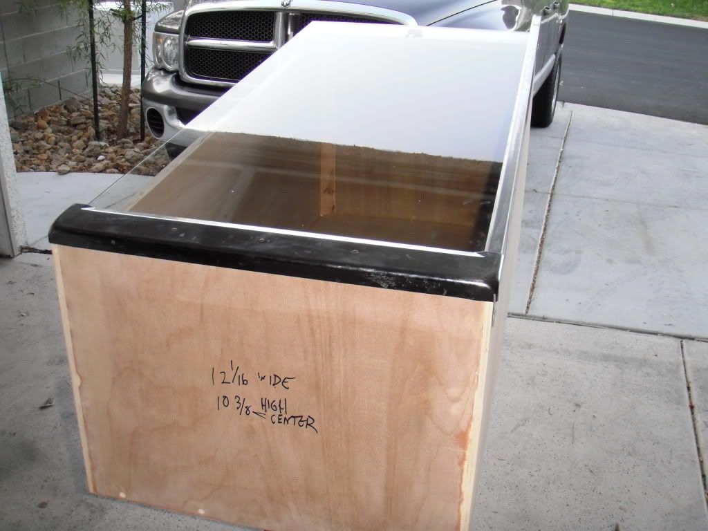

Adding more "Depth" to it, I would have had to sink the LCD monitor into the cab, instead of on top of the cab, thus adding another 2 inches on "Bezel" to the playfeild...
I prefer no bezel to depth.
H4CK3R
Does that mean that the display is actually the top most piece? You don't have a protective top glass over the actual display itself?
I can certainly understand the desire to not want to have to make a bezel. Heck I still have my arcade machine that I built 4 years ago sitting here without a bezel and front glass, simply because I haven't felt like measuring and making the bezel (some kind of serious don't want to do it mental block).
I figure a bezel for that would be extremely easy to do though. Just frame it with plywood, or heck even masonite.
I wouldn't want what is probably the most expensive part of the whole thing sitting there so exposed, plus you then get that whole depth thing.
Still though. Very nice machine, and if I was standing there playing it in person, I am sure the wow factor would go a long way in making me overlook the little things that a msg board allows me time to nitpick. ;D

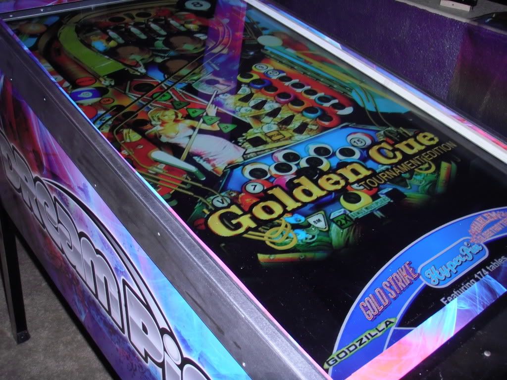

has custom cut glass over it... this is how it sits with glass on top
no glass yet..
Glass no LCD...
Glass with LCD
H4CK3R
