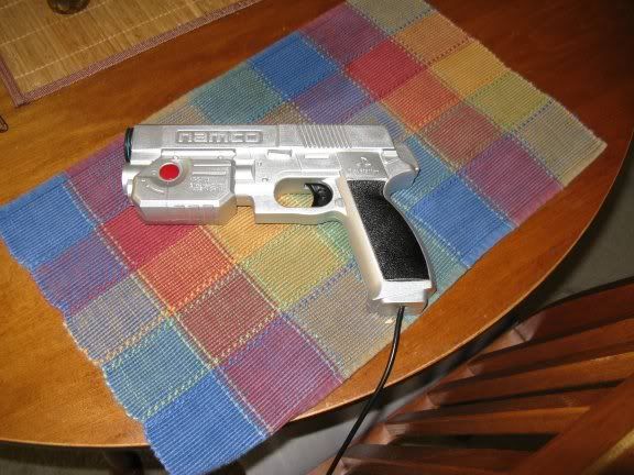

The PS1 Guncon was recommended as an easy hack, and I had one lying around.  I was finished putting it together in an afternoon.
