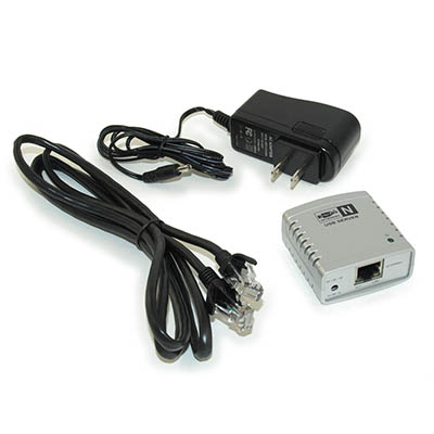

I'm wondering if something like this might work to make these wireless
http://www.mycablemart.com/store/cart.php?m=product_detail&p=1513
It's 5vdc powered so theoretically, a battery would do it. It looks to be reasonably small, but I'm not sure it could all go in a pistol sized shell.
And it's a tad $$, but no more so than the Aimtrak itself.

Keep in mind that wireless is pretty power hungry since it has to transmit stuff all the time.  I think you might be better off trying to find something blue tooth than 802.11 since it's meant for low power devices (headsets, phones, etc.).
