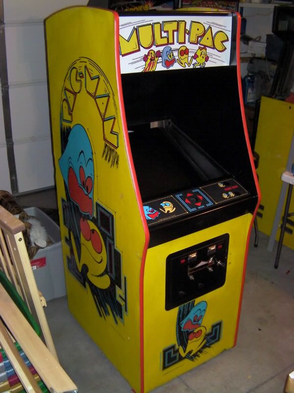

FrizzleFried
  • Posts: 5159
    • Idaho Garagecade
Re: New Pacman - Have questions...
« Reply #8 on: September 15, 2009, 09:34:11 pm »
Here's a "New Pac Man" I am working on...
...well,  not new...
