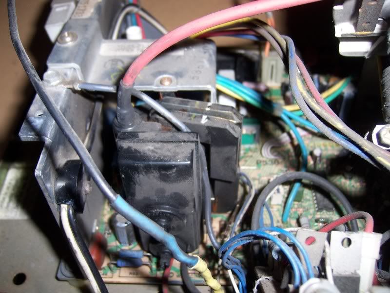

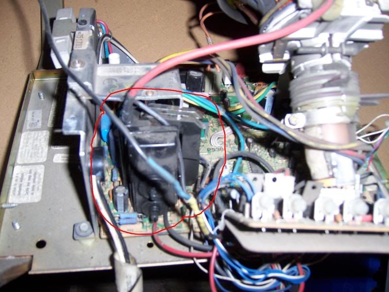

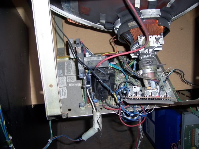

hi i have a street fighter alpha system, and when i went to turn it on i heard a loud sparking noise, so i took the back off and found that the coil is arcing on the mounting bracket and just sparking in general what can i do to fix this? i would rather get a whole new board then try to solder/unsolder the coil. i can post pics tonight if you guys need.

thats whats sparking im pretty sure it the coil

That is a flyback transformer.  If it is arcing you should replace it.  Doing so will require you to discharge your tube first though.

Re: coil arcing?
« Reply #9 on: August 27, 2009, 01:54:05 am »
It's a Wells-Gardner k7000 series and it definitely has a bad flyback.
Kevin Mullins
  • Posts: 4504
    • Me on Myspace
Re: coil arcing?
« Reply #10 on: August 27, 2009, 12:33:39 pm »
Ditto ..... Wells Gardner K7000
And that flyback looks like it's been wacked.
Along with the neckboard not completely seated.
Common monitor, parts readily available, easy to fix.

is it just me or is the core on that flyback kinked off to the side?!?! it looks busted.
lows10blazer
  • Posts: 12
  • Last login:March 11, 2010, 03:09:03 pm
Re: coil arcing?
« Reply #23 on: March 11, 2010, 03:09:03 pm »
ya i moved it and ya the flyback is busted
