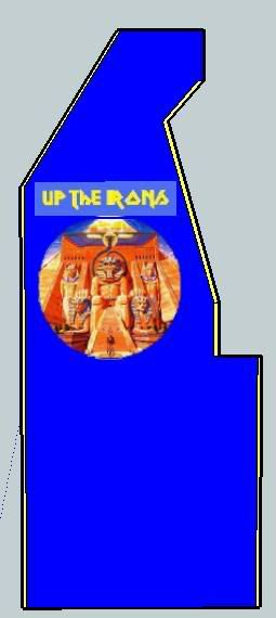

Lol I would go with an Iron Maiden theme and use the Swedish flag colours like you have in your avatar...blue sides with yellow T Moulding and a cool Iron Maiden marquee (was thinking of this myself at one point)...do the lettering in the Iron Maiden font:
http://www.maiden-world.com/articles/iron-maiden-fonts-typography.html
For Side art you have to go with Eddie...I would go with an album cover that matches the colour scheme of the Blue/Yellow Swedish colours...and what better album than Powerslave? It has blue and yellow in it as well which would look awesome.
The 10 second photochop is bad but you get the idea:
http://www.solarnavigator.net/music/music_images/Iron_Maiden_Powerslave_Egyptian_pyramid_album_cover.jpg
The marquee would be blue with yellow text and another great Eddie/IM art overlay around the words. ;)
http://i210.photobucket.com/albums/bb312/epyx_photo/IMCAb.jpg
Interesting.... But wouldn't that mean that I could only play "Ed Hunter" on it? ;D  http://www.amazon.ca/Ed-Hunter-Iron-Maiden/dp/B0000257HB

Kman-Sweden
  • Posts: 526
  • Up the Irons!
Re: Kman_Sweden - First arcade cab build. 2009-09-15
« Reply #54 on: September 15, 2009, 10:50:14 pm »
your dad might not want to part with it,seeing as he does most of the work.
 :laugh2:
;D Trust me, he just wants to be able to park the car in the garage before the snow comes.  ;D
I just don't have arms long enough to get myself in all the pictures when I'm holding the camera. But you can see the top of my head in the latest pic.
I'm painting with a brush and he was going over the paint with the roller to smooth it out.
what colors,any artwork?
Black and blue. Still no CP art but I've done a marquee. If you'd like to see it follow my URL below and it's on top of the page. (Amazing Arcade, working title)
