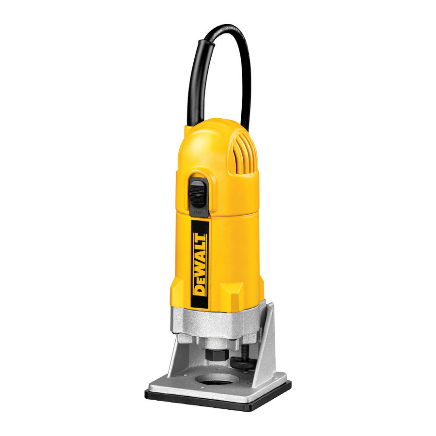

Re: Laminate Trimmer and MDF
« Reply #19 on: August 27, 2009, 04:08:37 pm »
$80.00, but well worth it.  I've had my DeWalt laminate router for 10+ years with zero problems.

http://www.amazon.com/Bosch-PR20EVSK-1-Horsepower-Variable-Router/dp/B000ANQHTA/ref=sr_1_1?ie=UTF8&s=hi&qid=1251484551&sr=8-1
I really love my Bosch laminate router. Its 109.00 and worth the extra 30.00 over the dewalt, the adjustments for height changes are way easier and you can do micro adjustments very easily.
