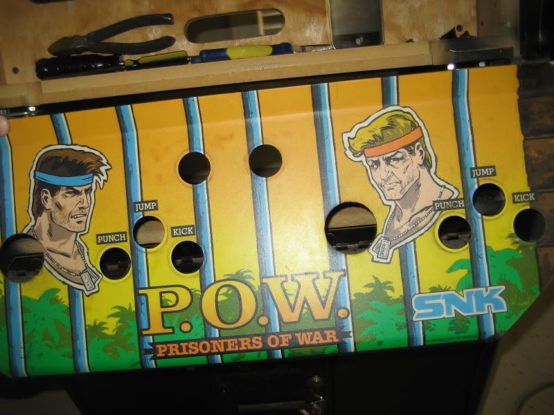

I really wanted a CP with a trackball, but if I use the original, it probably won't fit.  I think I can live without a trackball for now but I definitely want to build a custom CP for it later down the road.
What I'd like to do is take that and bondo the holes and do a 2 player, 7 button layout, with a couple admin buttons.   I wasn't expecting this CP to be metal though and I dont' know where to start.  Would bondo fill in the holes?  What would I use to drill new holes?
My Rolling Thunder conversion (currently underway) uses a metal control panel. I have a friend who works in a manufacturing plant, and he had access to a punch press. Once I was able to get him the correct die size, he was able to punch the new holes I needed. Then I took it to a local metal shop and slipped the guy a $20 to clean up all the burrs, rough edges, etc. The guy even sandblasted it for me.  ;D
There were also holes in it that I did not need any more -- that's what I'm working on now. I was going to use the punch blanks to fill them, but instead I'll be using some 2 part Epoxy to bond a small square of plexiglass behind the hole. Then I'll level it off to the panel by filling it with bondo, sanding it smooth, & covering it all with my CP overlay. Why plexiglass? It's strong enough to hold up to random pressure without flexing much, yet it can be removed (or at least drilled through) should I need to make any more changes in the panel layout.
For a DIY approach, your best bet for cutting the new button holes in your panel would be this:
http://www.amazon.com/MK-Morse-AV18-8-Inch-Bi-Metal/dp/B000E8HTWK
You'll need the matching arbor to go with it (link is further down the page), but you can get both for just under $16. Just make sure you use a drill press (a good strong one...) and use cutting oil.

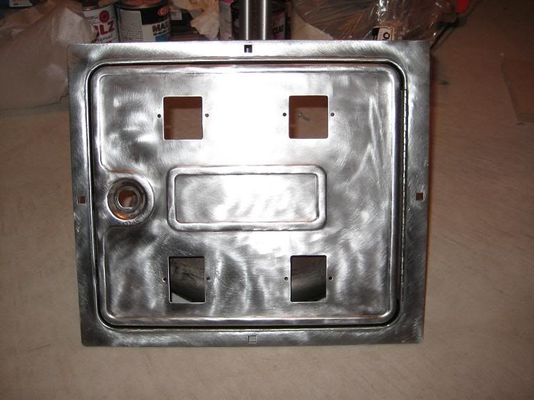

To answer your question on the CP first after using lots of elbow grease, Goo Gone and a razer blade  to scrap I then used a wire drill bit brush on a high speed drill to get the metal smooth and some shine to it.
I switched sizes and once the metal gets short you have to switch otherwise it gets dull.
end result:
Then to get it to be a mirror finish I used a ton of German Metal Polish compound (any will do) and a polishing bit on the drill.
Then Sprayed it with Auto Paint black
Its dirty here so the mirror finish can't be seen well:
Ordered a custom made and cut overlay from Arcadoverlays.com (mine was a bit taller) They are HIGHLY recommended.
The back has and adhesive and used the soapy water trick to get it positioned just right.
The plexiglass was cut on a laser engraver. I think when it need replacing I'll order some lexan and drill it.
If you get a MiniPAC or IPAC from Andy at Ultimarc then you really dont need any admin buttons, the shift function allows you to do anything you would like...
IE, press an hold player one start and push player one button to enter coin credits. Hit Player one and player two start and the same time to exit.
I map out the Tab button and volume control slider in mame for changing stuff on the fly in MAME.
You could design a reproduction of the CP POW SNK artwork that is laid out for the six button street fighter config and it would still look original.
Just an idea.

Just to give an idea of a reproduction that is changed to adjust for six buttons. Again with a minipac or using a JPAC for jamma you can have shift functions for the front end (HS or what ever) and still make it look as first sight to be original.
Just need to find a high quality scan of the Original POW CP artwork.
This is just a quick PS for ideas, its by no means a quality Photochop.
Later a glowing trackball recessed and placed where the "O" is in POW on the CP would be interesting.

I think he means one kind of like this
You can use one kinda like the center one in a drill press to jewel a piece of metal kinda like you have seen on the spirit of st Louis or on some pistols
http://www.3me.us/jewelling.htm

Yes they should be available at Home Depot. the one on the left in the above picture is the type that i used. Just keep it smooth and moving, replace when the bristles get short. Must use a drill that plugs in, it won't work with a cordless.  Borrow one.
Clean all the adhesive off of the panel... Lots of goo gone and a rag with a ton of WD-40 is supposed to work. Goo Gone works well.
Buy a ton of the razor blade scrappers as they break easily.

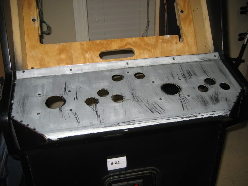

great advice slade! I actually just removed the graphics off the CP last night.  I bought a cheap heat gun at Lowes and it took me about an hour to get the laminate (was it laminate??) off.  Then I cleaned up with GooGone and a scraper.  Worked really good.  The GooGone with the scraper would pull layers of that adhesive up at a time.  Here's the final result:
Before
After
All the adhesive is off and it is smooth. I'm going to pick up a wire brush drill bit today to polish it up a bit

Ya those brass drill bit brushes make short work of paint/rust:
Took about 20 mins and barely broke a sweat.

I got it brushed pretty well. Got pics coming.
One question, should I start a thread in the projects forum?  I know I'm going to have tons of questions and I wonder if it would make more sense to put all of this there?

Well I would recommend preserving as much of the artwork as possible.  You never know, P.O.W could be someones favourite game and they are just missing that last piece...  This comes from a Champion Wrestler fan who has spent years collecting whatever original pieces as are available...
I'd LOVE a POW. I used to drop many a coin into that game. I have a photo of me somewhere 'back in the day' playing one of these. Such a shame to convert it  :'(
My Project MAME clone
my control panel is the same as this one, and it was converted at one point and what they did on mine was they cut out the old button layout and tack welded a new piece of metal on top. then they drilled new holes in the new piece and covered the cp with plexiglass.
ya wire wheels work pretty good, i dont have a corded drill but i have a rotary tool.
i bought some stainless wire wheels the other day from harbor freight, they work but man it's a lot of work.
im working on the same type of coin door, the backside was just covered in rust, i mean big flaky rust.
i thought the rotary tool would be good to get in those nooks and cranies and it is but damn it's taking forever, a lot of that is probably beause of the complexity of the mech holders.
anyway whats the recommended way to strip the paint on the front.. i've heard some people have done it with heat guns, others use chemical strippers.. of course there is the wire wheel approach.
thoughts?
If your planning on using it for other things down the road, and you probably will,
get a Blast cabinet from harbor freight. thats the best way to get down to bare metal on any odd shaped piece like a coin door for example.

Can anyone recommend a good bondo to patch up the holes?  I've never had to do it before    :notworthy:
