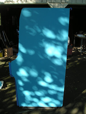

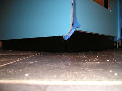

Next up was applying the powder blue paint on the sides and front of the cabinet. The goal here was to apply several thin coats in order to achieve as flat of a finish as possible. The smoother the finish, the nicer it looks and the better chance I have of actually putting this thing somewhere in my house.
I went to Sherwin-Williams to get some high quality paint and I think I got some good stuff. You can get the formula off of the picture.
I was going to get an oil-based product but due to environmental laws in my area they could only sell me a quart and on top of that they didn't have the right base for the color codes I had so I ended up going with latex. The guy assured me that it was their flagship product and it would dry nice and even (which it did).

And here are some decent shots of what the cabinet looks like after applying two coats of the powder blue paint.
It's funny how the color looks different depending on the lighting but it all looks real even in person. Hopefully the sideart will go on nice and smooth - I'm nervous just thinking about it.

 :applaud: That's looks great any way you look at it! Javeryh, you've really outdone yourself this time :applaud:.
Is the original Donkey Kong powder blue as well? You definitely inspired me with this build. The Mrs. and I are having twin boys and well I might just build them a mini DK machine for their room. Don't be surprise if you hear from me for some advice, cause I really want it to be as authentic as possible. Keep them pics coming.

Very nice, the middle shots without shadows reveal the surface finish - latex is the way to go in this case I reckon too.

I think the formulas are store specific.   I got mine at Sherwin-Williams but if I took it to Home Depot they probably couldn't match the color...
yeah, I'm actually very happy with the finish.  It has a bit of texture but you really don't notice it unless you are looking for it.  The brand of paint makes a HUGE difference, IMO.  It was worth it for the few extra dollars...

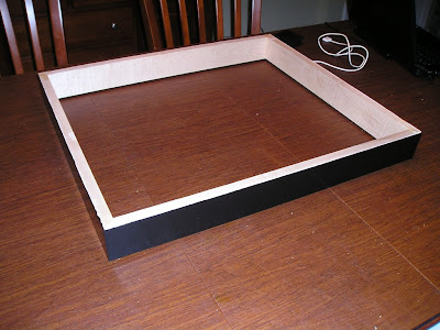

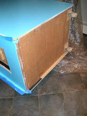

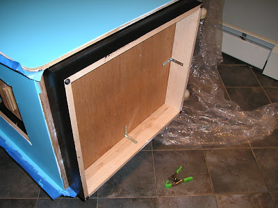

OK, I'm getting behind with updating this thread with pics and junk.  Next up was recreating the base of the cabinet (the first post in this thread is finally revealed!!!).
First off, I have to say that I'm an idiot.  When I measured the base I didn't account for the overlap from the side panels so it is actually an inch taller than I thought.  Initially I made the base out of a 1" x 3" piece of maple but I actually should have been using a 1" x 4" (3/4" x 3-1/2" actual).  It was easy enough and only took about an hour but I did have to spend an extra $16 on the maple and since I was annoyed I didn't take any pictures.  So everything is the same except the size wood you see in the pics is off by an inch to what I actually used.

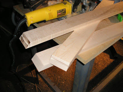

After years and years of sitting on the ground and being moved around the original base started to splinter and generally looks horrible.  It was easy to duplicate. I started out with an 8' long piece of maple from Home Depot. I chose maple because it was harder than pine (the only other choice in the store).
The dimensions of the base are 22" x 24-7/8" x 2-1/2". I cut up the maple accordingly with my chop saw and put a 45 degree cut on the ends so the corners would join together nicely. I also used my trusty biscuit cutter to cut some slots on the ends for some #10 biscuits. This will create a VERY strong joint when it is glued up. There is more surface area for the glue and the biscuit expands in the slot.

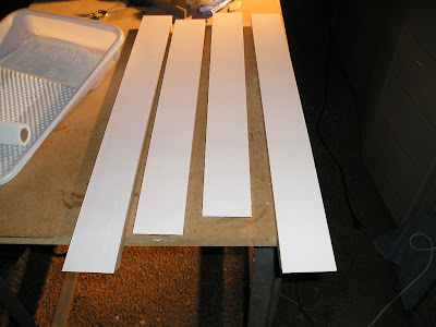

Before gluing everything together I applied 3 coats of the BIN Zinsser primer to hide the wood grain. I will paint it black once the pieces are glued together. I love this stuff.
I laid out everything on my dining room table (with some wax paper underneath in case of glue spillage).
I used two band clamps and 4 regular clamps to hold everything together. The joints are nice and tight and I checked it for squareness and it is pretty good.

Here is what the base looks like unclamped:
And here is what the rubber feet look like:
They were the smallest I could find at Home Depot that weren't adhesive-backed (which always come off eventually). I didn't want the base to be too high off of the ground but I did want something on the bottom to protect the base from being beat up over time.

Next, I put some black paint on the base. I used Rustoleum black paint - it is awesome stuff. It dries evenly and after 3 quick coats it looks great.
I'm also happy I took the time to mitre the corners - they look great too.
  • Posts: 8001
  • Last login:October 08, 2026, 04:08:02 pm
Re: javeryh's Donkey Kong +
« Reply #108 on: August 10, 2009, 11:51:27 am »
Finally, it was time to attach the minty-fresh base to the cabinet.  What a pain! The first thing I had to do was remove the existing base. This proved to be very difficult because the original was attached from the inside using small staples that I couldn't see. I ended up using a crowbar to pry all 4 pieces off and it took quite a bit of strength.
Here is the bottom without the base:
The next part wasn't so hard. I bought some L-brackets and used them to secure the new base in place. I pre-drilled all of the holes for the screws and it went on pretty quick. I was going to use more but after putting the first 4 in place it was rock solid so I left it.
It looks very nice installed. It isn't something everyone will notice but I think it looks a million times better than what was there previously. Plus, I was able to add the rubber feet which will make it easier on the floor of my house.
I think the flash from my camera makes it look like there is a seam at the corner or something - it is solid black all the way around.  That's it for the base.  Whew!  I am getting closer...   :cheers:
