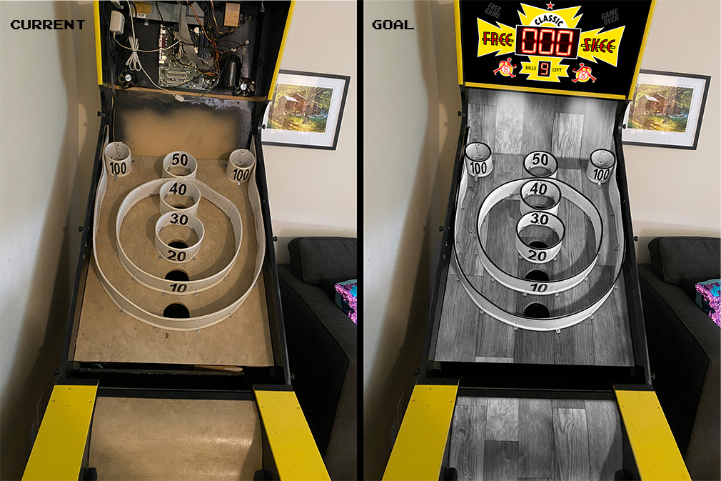

Soooooo..... not sure if anyone even remembers this build since it's been so long haha.  I just looked and the first post was 2009!
11+ years later and my Skeeball machine has kinda sorta been buried under a car cover in the garage for the last 5 years in a state of disrepair.  I took it apart because I wanted to upgrade the monitor to run a widescreen version of my software and between life stuff and kids being born, it just fell off my list of things to work on.  The other day my 6 year old daughter asked about it, so I let her roll a few balls up the dead machine and she was totally into it (she's seen me working on the Free Skee software, but she was finally able to make the connection that the software is supposed to run on the Skeeball machine).  That was enough to light a fire, and somehow I've convinced the wife that this gigantic broken machine needs to come into the house (!) and I've got a whole bunch of upgrades that I plan on making.
This is reboot number 3(?) I think, so obviously I've got issues with follow-through on this one but I swear this time is different.  Or is it?  I think it is, or my wife may divorce me.
So the bad news first, this thing is in rough shape right now.  It gets HOT in the summer and our garage gets absolutely scorching (we're talking a sustained roughly 110+ degrees daily in the unfinished garage).  I knew this wasn't good for the machine to be in that heat over the years, but I didn't realize quite how bad until I uncovered it and gave everything a once-over.
My bumper solution that I was very proud of is all cracked and in need of replacement, and the wiring and flexible LED lights on the ramp are absolutely CRISPY.  I started taking them off to see if they were salvageable and they literally started cracking in half as soon as they were removed.
The vinyl flooring that I used on the ramp and scoring area went from its original grey color to a gross looking orangish grey.  I've tried cleaning it and it is just discolored and nasty.  Honestly I was never fully in love with it so it gives me a chance to finally dial it in how I want it.  I'm assuming the computer is toast as well, and frankly it chugged a bit on the last version of my software and I've only added to it since then.
Here are my goals, both to give myself a checklist and hold myself accountable... I really want to get this thing done right so I don't regret any shortcuts later on.
Planned Upgrades / Things to finish:
Optical switches (mostly done, but need wire the gutter and confirm that nothing got fried)
Redo marquee screen area to accomodate much larger 16:9 screen
New computer
Speakers moved to the front of the machine
Neon LED ramp lights controlled by software (rather than manual control with remote)
A wood textured lane and scoring area
A viewport on the ball side of the ramp that allows you to peek in and confirm that all balls are in the machine.
Leg covers to hide 4x4s
Repaint yellow parts
Optional:
Explore plexiglass to replace net
Redo scoring rings, possibly cap them with a black edge if I can figure something out
Sound dampening on the entire machine to make it a bit quieter
Here's a sim of my vision for the machine.  Picked up the vinyl flooring today and already have the ramp section cut out, going to mess with the scoring area tomorrow... will update more soon!

This is an upgrade I'm really excited about.  The first iteration of my machine had the ramp and holes illuminated with RGB LEDs.  Once I'm done with this beast, it will have the ramp, holes, net area, and ball return area all illuminated with RGB LEDs.  These can all be controlled individually with my software, so it really introduces some great options regarding lighting the balls up with the current players color, etc.  While it may seem like LED overload, I hope I'm making design choices that will make this look great by not blinding anyone with visible LEDs... most if not all LED color will be visible because it is shining on to something, not because you can see the LEDs themselves.
I started playing with some ideas after I cut the hole viewing hole out of the side panel.  With black skeeballs, it was very difficult to glance in the hole and see if there was a ball there or not, so I figured I would need to illuminate it somehow.  After a few different attempts at lighting it from above, this is what I settled on.
I was feeling lazy, was going to remove the bottom wood and route it at my router table, but figured I could probably get away with routing it in-place with my dremel.
It worked, but I seriously should have just taken it out and used a router as it took forever and wasn't quite as clean as it would have been.  I don't think I saved any time.
Sanded some plexi to give it a bit of a frost.
Loving the look of this.  Will look unreal with the ramp lit up as well (and again, the colors are independent of each other so the ramp and ball return can be different colors).
The hole I cut out as viewed from above, still needs to be sanded and repainted.
The goal is to not be able to see any LEDs directly... so the rings, ramp, net, ball return will all have a glow but you won't see any hot spots when standing in front of the machine in a "resting" position.  The hot spots in the last pic aren't nearly as bright as they appear in the pic, you can definitely see the individual LED locations but it's not nearly as hot looking (and frankly, they are only exposed for a second when a ball is pulled).  I'll see how I like this, and once everything is done I'll decide if this works for me or if I want to make it edge lit instead.  I gotta say, though, that right now I am very happy with how it looks!
More updates later!
