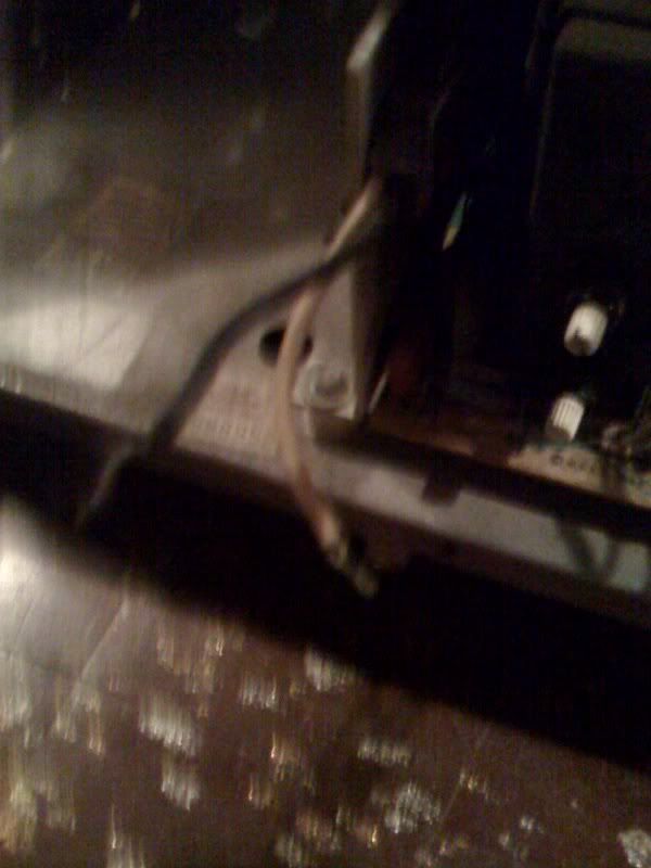

I just bought a used WG 9200 and it doesn't have a standard Plug. I have an old WG 19 inch(don't know the model off hand) that connects to my arcade Cabinet and I then plugin in my standard outlet plug. If that makes sense? I believe it is an Isolation transformer.
How do I go about plugging in this WG 9200 without the standard plug? It has a two prong and a three prong connection on the Monitors board.

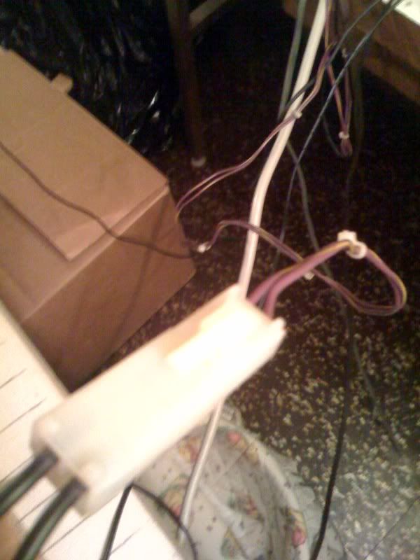

For my old monitor I have the Black and White wires as shown here
The Black/White wires then tie into one connector, and that connector clips on to a second connector leading to my Transformer. Shown below
I can then simply Plugin my standard Plugin and the Monitor powers on as it should.
Can I take the Black/White wires from the WG 9200 and do the same thing?

Ok so the WG 9200 has a 2 pin and a 3 pin on the video board. The 2 pin connector is already connected. But how do I go about connecting the 3 pin?
The connector coming from my Iso transformer has only 2 wires as seen in the pics above. I am so confused. I thought the WG 9200 was plug and play?
Call the Wells-Gardner parts department. Order part number 038A8059-000 AC power dongle adapter (3 pin to 2 pin, pictured on their website). One end plugs into the monitor and the other ends plugs right into the existing two pin connector in your cabinet.
They also sell a straight power cord for it: # 038A7927-000 AC Power Cord

Thanks for the info guys. I might try and hack a cable first. Do I need a connector plug or can I just twist the wires on the boards 3 pins?
How do I know which pins the green, white and black cables should go?
Also, I did something stupid while playing with this last night. Instead of being patient and asking here first, I did the following:
I took the two pin connector(the one that should be connected to the monitor board), cut it, twisted those to a connector. Plugged that connector into the connector that goes to my ISO. I then tried to power on the monitor. It made a little noise but didn't appear to do much else. Did I just fry my monitor?
savj14
