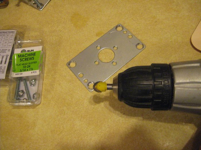

markronz's recommended mounting plate modification:
I can explain to you what I ended up doing with mine.  I used a bit to customize the mounting plate a bit.    I basically made the mounting holes recessed so that the screws would sit level with the rest of the mounting plate. See below:
Here is a picture with the screws in place.   As you can see, the whole top of the mounting plate is now level.
When recessing the mounting holes, you just have to make sure to use a V shaped tool to recess the holes.  Then of course don't go too far.  The screws still need to catch the metal, but yet need to sit even with the top of it.   If you route in too deep, the screws would just fall through the holes.   So that was the only touchy part for me.
And yes, my dust washer is on top of the artwork.   For me, that's how I'd prefer it anyway.

Very nice write up.  Can you give some more information on your mounting hardware, nuts and bolts?  You mention using some M5 machine screws that you faced off (meaning your sanded down?).  In the picture it still shows the hex pattern, but in the final picture it looks as though the screw head is completely smooth?
I got some machine screws yesterday at Home Depot that had a low profile head (flattest ones I could find).  That I think will work pretty well.  I think I will have to route out a little more than 1/8" maybe 3/16" which will leave 7/16" or a little less than a 1/2".  But these were the flattest bolts that I could find.
The machine screw in the final pic isn't actually the type I will be using, it's just one I had to hand from experimenting with different bolts. The ones I will be using will be the first one in the black picture with the two bolts and nuts. The bolts I got came as the second one in that picture. I put them on a lathe and faced the excess off with a turning tool to leave a 1mm thick head. The hex cannot be used anymore as the material has been removed but the nuts will still be able to be tightened sufficiently from the back.
Any bolt should do really with a relatively thin head and it sounds like you found some suitable ones. If the recommended mounting depth is 9mm then you have plenty of material to play with and you can increase the recess to over 1/8" so that your bolts sit below the MDF CP top.
I did some prep work for my control panel today.  Hopefully I will be doing some updating to my project thread soon.  I just wanted to post what I found to do what Markronz demonstrated.  I used this to create a chamfer in my joystick mounting plates:
It is a Hitachi 3/8" Countersink Bit.  The package says that it is for pvc and wood, but I was able to use it on the metal mounting plates with ease.  I was incredibly paranoid about going down to far, but it is actually incredibly hard to mess this up.  The top of the screws are now flush with the mounting plate, and it is incredibly sturdy.  I did 12 holes on 3 mounting plates total, and the bit did not wear down.  The best part:  the price.  This bit cost $3.69 at my local Lowe's.  Thanks to Makronz for the tutorial.
I also want to give a shout out to Franco for this jig making tutorial.  I made my jigs and did a trial mount.  I am incredibly pleased with the sturdiness and the aesthetic result.  I did want to share about one thing I purchased for this.  To make the recesses for the mounting plates, I purchased this 1/2'' Pattern Router bit from rockler:
This bit is incredible!
