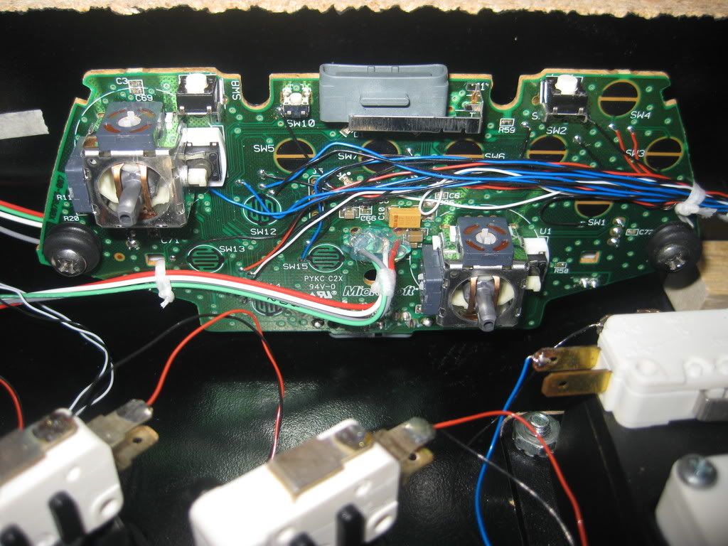

Hey you and I have the same idea on making a 360/PS3 stick. I have everything I need including 2 hacks done by my man Haruman on a sixaxis and a 360 controller. Im trying to input both PCB's into one stick. Ive wired them in 2 different ways so far and both have the same result except one wouldnt let me turn on the 360 controller at all. Otherwise the 360 will not work and the sixaxis makes continues to move the menu down endlessly and no buttons work. I know its a wiring issue and how the two controllers recieve their voltage. However I spoke to Haruman about this earlier today and he suggested using a switch to designate when to use the sixaxis functions and when to use the 360 controller. As soon as I can figure out how to add pictures to my posts Ill show you what I got so far.... But your stick is FABOLOUS well done. I especially like the artwork. Where do you get the plexiglass cut to your specifications and the usb passthrough you have used, is it a mini usb connection like a sixaxis has or is it a standard usb.

I'm going to use two USB pass through and plug the USB cables from each controller onto a separate pass through.  Then I'll switch the USB cable on the outside of the unit depending on the system I want to play.  That's the idea, at least.

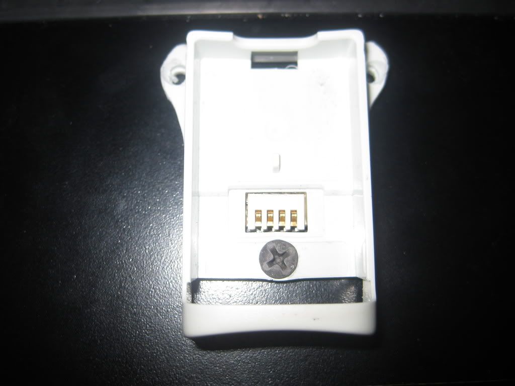

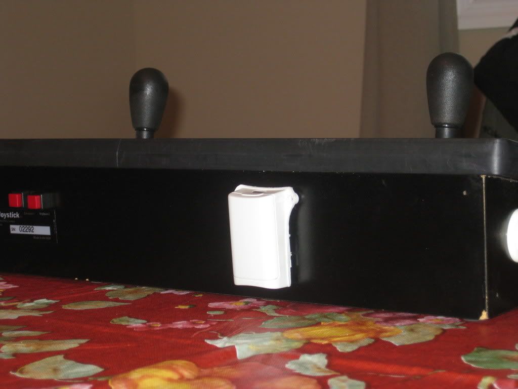

Just put the battery pack on the outside of the case like I did........easy access....also put a plug in line with battery and board so I can service board if I have too.  Heres a pic...
Still have to clean up the edges but will do that after I wire up player 2
