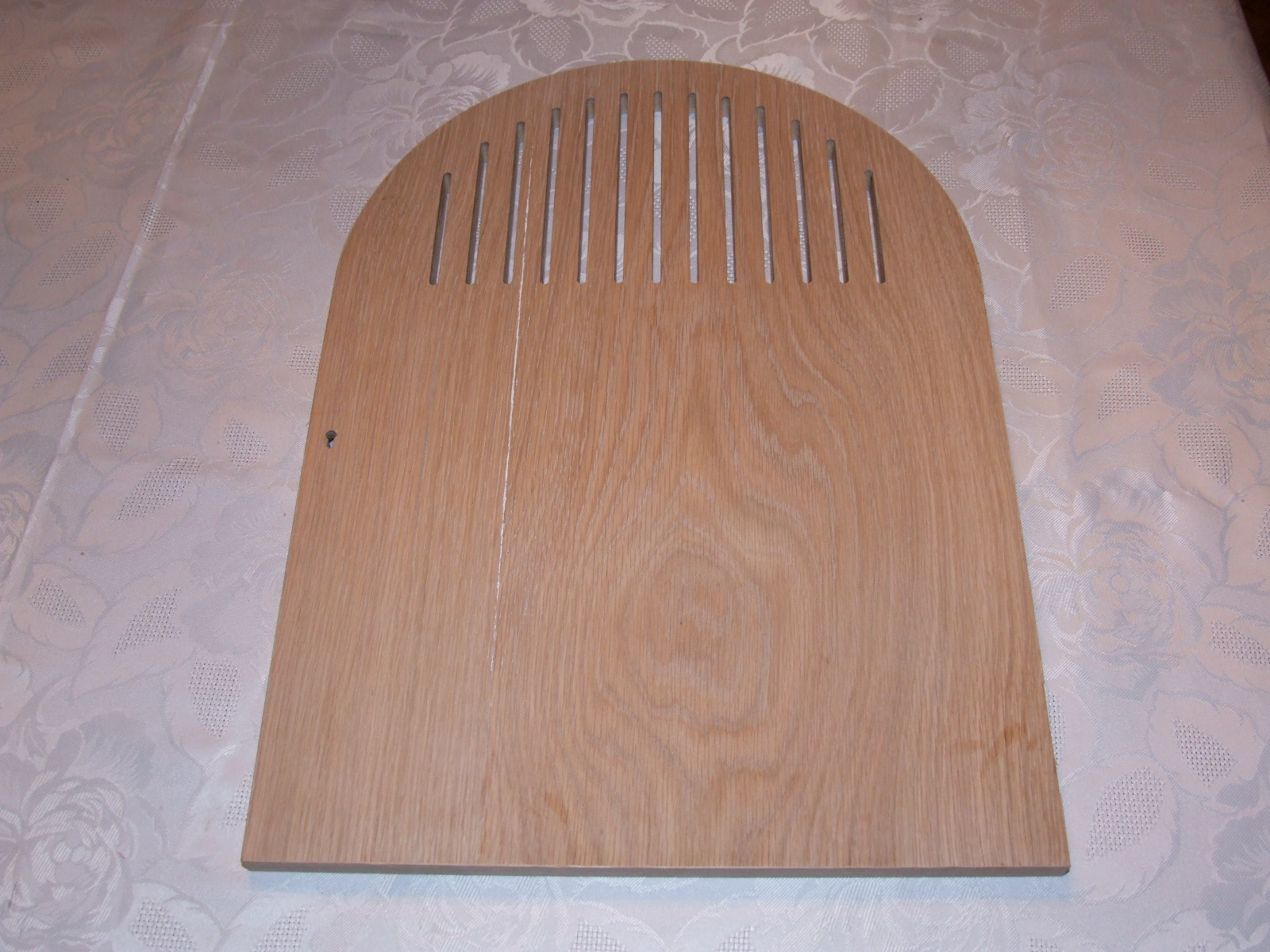

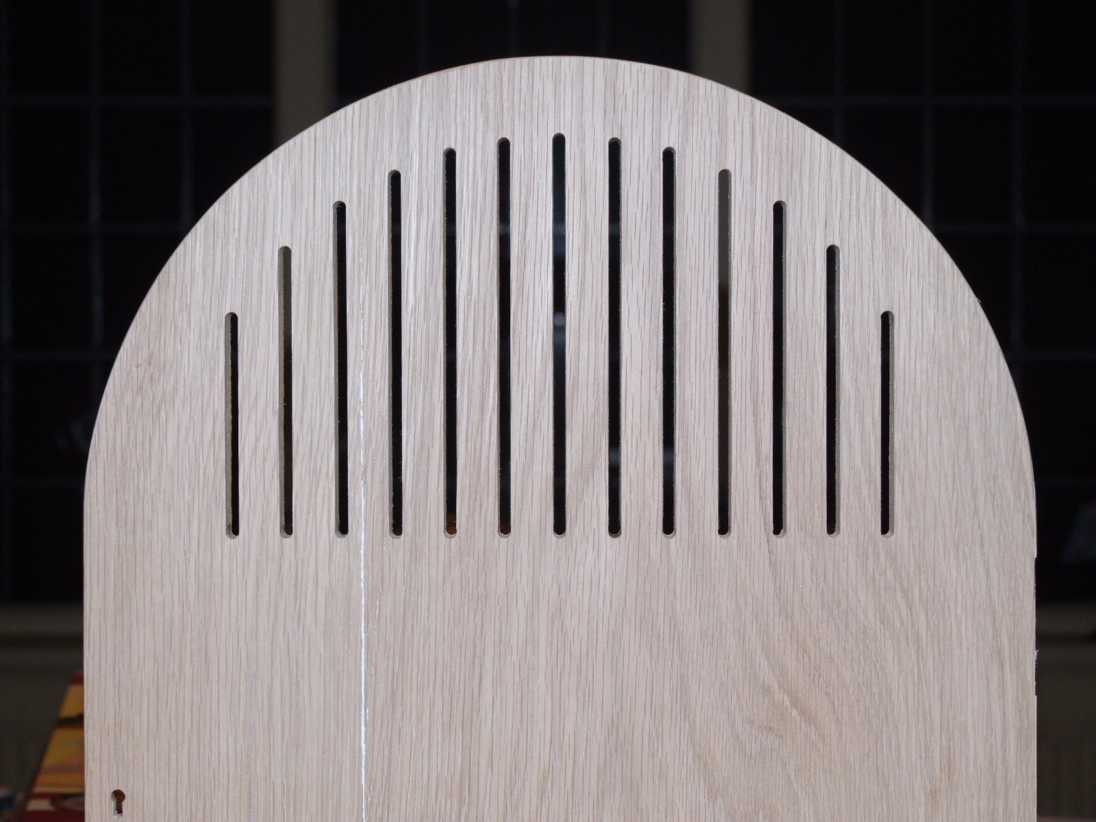

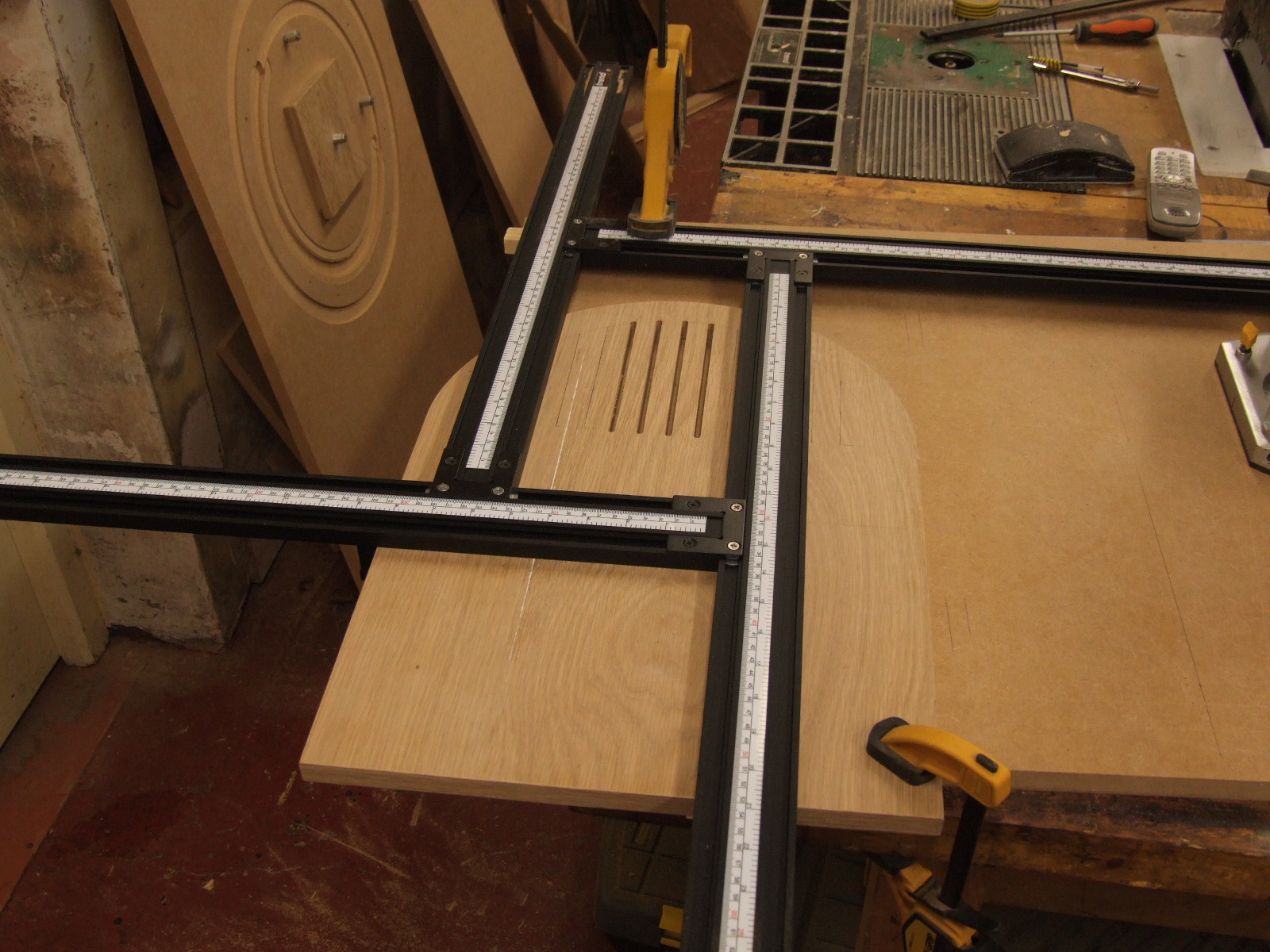

I am becoming increasingly concerned with ventilation, as the trial version of the juke I made got very hot to the point that the laptop I intend to use for the guts would become jittery. It's AMD based and well I know they tend to run hot but this gets very hot.
We decided to route some slots in the back door. I don't know the name for this tool, but basically once set the router fits within the internal space and its north/south travel is restricted to the correct amount by the horizontal rulers. This was after we'd done the first few slots - this took almost a full day as the spacing and length of each slot is absolutely critical to get the look we were after, and it was a one time only deal, obviously:
This picture shows both the finished routing, and you can also see where the veneer shrunk slightly during application. this is quite concerning (the white is filler) but as it's the back door which won't be seen, not the end of the world. We have a new technique for application in mind for the sidewall veneer - more on that to come!
The top line of the routed slots follows a concentric circle on the same centre as the outer shape. Therefore if you measure from the top point of each slot to the tangent of the outer circle, the distance is the same for all slots  -even though it doesn't look like that in the pic!!

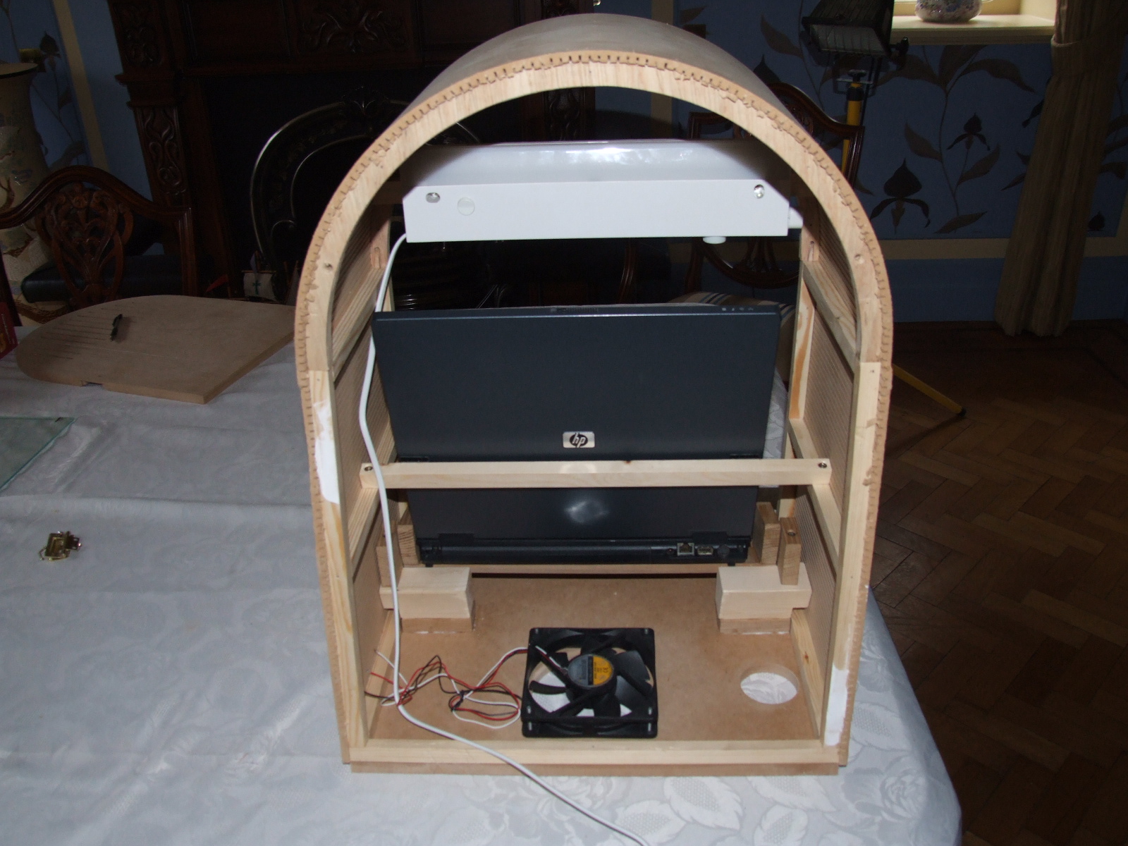

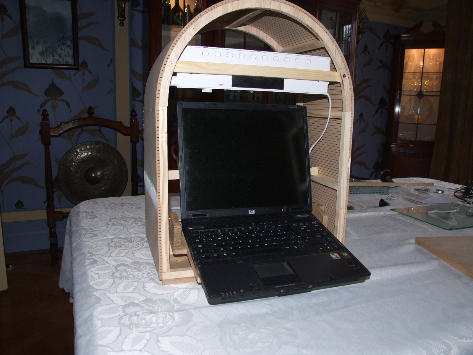

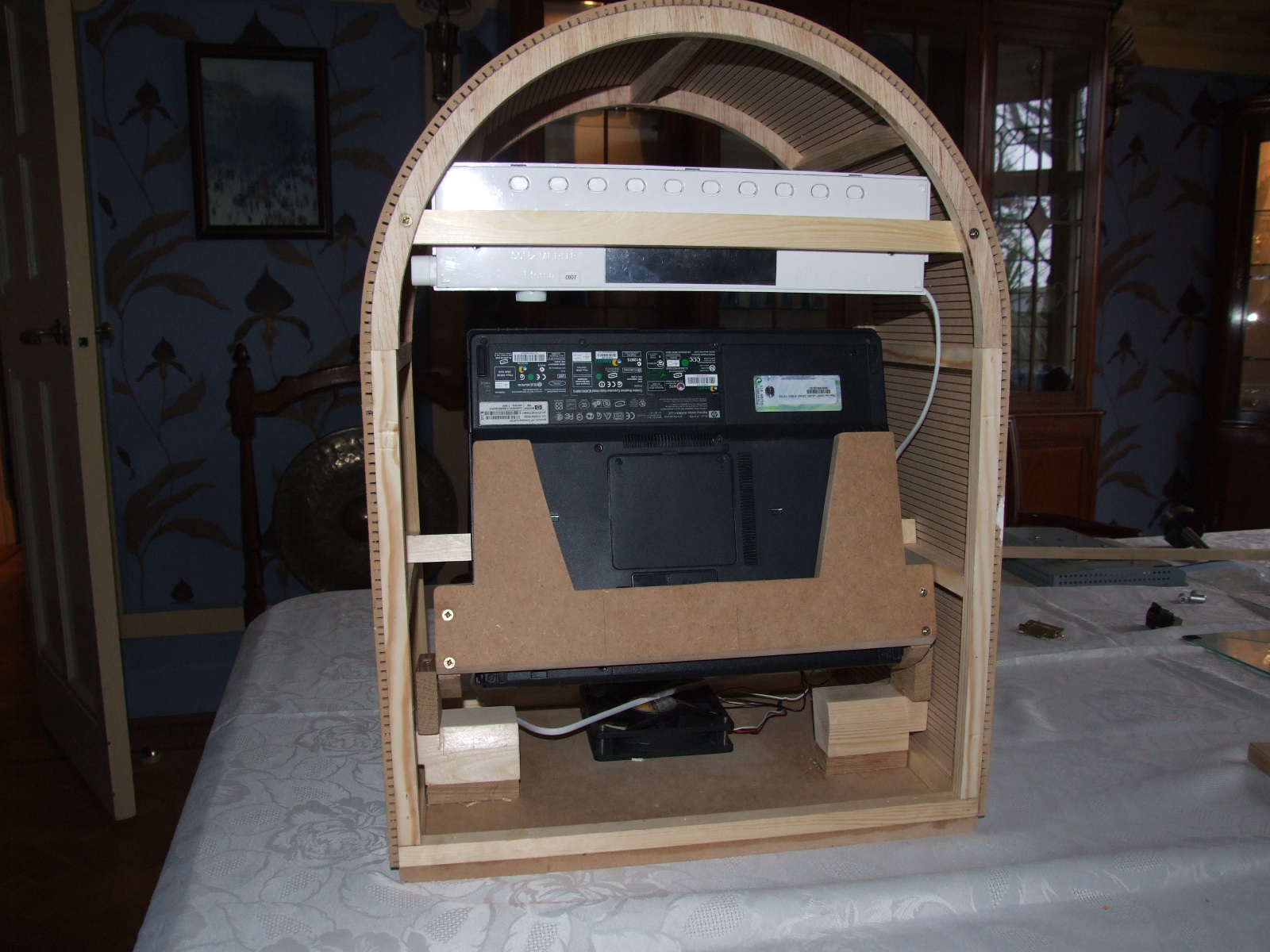

we next started to plan the layout of the laptop and marquee light. We decided that access requirements to the laptop would be few and far between (heh) but we also didn't want to be poking about inside the juke whenever changes were needed.
The first pic shows the front view and you can also see the marquee fluorescent in this pic. I was going to use some really great LED strip for the light, but the one I liked was about Ł120 per metre... spendy.
This is from the back with the laptop closed. Forgive the Heath-Robinson blocks getting everything to the correct height! If you notice where the laptop hinge is (toward the bottom) you'll see that there are two rounded pieces of MDF. This ensures that the laptop hinges down for acess along the axis of the laptop screen hinge.
The catch that holds the laptop shut is easily accessible, and when you open the laptop the screen stays in place (it's velcroed to the horizontal batten that's visible in the front pic above). The keyboard comes out a comfortable distance for any changes that may be required. Despite the slightly rough look, it works surprisingly well  :cheers:

I dont' have any photos because my ghetto juke has never made it past protype stages, but anyways I put a little PC fan at the very top blowing out which of course heat rises so it blows out the hot air and cooler air is sucked in from little notches near the bottom.
I really like your idea putting in little notches for venting. It just has that finished look opposed to just cutting a hole.
drawfull
  • Posts: 463
Re: Just Another Mountain JukeBox Copy ;) Back Door 'n Guts! **14 Nov 08**
« Reply #66 on: November 16, 2008, 12:18:01 pm »
The slots fit quite well with the finish we're looking for imho. What we did realise though is that the position we've put the fan means that the laptop will actually get very little cooling. I am thinking the fan should have been towards the top, sucking warm air out, but we are where we are.
So, we made a little aluminium deflector which will fitover the fan, attached to the laptop support pillars. This will hopefully ensure that at least some airflow reaches the laptop but because it's 4" narrower than the width of the internal cab we still get airflow over the touchscreen. We hope. It's not up to Franco's metalworking but it suits the purpose :) I don't have an installed pic - everything is apart as we're staining - but hopefully my budget description and pics before will help...
