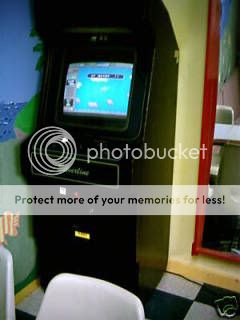

hi everybody  :)
i've just bought a jamma arcade machine off ebay
i payed £100 and it came with a Wonderboy in Monsterland PCB
this is my second machine, i used to have a small cabaret machine (think it was electrocoin) without swappable marquee with Streetfighter 2, Pang , MK, World Rally and Golfing Greats.
I'm planning on fitting a pc inside to run mame on it but i would prefer if i used my arcade screen and could insert coins to play the games and would appreciate any advice given as to items i need to purchace to do this (or handy tips)
as far as i understand it i would need a j-pac to connect the pc to the jamma interface, and an arcade vga card, also i would need to sort the sound out. i would be using my old pc (pentium 4 3.4, 1gb ram, 250g hd)
i have used mame 32 before and atomic fe (which i prefer)
the machine is only a 1 player 2 button set up but a j-pac has connections on it for extra buttons (i think)

I love those silverline machines. My first cab was the exact same model. I mounted 2 peakers in the bottom of the cab where the coin boxes are. The built in speaker is poo!. Before getting all worked up mameing it, the first thing I did was get the metal control panel remade at my local sheet metal works and turned it into a 2 player 6 button cab. Then stick in the jpac and arcadevga and wire in the extra buttons. My £0.02

I had 2 done for £15. Had plans for the second one but sold "neverland" in blind panic when my missus anounced she was pregnant.  I literally just wandered into a metal workers I found in the yellow pages with the original panel and asked them. Had to drill it myself though. With holes and the clamp brackets the price sky rocketed. In the end I countersunk the bolts for the brackets and drilled out the buttons with a bi-metal holesaw. Those panels were tough as old boots and stood up to an amazing amount of punishment. Well worth getting done. I also swapped out the 15khz monitor for a vga compatible arcade monitor, WGU300. Same aspect and shape. The chasis just fit straight in over the original. In the end it was cheaper than the Jpac/Arcadevga etc. Just bought an ipac and was off.

Instead of building a new CP, i just drilled the extra holes in the existing CP, and wired the buttons.  The JAMMA should have the hookups for 3 buttons per player, and then the JPAC will wire up to 4 buttons per player, so even if you have two buttons wired for JAMMA, you can wire the extra 4 buttons per player on the JPAC, assuming you are doing a SF2 set up. You can see if your PC's video card will accept the Soft15KHz, or go the ArcadeVGA route instead.
