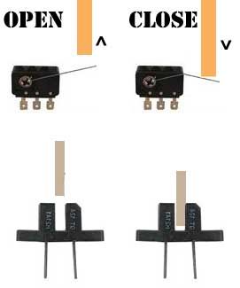

Can't read the actual article, but based on the movie of its operation..if you wanted the card to pop out when the curtain drops,
 a reed switch in the base of the front, triggered by the curtain dropping (a magnet placed in the bottom of one of the curtains),
or a coin mech microswitch with the wire placed so that the curtain dropping back triggers the dispenser.,
or an optical switch with something attached to the curtain that blocks the light triggering the dispenser.

Anyway, in thinking more about it, I don't really think a trip switch is going to work very well in the long run (either microswitch or optical), because the curtains basically start out closed...then open during the show, then close again when the show ends, which is about the time I want the card dispenser to fire.  This would mean that a switch would be tripped twice (once when the curtains open and again when they close), before the time I want the card dispenser to actually spit out a fortune card.

Ok, now that I've finally had a chance to look inside my Zultan machine, I'm pretty sure I won't be able to just simply rig up a microswitch, reed switch or optical switch, to trigger the fortune card dispenser, when the curtains close.  Like I said before, the real problem is that the curtains start closed, open upon operation, then close again, which means you're triggering the switch twice...on opening AND closing, when I really only want it to trigger on closing.  Pretty sure you'd have the same problem wiring directly to the curtain motor wires (there's just two of them), as I would think it would simply fire the fortune card dispenser, both upon opening AND closing again.
