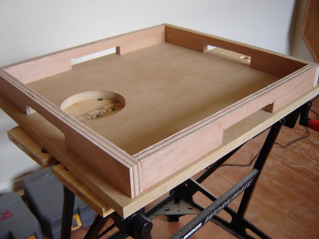

 Finally I have being able to make a start...there is a slight change of plans
 to the original design. I will be making a standard 2 player vertical cocktail
 cab with either a 48-1 or a 60-1 jamma board installed. I will probably
 do the 3 sided on another date...we will see how this one pans out.

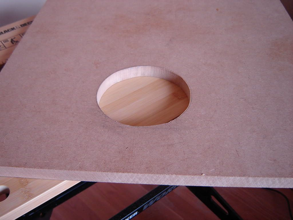

 Anyways I started on the base & cut out a 120mm hole with my jigsaw...this with be for
 my multicolour fan I bought off Ebay for 1p.
  It was far easier than I thought to be honest...& I cut just inside the line
 for a perfect fit when sanded.
 Next I cut out the base vents...this was a bit more tricky & time consuming
 as they are plywood opposed to 3/4 MDF.
 They are a bit wragged at the moment but I mocked up the positions on
 the up-turned base.
 Now for some sanding...more to come later...

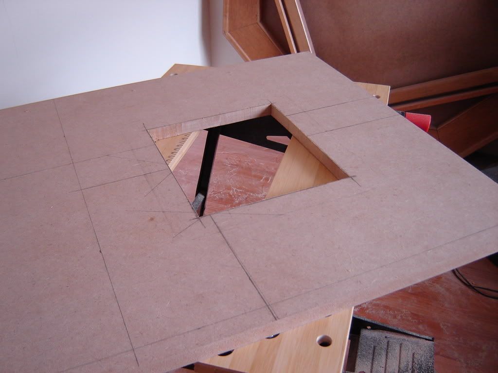

 Well instead of sanding today I thought I'd get some more of the
 cutting out done so I set to work on the coindoor...
 Whoops... excuse those marking out lines...lol
 And finally I roughly cut out the top making sure I was inside
 the line again... so if I use my router to get a nice clean finish.
 Now for the sanding...& I still have to work out where I am

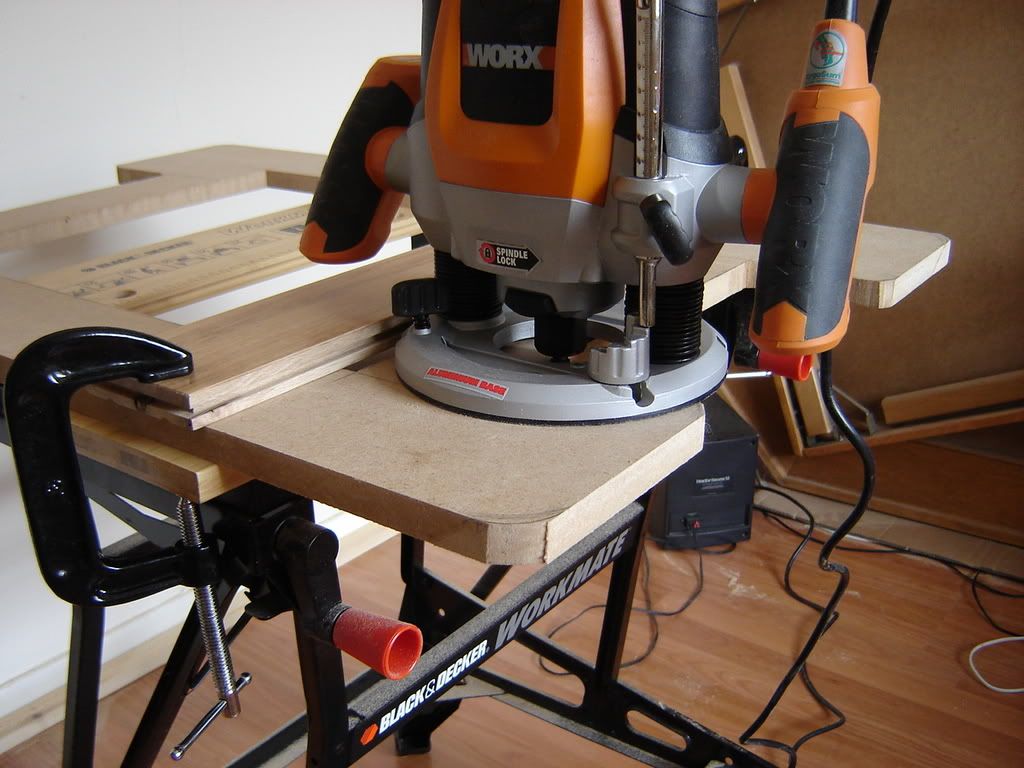

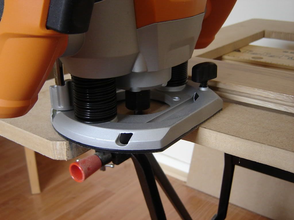

 Yeah...Franco I used my jigsaw to cut out the...well everything...I'm just trying
 to figure out out to trim these edges with the router...??? How do I know
 how deep it's going to cut? I have a straight edge clamped in position but
 I don't have much space for error...
Franco B
  • Posts: 3766
Re: Finally progression has started :)
« Reply #13 on: September 11, 2008, 06:26:01 am »
Did you get your pattern bit in the end? If so you can just clamp a straight edge to the line you want to cut and let the bearing follow the straight edge.
If you don't have a pattern or flush bit you can use a straight router bit with a straight edge and the flat section of the router base. Clamp a a straight edge to a scrap piece of material and route the edge of the material using by running the flat section of the router base along the straight edge (just to remove a little material). You can the measure the distance between the straight edge and the edge that you routered. Record the measurement for future reference. When you want to trim an edge, draw a line parallel to the edge you wish to cut offset by the recorded measurement and clamp a straight edge to the other side of it. You should then be able to route the edge as before.
Obviously the recorded measurement will change if you change the diameter of the router bit so make sure you remember which bit you used.
If you are routing out the inside of the cocktail top, go slowly and keep checking the material left when approaching the corners as you don't want to go too far and cut into the corner.
You don't have much material to work with on some parts of that piece of wood so you may need to attach/clamp some support boards to the material to enable you to route the material. Take a look at [this] web page for some info and general router basics.
