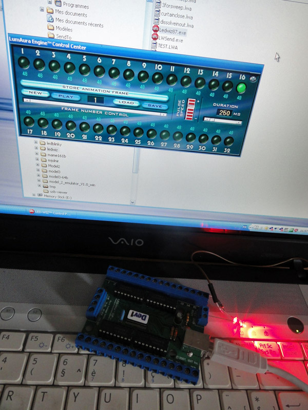

Here's my hardware :
LED Wiz / GP ver 3.0
1 led (the one provided with the LED Wiz)
Here's my software :
LED Wiz applications (with include LED-Wiz control panel icon)
LED Blinky 'suite' version 6.2.0.0
Mame 161b
OK, so before everything,  what I've done is to test if the only led I have so far (connected to the output 16) is well connected and if the led wiz board work. So far so good ->
I aslo check via the SimpleLEDTest.exe the led on position 16 :
..and it works as expected, fine.

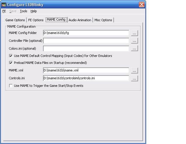

Now, it's time to configure LED Blinky itself. I won't use any front end, so I directly jump to the 'MAME Config' tab, and set everything like this :
- note that the mame.xml file didn't exist, so I had to create one, like this mame.exe -listxml >mame.xml
- note that the control.ini file didn't exist, so I had to download it. I only found on Internet the 0.141 (here) but my mame version is the 161b version. Could this be a first problem?
Anyway, I add this section to the end of that file :

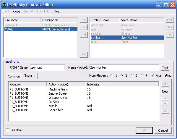

But there is something missing here, no? Because for the purpose of my test, I only have one single LED, connected to the output no 16 on the LED Wiz device.
So, for example, how to assign ..let's say the 'machine gun' LED to the ouput 16 from the LED Wiz device?
OK, I figure it's over the LEBBlinky Controls Edition panel? Because I see this ...and already an entry for Spy Hunter? ->
So as you can see in the picture, I believe I've assigned the port 16 for 'Machine Gun', 'Smoke Screen' and 'Weapon Van'... correct? (Yeah, I've selected THREE of them, just to be sure to have something to light very quickly when I start the game).
But... when I run Spy Hunter, the only LED I have (on port 16) doesn't light on, or even doesn't flash... it does nothing  :-[
So let's check if LED Blinky can see what's coming from mame with the tool 'MAMEOutputTest.exe', and it seems ok ->
Do I have to change something in the mame setup? What could be the problem? Do you see some mistake in these configurations?
