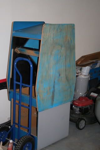

I used Citristrip to remove the paint on the sides.  (Ummm...orange smell)
The screens covering the vent holes on the back were pretty dirty.  I removed the staples and pulled these out to be cleaned
I also removed the bubble from the back for cleaning

The cab design on Gorf is really nice in that the top seperates (12 screws) from the bottom
I applied bondo to some areas that needed it.

When the bondo dried, I sanded it smooth
I also spray painted the bubble and the vent screens.  I used a flat black on the bubble
and a rustolem silver on the screens
It looked really good when dry

After some trial and error with thinning the paint, I finally got the spray gun working.
First I finished masking off the areas I didn't want painted
Here is the base primer that I used
Based on WunderCade's advice above, I also picked up some laquer thinner.
Here's some shots of the first coat of primer.  When it dries, I'm going to hit it with some sandpaper and then apply another coat.
When I was done spraying, I cleaned up the gun with water and they sprayed some of the laquer thinner through it for a final cleanning.
I'll get a better idea on how it turned out when it dries, but it seems to have worked out pretty good.  I should get enough practice on the primer coats before I get to the final colors.

Re: Gorf restoration
« Reply #77 on: July 12, 2008, 07:14:16 pm »
The primer looks great.
How much did you dilute the primer with the laquer thinner?  One part thinner to how many parts paint?
WunderCade
  • Posts: 3041
« Reply #78 on: July 13, 2008, 01:01:25 am »
I think that primer is water based, like the paint. Which means you dilute it with water. The lacquer thinner is for clean up only.
Spyridon
  • Posts: 1480
« Reply #79 on: July 13, 2008, 09:36:31 pm »
WunderCade is correct, the laquer thinner was for clean up only.  I'm not sure of the mix ratio, but it was probably around 2-3 parts paint to 1 part water.  The first time with the water, it was still a little too thick, so I added more.  It was much more liquid than I would have expected to get a good coat, but it worked well.  Plus your paint goes farther  ;D
Spyridon
  • Posts: 1480
« Reply #80 on: July 13, 2008, 09:42:08 pm »
Today I used some 220 grit sandpaper to go over the first coat of primer.  After sanding I used the air hose to blow away any dust left from the sandpaper, followed by a wipe down with a tack cloth to make sure I got it all.  I then hit it with the second coat.  I went with a vertical spray pattern on this coat since I used a horizontal spray for the first coat.
You can't even see the big scratch that was in the interior side anymore.
Before and After:
Paint is extremely smooth.  I think that will be the last coat of primer and now onto the main color!
« Last Edit: July 13, 2008, 09:46:06 pm by Spyridon »

Did the first coat of blue today, but it didn't go to well.  First the paint was too thick and I was just getting splatters out of the gun.  I added more water and still the same.  Did this two more times and finally got a good spray pattern.  The problem was that at this point, it was too watery.  It's only the first coat and I was planning on lightly sanding after this coat as well so I'm not too upset.  I may just need to do some more sanding than planned and maybe need a third coat.
Hopefully I can figure out the water to paint ratio and get it right for the next coat.  (still learning)
Here is the paint I used:
The good news is that the color looks great.  The paint codes were provided by a KLOV user that had gotten it computer matched.
Another issue I see is where I had used the blue painters tape to mask off when I painted the black.  It must have left some residue behind as I can see exactly where it was all around the cab.  Sanding it down should fix it.

Gorf is now one piece again!   :applaud:  I reassembled the top of the cab and the base today.
I also put the screens back in using some staples
bottom:
And sitting in place:
top:
with the bubble back in place
Now I have somewhere to put all of this:
