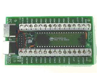

Okay,
I hope this helps you out. All you need to do to get the atari buttons working with the ipac is the following.
Use the normal button outs on the ipac, and use the LED pins on the ipac to get them to light up, I used a old internal USB ribbon cable to connect to the ipac's pins.
Now, as for the resistors (220R) I managed to find the corect ones at my local Radio Shack, I got 100 of them for $2 :-)
Now, on the Diagram image I ran the +5 volts to all 3 buttons and then the CAPS, NUM and SCROLL to each button. On the Ipac image this is where you need to get the power and lighting for the buttons
If you need anything else (photo's and so on) let me know and I'll get them for you asap (I want to see the final product  :) ) oh and I still need some parts  :P
I did this for my Space Ace and I also did it for my Marble Madness with no issues at all  :applaud:

What kind of LEDs are in those things?  I know the IPAC doesn't have the current to drive modern superbrights.  You may need a 'driver board' like this one:
http://www.gamecab.com/products.asp?cat=26
That's basically what I use to light up my player 1 and 2 buttons with the IPAC LED functionality.

AFAIK a ultra-bright LED does NOT use (much) more current than a regular LED. 20mA is "standard". There's also 10mA and some 25 mA.
Where did you see the current limits on the IPAC ? I checked the Ultimarc site and there's no indication about it there.
The only problem you get is when you start running multiple LEDs on one such connection. If you connect 10 LED's to one connection, than of course the current drain is 10x20mA=200mA. I can see that the IPAC would be limited in that way, but I really don't see the IPAC having a problem with one ultra-bright LED per connection.

The Ipac just provides a signal voltage for the LEDs.  I don't know the exact current (I've heard 10mA but can't find it), but those can be lower than 1.5 mA.  I really don't think Oscar and Gamecab would have bothered building LED drivers for IPACs if they weren't necessary.  :)
EDIT: from Andy himself, 10mA:
http://arcadecontrols.com/wwwboard/messages/39244.html

OK, I was already hoping for some input from Andy, but this is clear enough. Very weird, because in this case, even normal (20mA) LED's would be a too big load for the Ipac....Looks like you would need to use low-current (2mA) versions....
