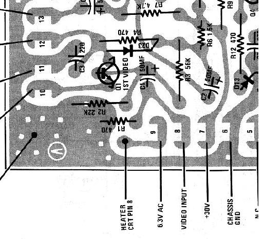

I'm trying to work out exactly what path to use in diagnosing the missing 6.3v on pin 9 in the monitor chassis.  I see 6.3v should be coming right off the transformer.  The immediate question, and one I can't just eyeball from where I'm sitting, is which one?  The iso on the chassis or the cabinet main?
Placeholder post for the time being... will be using this photo as reference.

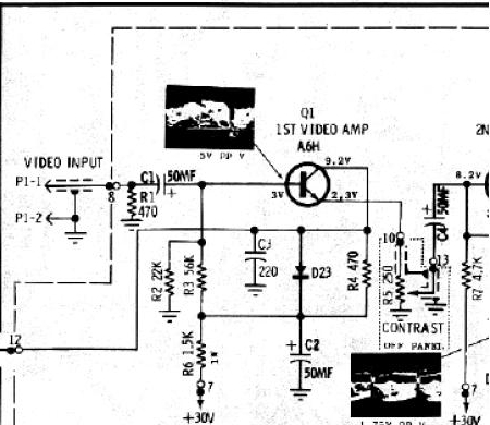

Just musing around the diagrams a bit...
The missing 6.3v is on pin 9 on the chassis.
R1 is just next to pin 9 in the image above.
Here is R1 in the schematic.
I probably replaced C1.  I'll verify that the polarity is correct.
It appears to be straight from P1-1, which is pin 1 in the main chassis connector.  P1-1, if you reference the wiring diagram above, comes from edge pin 21 on game PCB2.  Pin 21 is video - pin 22 is video ground.
When I get home I'll pop the leads onto pins 21 and 22 on PCB2 to see if there is any video signal coming off the boards.  Any idea on what range I would reasonably expect to see?

Bah... what is that combo of black circle and white circle between P1-1 and R1 in the schematic?  Is that pin 8?
If it is, I need to go back towards the drawing board a bit.
Yep, found pin 9, straight off the transformer and labeled as 6.3v.  Looks like it makes a whole lot more sense.  Question:  I don't see a BR there like I do on the other transformer outputs.  Does this mean I would expect this to be 6.3v AC?
« Last Edit: February 21, 2008, 02:28:46 pm by ChadTower »

« Reply #173 on: February 21, 2008, 02:31:14 pm »

« Reply #174 on: February 21, 2008, 02:43:49 pm »
Looks like it. 6,3 V is a common used voltage for the heater in the CRT. If it's really low this could explain the dim picture.
It could also be explained by me measuring it as DC.  I'll recheck that when I get home.
BTW, good call.  Looking at the "back of the board" diagram, pin 9 is sitting right next to "heater CRT pin 8".
« Last Edit: February 21, 2008, 02:46:31 pm by ChadTower »

« Reply #179 on: February 21, 2008, 10:00:00 pm »
6.74vAC present.  I was chasing a wild goose on that one.   :banghead:

Hrm.  I hate to add a variable here... but my Commodore monitor has a TTL input on the back.

Is it an RGB input ? If so, connect the video to one of the colors. Green comes into mind as a nice retro-looking color ;)
Level42
  • Posts: 5965
Re: Tank II
« Reply #192 on: February 22, 2008, 03:23:03 pm »
O wait, the sync is on that composite video signal......can't use RGB input with that .....

« Reply #193 on: February 22, 2008, 03:25:27 pm »
That's solved then :)
I'm not sure - I've never used it.
Wait - if the board is putting out TTL levels - and TTL levels are higher than composite levels - and I was testing with composite output - then the monitor would be expecting higher levels than I was testing with - meaning the monitor could be better than I think?
Erg.  I'm all over the place now.  I'm heading out - it is snowing like a mofo here and the roads are getting really bad.  I should have time this weekend to try a couple of things and make more rambling posts.
Level42
  • Posts: 5965
Re: Tank II
« Reply #194 on: February 22, 2008, 03:26:41 pm »
Yes of course. Someone mentioned that in this thread already !!! :D

I took a first look at the Tank II Schematics and it looks to me like the PCB is creating the DC voltages itself.
There's a transformer on the bottom of the cab. Since the Motorola doesn't need an isolation transformer, why would there be that 2nd one ?
I think the power supply to the PCB's are not coming from the monitor.....
Or am I missing something obvious ?
Yeah.  I didn't understand it then, though.
The motorola doesn't need an ISO because it has one of it's own, my guess.  It does "need one" because it "comes with one".
Isn't that what I said to you a couple of pages back???
You spoke of impedance... which seems correct but I didn't understand enough to know what it meant yet.  What you just witnessed was me connecting the dots.
