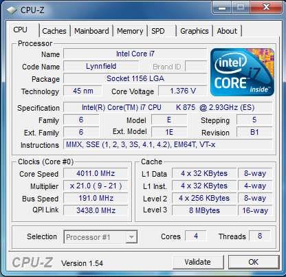

All Benchmarks were run on MAMEUI 64bit version 0.138u1 in Windows 7 64bit.
First set of benchmark I ran were using the same Roms & setting as John IV.
I ran the benchmark set three times, once with the I5 655k @ 4.6ghz, then again at 4.8ghz, and then with the I7 875K @ 4.0ghz.
The Command Line was as follows:
MAMEUI64.EXE -str 90 -nothrottle -norc -mt -nosleep -view standard [Rom Name]
ROM              i5 @ 4.6ghz    i5 @ 4.8ghz    i7 @4.0ghz
19425294.06%5656.39%5049.09%
Blitz211.76%219.89%247.23%
Dolphin33.44%35.91%29.27%
Gauntleg295.30%300.43%322.49%
Gradius4163.59%169.82%182.35%
Propcycl159.75%159.93%203.97%
Radikalb199.64%209.44%159.87%
Scud119.33%124.38%115.24%
Starsldr139.56%144.96%120.40%
I ran another benchmark set with a large set of ROMs on the I5 655K @ 4.6ghz using my old command line.
MAMEUI64.EXE -noautoframeskip -frameskip 0 -seconds_to_run 240 -nothrottle -nosleep -video ddraw -skip_gameinfo -effect none -nowaitvsync -noreadconfig -m [Rom Name]
ROM                 Result
19425300.81%
Airco22b165.88%
Alpinerd106.31%
Blitz201.74%
Blitz99210.60%
Cybrcycc222.12%
Dolphin34.44%
Gauntleg330.59%
Gradius4156.53%
Hyperdriv240.46%
Propcycl162.43%
Radikalb193.13%
Raveracw153.87%
Ridgerac184.33%
Scud115.35%
Sidebs2219.05%
Starblad168.09%
Starsldr137.76%
Stunrun886.06%
Surfplnt177.45%
Sorry I didn't get a chance to do more, but I only had a limited amount of time with the CPU's.
