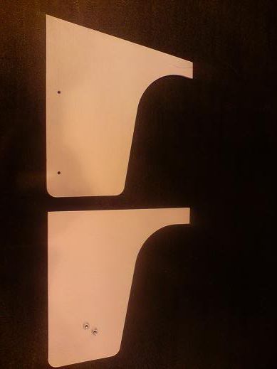

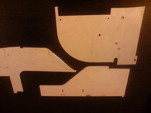

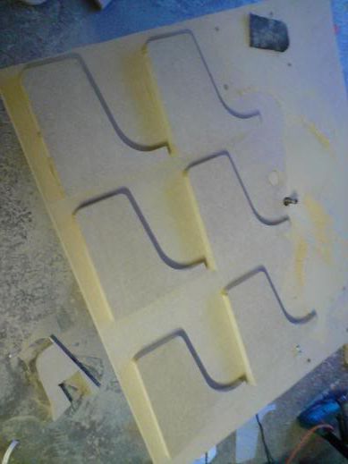

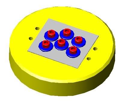

Ive made the templates I was taking about before for routing the CP sides:
I milled them out of some 3mm aluminum sheet that I found, once again, in the scrap bin. They were quite easy to mill as I could just clamp the sheet to the machine table and mill the profile in one pass with the cutter 0.001" off the table. As the cutter was so close to the table it cut the shape out cleanly.
Im going to make the main button bezels next and they are going to be slightly more tricky to produce as they will be made from stainless steel and are more intricate. I have been having a bit of a think and this is how I intend to produce them:

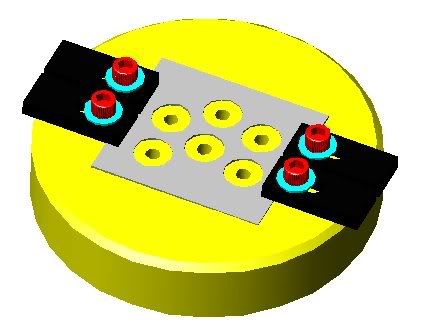

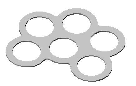

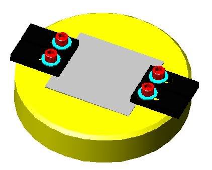

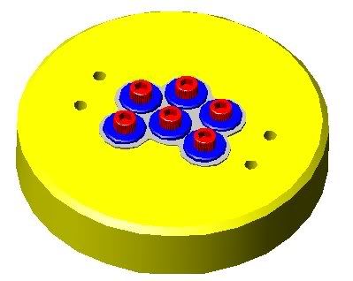

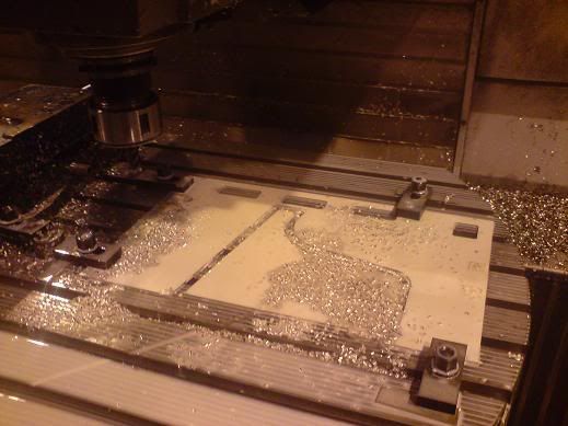

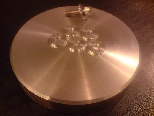

First of all ill chop off and skim the faces of a some 250mm mild steel to make a jig base. Ill drill and tap M12 holes in the jig where the button centers are and also four holes for clamping:
Ill then cut out some 1.5mm stainless sheet slightly bigger than the finished bezel size and clamp it to the jig:
With the sheet clamped securely  Ill then be able to drill the 6 holes 10mm and then circle interpolate the holes to 28.5mm (0.5mm bigger than the button screw thread):
I will then clamp the milled sheet with some clamp washers using the M12 holes I drilled at the start:
I should then be able to mill the outer profile of the bezel:
Which should then leave me with something like this:
I will be able to use the same jig to make the bezels for the vertical CPs:
Ive actually got the jig base and clamp washers made, I should hopefully get them machined next week.

That is quite the intricate process there Franco.  That template is all nice and shiny, you're gona need sunglasses as you work with it.   ;)

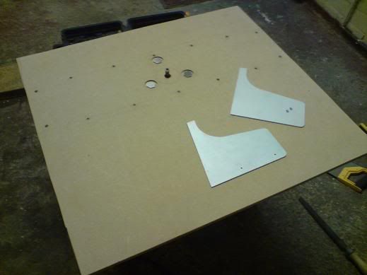

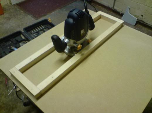

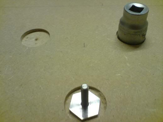

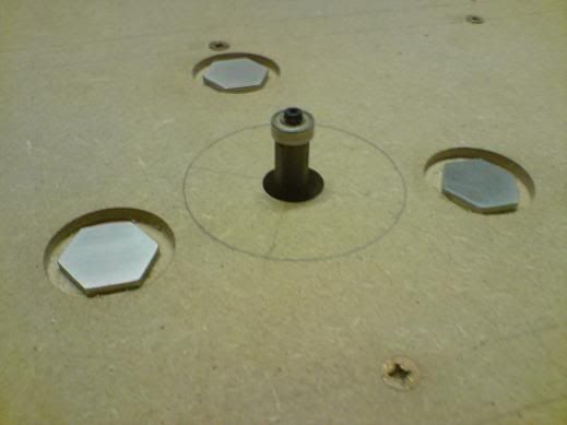

I made myself a router table fixture today to use with the templates I made.
You can commercially buy tables to mount your router to but in the spirit of things I though I would make my own  :)
I'm not saying anyone should build one as they could be potentially dangerous (like any power tool) but this is how I made mine.

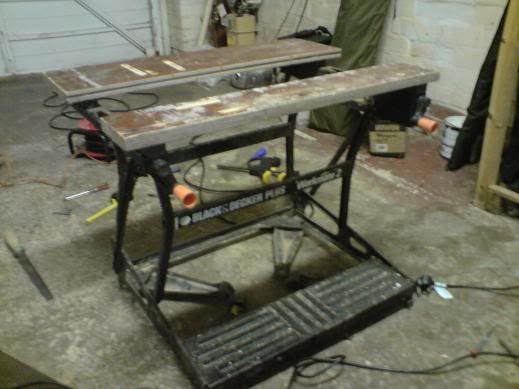

I have an old B&D Workmate which I'm using to hold the fixture:

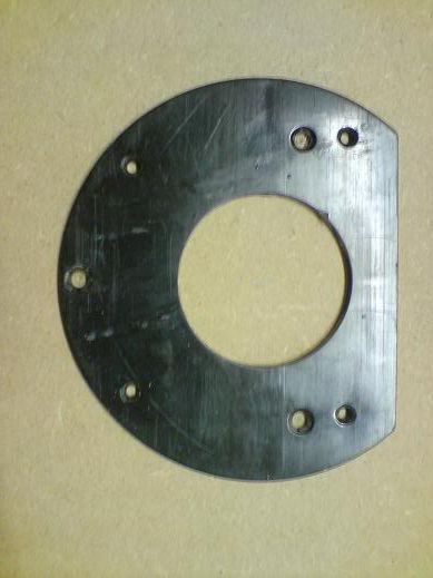

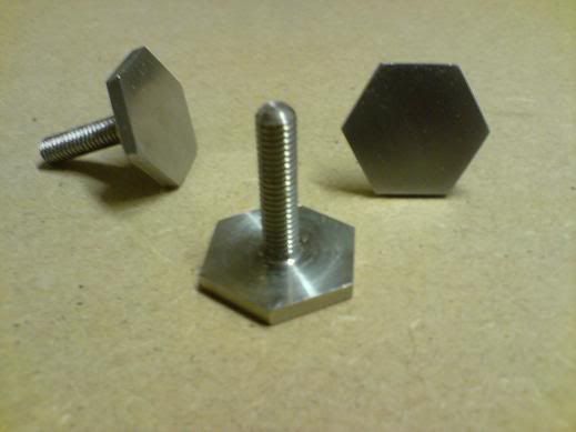

The bottom of my router has three M6 tapped holes so I made some large-head hex bolts to mount the router to the table:
I made the head oversize as the bolt will be taking the weight of the router and the whole thing needs to be really secure as you don't want the router falling/moving at 20,000 odd RPM.
I cut a piece of 12mm MDF to roughly the size of the workbench. The fixture is plenty big enough to route with the templates and should hopefully be big enough for any larger projects I have in the future. I'm using 12mm MDF rather than 18mm as the flush trim bit would not have been long enough to cut the 18mm MDF I will be cutting with the templates.
Luckily, the plastic base of my router was removable so I took it off and marked the mounting hole positions onto the MDF:
I then used a Forstner drill bit to counterbore the holes for the bolts so that they sit just below the level of the table. I also made sure the Forstner bit was large enough so that I could tighten the bolts with a socket.
I then drilled some 8mm holes using the Forster point as a center and then fitted the router to the fixture.
As 12mm MDF is fairly flexible I added a box section on the flip side of the fixture to keep the cutting area nice and flat. I'm also using the box section to clamp onto with the Workmate jaws:
This is the finished fixture:
It seems to have come out quite well and the router is held very securely.
Hopefully I should get the CP ends routed tomorrow night, ill let you know how I get on.

I used the templates tonight and the CP ends have come out brilliantly!
Ive seen the future and its template shaped!  ;D

How'd you do it, Franco?  I'm having a hard time cutting out small pieces with the router and a template.
btw - this project is really shaping up to be one-of-a-kind!  :applaud:
Kaytrim
  • I'm too nice a guy
  • Posts: 2095
Re: Franco's Custom Cocktail (UPDATE: Wood cutting commences!! =) )
« Reply #133 on: March 28, 2008, 07:48:17 pm »
To do the type of template routing that Franco is doing here you can use double sided tape to attach the template to the wood.  Use a flush cut bit with a bearing in the router and ride the bearing along the template.  As long as the template doesn't move each piece will be identical.
TTFN

I had the same problems routing the CP ends before somunny, the pieces were just too small to work with. I didnt really know anything about template routing but I thought it may be the answer so I googled teplate routing and I can up with the following image.
Thats what gave me the idea to make the routing fixture. To hold the templates to the top of the material I screwed the two together. I screwed a piece of the 32mm planed wood (the same material I used to make the box section on the reverse side of the fixture) on top of the template and through into the 18mm MDF to make a bit of a handle to give me something solid to hold onto. In hindsight this probably wasnt necessary as the router cut the material with ease but having never done it before I wanted to make sure I could hold it securely.
I hadnt thought about double sided tape Kaytrim, thats a good idea. As long as you have a large enough surface area in contract that would be the best solution as you would not get the screw holes in your finished material. Im covering my CP ends in carbon fibre so you wont see the holes but ill keep that in mind for future projects, thanks for the tip.
Btw, checked your thread Kaytrim, awesomes  8)

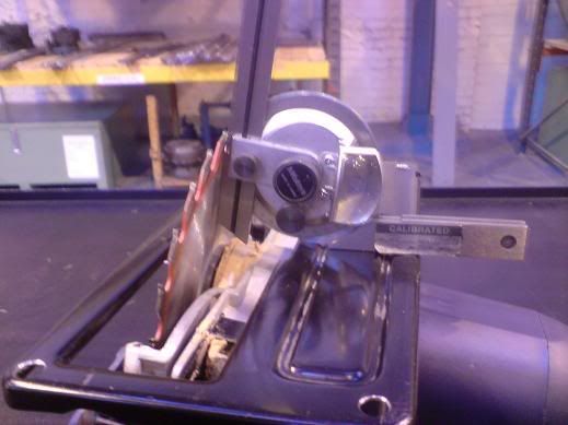

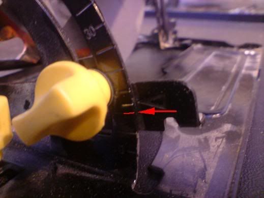

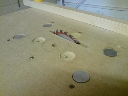

Made a few modifications to my circular saw and the router fixture and it now doubles up as a saw table  :)
I drilled the holes to hold the circular saw to the table at work and whilst I was there I thought I would check the accuracy of the angle 'dial' as I have cut some angles with it before and i wasn't too sure that it was very accurate.
I set a vernier protractor to 10 degrees and set the saw blade to the protractor:
(you can also see the holes I drilled to bolt the circ saw to the fixture)
I then flipped the saw over and I could clearly see that the 'dial' is out by about two degrees over the ten:
The red line is the 10 degree mark. I scribed a line at the correct ten degree position for future cuts. In hindsight I should have marked the correct 10 degree position as I have some 45 cuts to make but ill just have to take it back into work.
I should hopefully be able to get some straight 10 degree cuts now.  :)

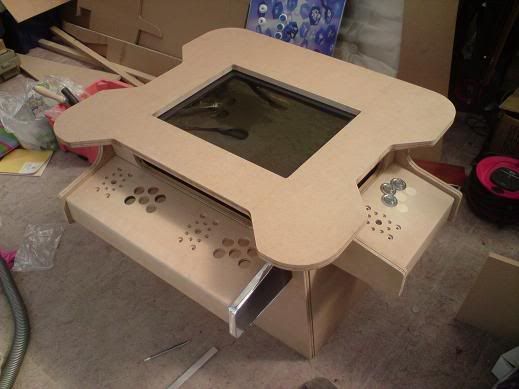

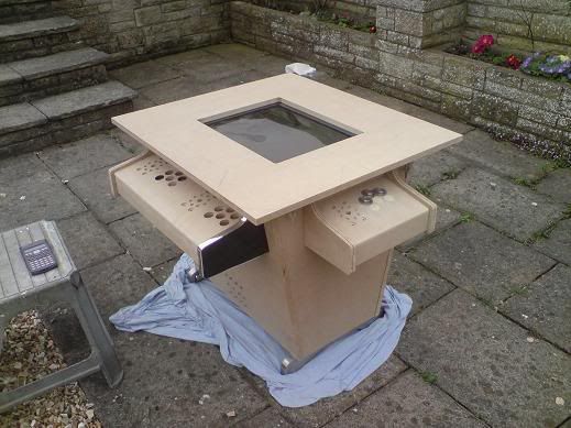

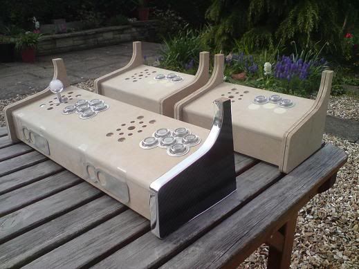

When I was using the router table I made to cut out the CP ends I didn't use a dust vacuum and the amount of dust created combined with the heat of the router being used caused the main bearing to seize. I managed to take the router apart and replace the bearing (this time with a steel enclosure rather than the stock rubber one) and it works as  good as new again :)

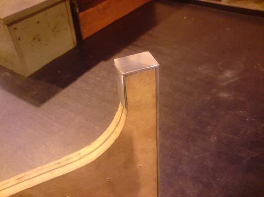

With the router fixed I could cut the slots for the t-moulding in the CP ends. I should have used a/some large bearings to stop the cutter from cutting full depth but they are expensive so I just made some steel spacers. They are not ideal but they did the job.

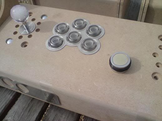

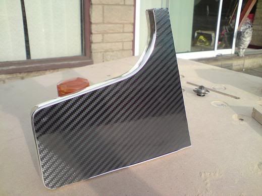

I picked up the vinyl that I am going to cover my cab in today. I bought 5 square meters of matte black, one of royal blue and 2 of carbon fibre effect. I was hoping to use real CF but after pricing it up it would have cost about Ł200. In comparison the CF vinyl was Ł6. The  CF is only for looks so it will serve its purpose in this application.
After slotting the CP ends I couldn't resist adding some chrome t-moulding and CF vinyl to see what it will look like.
Looks pretty  8) to me   :)
I'm just going to cover the CP ends in the CF vinyl as well as a couple of other places on the cab. The rest of the cab will be matte black (inside and out) and the internal beams etc will be covered in the royal blue vinyl.

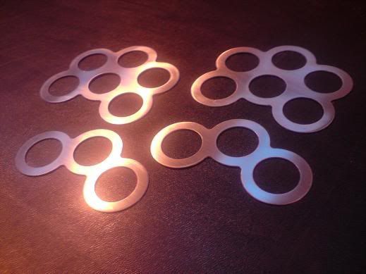

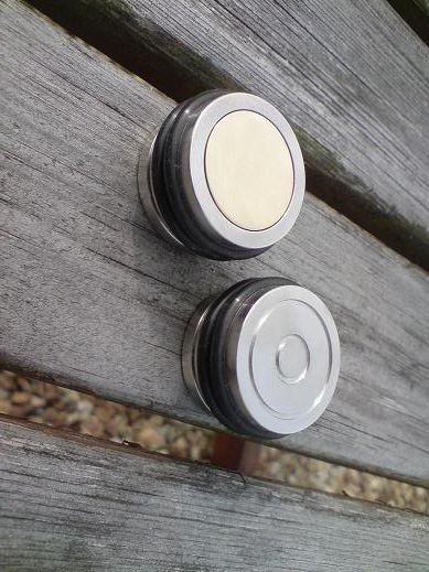

After many hours of polishing I finally finished the button bezels:
It would have been sooo much easier to have used a lazer/watter cutter but I dint have one immediately at my disposal.
Well that's it again for now. Short but sweet I know but I'm planning (once again) on making plenty of progress this week. We have been forecast some awesome weather over the next week and I have also cleared some space in the garage for me to work if the weather turns bad.

Franco, that CF and chrome T-molding look fantastic together!

Wow!  That cp end looks amazing!  :applaud:  Nice work as always.

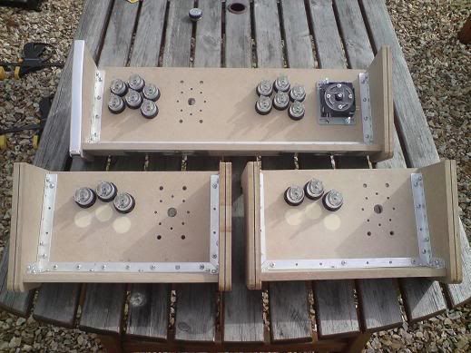

Ive managed to get the major CP contruction complete:
This has been a bit of a bottle neck in my project as I couldn't continue with various aspects until they were semi complete. Now that they are 'finished' I can now:
a) Get my table top cut out ( i didn't want to cut the profile in case anything changed in regards to the CP sizes)
b) Get the plexi cut to size for the bottom of the CPs (see above)
c) Get the CP graphics designed (ditto)
That's the next plan of action until I have completed those steps.

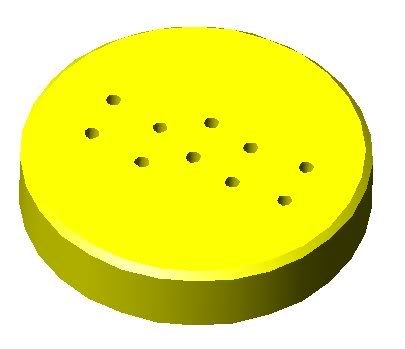

I have decided to add a spinner to my CP. I have made a couple of spinners but I'm not sure which design to use. These are the two candidates:
These are two pictures of the rough spinner location (at this moment in time). Which do you think would look better?
The grooved one would match my dustwashers but I really like the one with the brass insert. I'm thinking of maybe making a brushed stainless insert and getting it engraved with a spacie to match the general theme of my cab. I may even get a brass insert engraved instead as I really like the look of the brass in contrast to the stainless.
I'm really getting exited now I'm at this stage now I'm past the current bottleneck. Time for a shandy or two methinks ;)

I like the brass version best too. Both are very nice.
Franco B
  • Posts: 3766
« Reply #147 on: April 27, 2008, 08:18:16 am »
Thanks guys.
Yeah I'm leaning towards the brass one, I think I'm going to go with that.

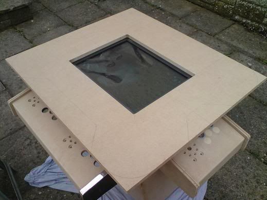

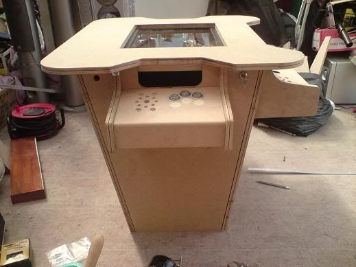

Well after yesterdays progress I was keen to get on with it today so I had a 6.30 am start. I tried to be quiet until about 9 before I got cracking with the power tools
The first thing I did was to get the CPs mounted to the cab. I have just screwed them from the inside at present but I'm going to make some brackets to hold them to the cab this week.
I also got the cabinet top cut out somewhere near size and I jigsawed the bulk of the material out before finishing it with my router.
You can just about see the top profile penciled on in the next picture. I may reduce the whole CP top slightly but I'm definitely going to trim some material off the back edge to reduce its size. I don't want to take too much off all around though as I want to keep a fair amount of area for the CP graphics and LED lit perspex inserts.
I haven't cut the table top profile as I'm going to make some templates at work for the large radii on the corners and also for the recess profiles as well as a template for the cutout so I can mount the tinted blue vinyl covered plexi with spacie cutouts behind the CPs. Its hard to explain but you will see soon enough.
You can also see that I have cut the monitor opening over size. I'm going to make a solid aluminium 45 degree bezel for the monitor. If it end up being too bright ill just cover it in black vinyl. Hopefully it should look nice under tinted glass.
All in all I'm happy for four hours work. I'm really happy with how its looking and I had a quick mock play on the cabinet to test the CP heights and viewing angle etc and I must say its come out exactly as planned in those respects. Its nice that things are going right for once :)

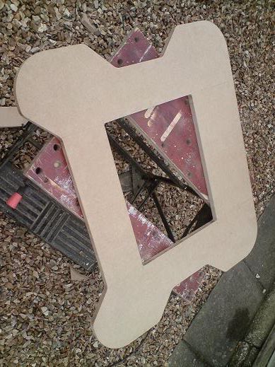

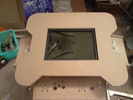

Had another 6.30am start today  :)
Ive been getting on all morning. Im quite impressed myself seeing as I have GTA4 sat there and ive only had a couple of hours on it. Im really getting the build bug now im making some decent progess.
I made the three templates for the table top profile. One with a 100mm radius, one with the CP cut out profile and one with a 25mm radius for another part of the cab.
Quick pic of the templates in posistion. I jigsawed the bulk of the material out before using a flush trim bit to follow the shape of the templates.
Which left me with the semi finished table top.
I may trim a piece of the far side of the table top. It looks a little large to me and all it is doing is hanging over the backside of the table so its not serving a purpose. I think I may trim about 40mm off.
I also made some other progress but ill include that in the next update.

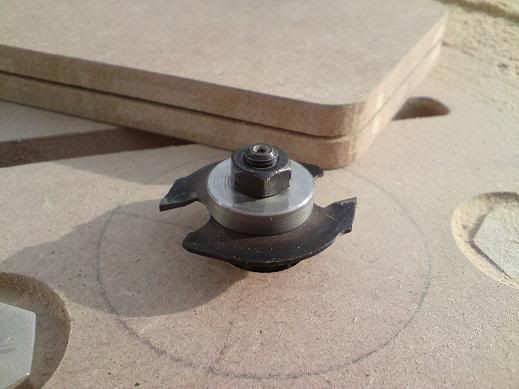

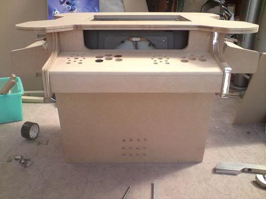

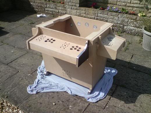

Well, its been another 6.30am start but Ive manged to get plenty done:
  • Disassembled the whole cab
  • Routed the 'straight' sides to length
  • Routed the 'triangular' ends to length for aluminum trim (more on that later)
  • Template routed the cutouts above the CPs
  • Cut the slots for the t-moulding in the 'straight' sides, CP cutouts and table top
  • Reassembled everything
Couple of pics:
(the second pic looks a bit wonky for some reason, i swear its all straight!  :P)
Really happy with how its looking :)
Im planning on having the admin buttons in the vertical sections either side of the long hoizontal CP. I have very kindly been traded some awesome kit for them but I wont post anything on them until they have been revealed by the originator.
The eagled eyed amongst you may have noticed a slight gap between the side panels and the front/back panels on the third photo. This is because I'm going to trim those sides with 1.5mm aluminum strip. I don't want to have any wooded edges showing, even when the cab is opened (top up, sides down). I'm trimming the CP tops and back edges with aluminum too, similar to this picture:
That's it for today again, I have the whole day off tomorrow so i should be able to get plenty more done. I think I'm going to run out of things to do tho before I get some artwork etc sorted out, I think I had better make that my next priority. I know what I want for it, I just need to find someone with better skills than my paint skills to work on it for me   :)
Wait, you MADE those?
Holy crap, they look perfect for the sharp-angled cocktail I'm planning, can you make me 8 of those with a thin head? :D
Thanks for the tip on the workbench/router table, I have a workbench just like that... I'm going to go and have a closer read :)
Edit: On second thoughts, seeing the progress of your cocktail I think I'll just give up now!   :-\
« Last Edit: May 11, 2008, 06:49:39 am by dmworking247 »
Franco B
  • Posts: 3766
« Reply #159 on: May 12, 2008, 03:36:41 am »
Sure, I can make you some.
There just some 24mm AF (across flats) s/steel hex bar turned and screwcut.
I think thats the only hex stainless bar we have but we do have some other sizes of mild steel hex bar.
Shoot me a PM of what sizes you need (Hex size, head width, screw form/pitch and thread length) and Ill see what I can do.  ;)
