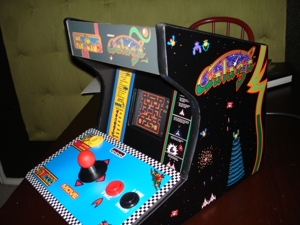

Here is a 95% done shot:
More pics on page 2 at the end...

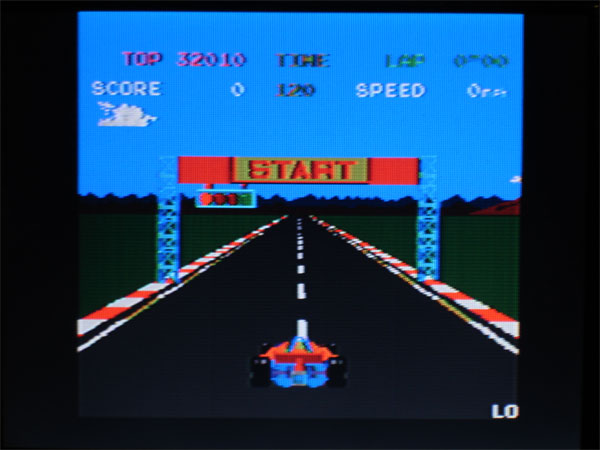

Pole Positon:

« Reply #28 on: August 01, 2007, 11:50:02 pm »
Here are some shots of the Sides, Partial Bezel, CPO, Marquee:
Thoughts?  I would love opinions, good or bad.  The Galaga bezel side has been tough as there arn't any good Galaga Instruction Cards out on the web.  Does anyone have a 300 dpi version of the galaga instruction card?

« Reply #37 on: August 04, 2007, 12:22:44 pm »
Here is my Galaga side of the Bezel.  A lot of it is best guess and kind of my own creation to match the Ms. Pacman side...
Thanks for all the positive comments, it really drives me to work on this!
